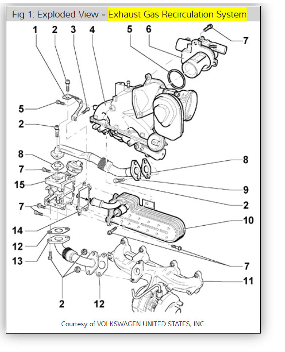

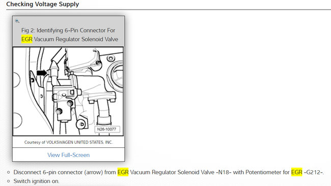

It sounds like the EGR system is open at idle or you have a compression issue. Lets start by checking the EGR here is a video to help with diagrams below for your car:
https://youtu.be/DqUCbbKdWf4
Next lets do a compression test.
Please run down these guides and report back. Check out the diagrams (below). Please let us know what you find. We are interested to see what it is.

Hi Ken. So i replaced the high pressure fuel pump, the EGR valve and i even bought new spark plugs but the random misfire continues. The fuel fuel consumption is now dreadful. So now i am going to get the compression tester this week and check the compression for all cylinders.

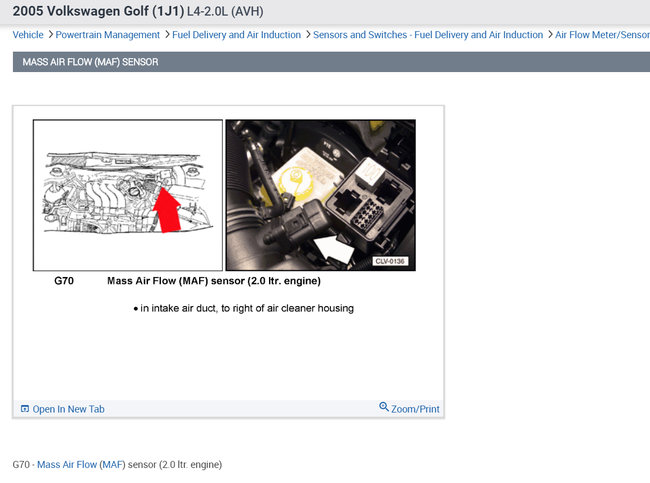

This sounds like the MAF sensor needs replacement which is a normal service item. When these sensors start going bad they don't give a check engine light. Check out the diagrams (below). Please let us know what you find.

Hi Ken. Finally i managed to get rid of all the random misfire. It was the injectors that had gone bad they were leaking, so i replaced all 4 of them. Now its driving like a new car. Thank you so much for the help.
