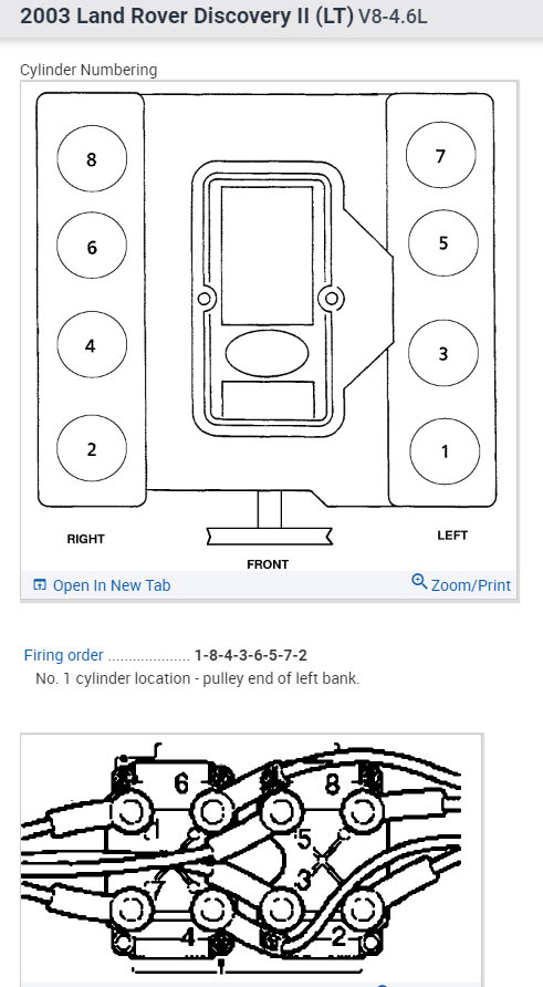

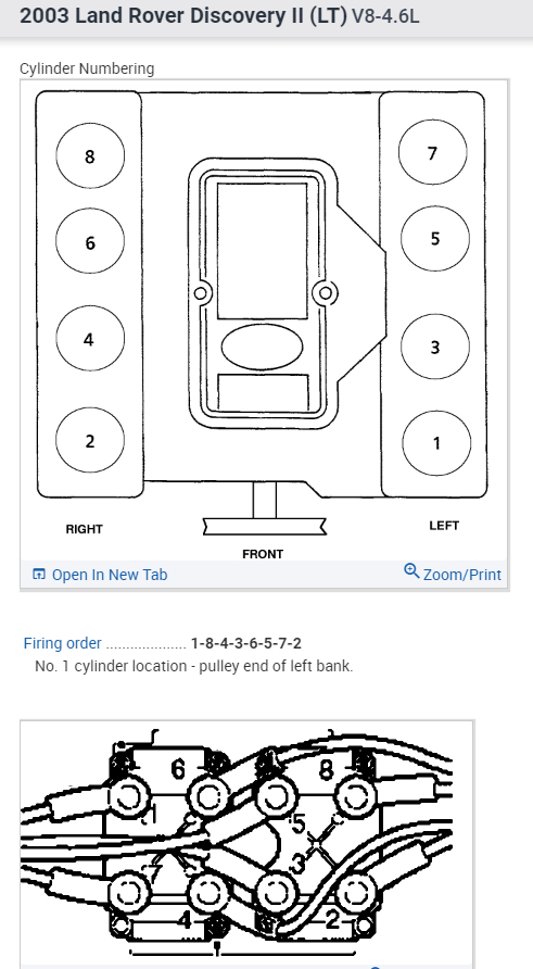

We changed the injectors, fuel pump, spark plugs and high-tension cables, still it's misfiring. kindly asking for the coil pack firing order.
Apr 14, 2022 at 7:17 PM
SQM
  • 6,383 POSTS
I have attached the coil pack firing order along with the cylinder locations.
Apr 15, 2022 at 1:03 AM
EMMANUELNGANDU
  • 29 POSTS

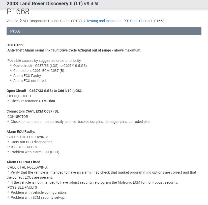

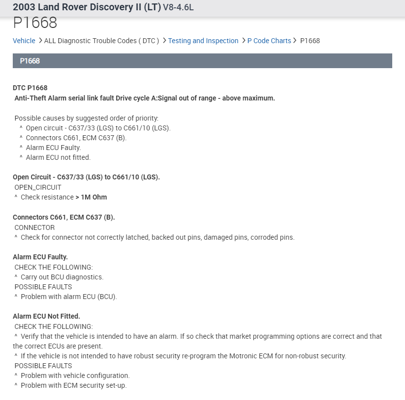

Thanks, I followed the firing order you gave me it performed better than before, now it's showing a p1668 code.
Apr 16, 2022 at 7:14 AM
SQM
  • 6,383 POSTS
The P1668 is an anti theft code, typically gets triggered due to an issue with the alarm.
I have attached some helpful info on the code below for your reference.
Apr 16, 2022 at 3:50 PM
