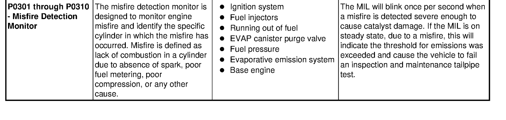

Okay, so you were able to pull DTC P0304. In the diagrams down below I have included the factory diagnostic troubleshooting guide for DTC P0304 for your vehicle. I would start by checking my Coil on Plug (COP), associated connector and wiring going to the connector, and my spark plug for cylinder #4.( Please go through this guide and get back to us with what you are able to find out.

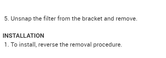

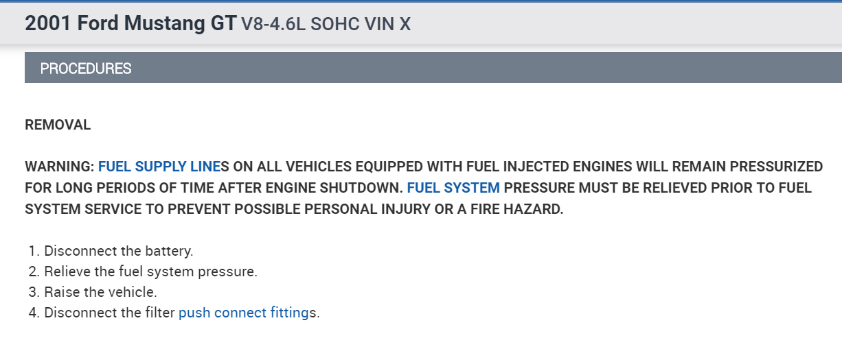

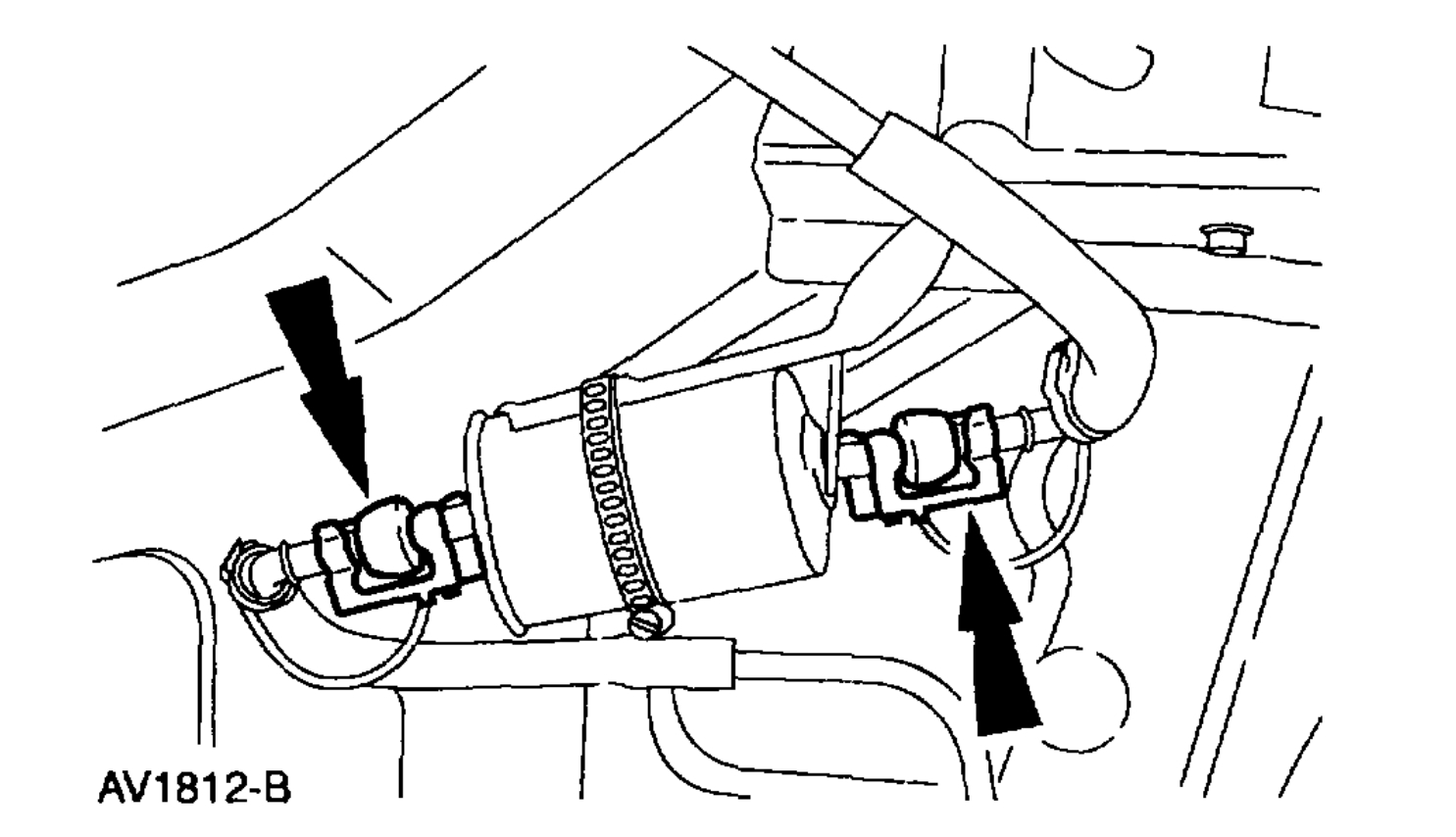

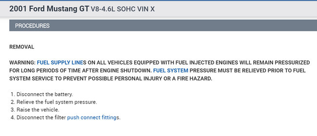

If you are suspecting that it is fuel related because it is only misfiring when there is a load put on the engine, than I would suggest starting by replacing your vehicle's fuel filter. I have included directions for how to do this in the diagrams down below. You will need to get a set of Ford fuel and air conditioning line dis-connectors at an auto parts store to do this. They are relatively inexpensive, around $10.00, but absolutely needed for the job.Also, if you do decide to get new fuel injectors, I would highly recommend that you stick with Original Equipment Manufacturer quality injectors or higher. This is where you do not want to skimp and get the cheap or cheaper injectors on Ebay. They absolutely do not perform as advertised and you may wind up doing serious damage to engine as a result. Go with Bosch, Sieman Deka, Denso, Ford Racing, etc.. Please get back to us with what you are able to find out.
