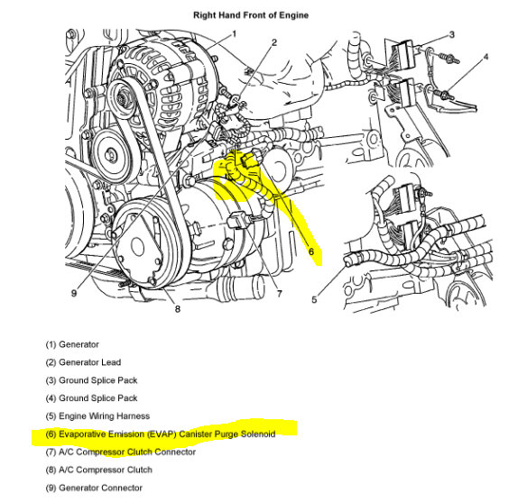

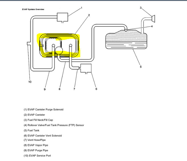

Recently changed fuel pump. Drove fine then I got a p0455 for small emission leak. A couple of days went by then got a p0456 Evap vent. I am now getting random misfire in cylinders 3, 4, and 5. Got new double iridium plugs and new wires. Any ideas? I do have a Launch Creader VII+ code scanner.
Jan 5, 2023 at 11:38 PM
  • 110,240 POSTS
For some reason, both of the codes you supplied are not listed for this vehicle. I know a P0455 is a "gross EVAP leak. These are usually easy to find. If the fuel cap is off, the evap canister is damaged or disconnected, or there are hoses disconnected or broken between the fuel tank and the charcoal canister.
Now, the P0456 is identified as a "Very Small EVAP leak." If we have a large leak, I'm not sure why it is showing a small leak too. Are you sure the codes you indicated are correct?
As far as the misfire, chances are you are drawing fresh air into the combustion chamber causing a very leak fuel mixture. Does your scan tool provide live data? If it does, can you tell me what the short-term fuel trims are at operating temperature?
Next, inspect the charcoal canister and hoses to it. It is located near the fuel tank. See pic below.
Let me know what you find.
See pic below.

I may not have listed the codes correctly. I do know the first code was for a small leak. The second code was for evap vent valve. When I go into diagnostics it says excessive vacuum. I have to drive 40 miles to work so I will list the short- and long-term fuel specs in an hour or so.

  • 110,240 POSTS
Okay, it makes sense with those codes. The LTFT are indicating the comp is trying to compensate the air/fuel mixture by adding more fuel. You really don't want that number to be above 10%.
I have a feeling there is a leak at the EVAP vapor canister purge solenoid. That is where I would start.
If you look below, I attached a pic to help locate the part. Confirm the vacuum hoses are connected, not leaking, and not dry rotted.
See pic below.
