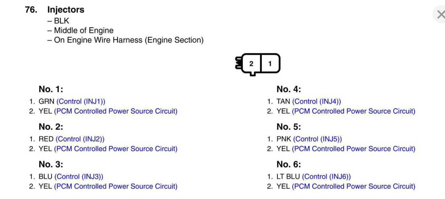

Same cylinder number 6, changed coil and plug still flashing check engine light. Doesn't always do it but it's there. Is there a way to check the injector without removing the intake?

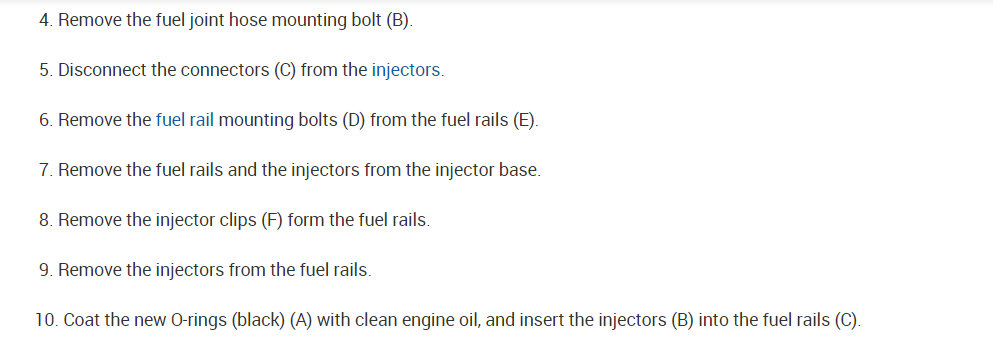

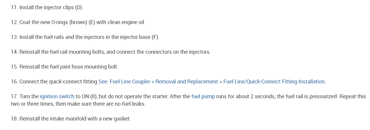

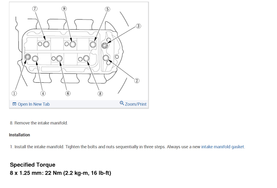

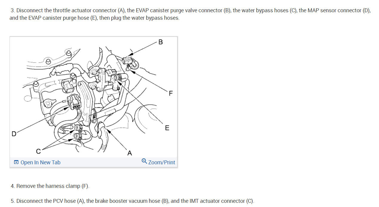

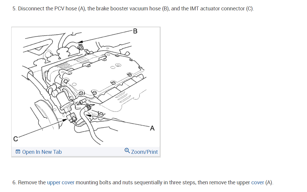

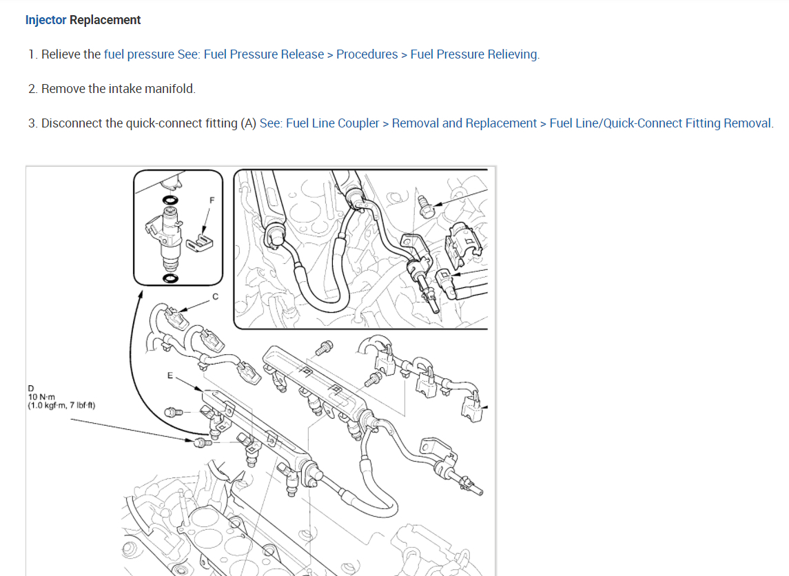

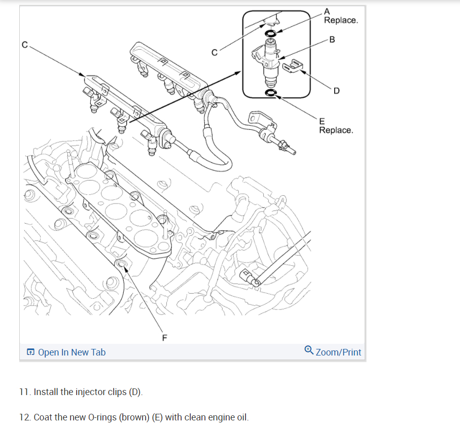

Good afternoon,

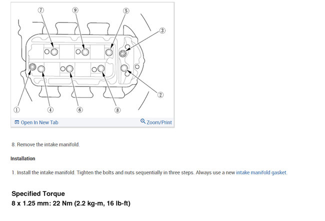

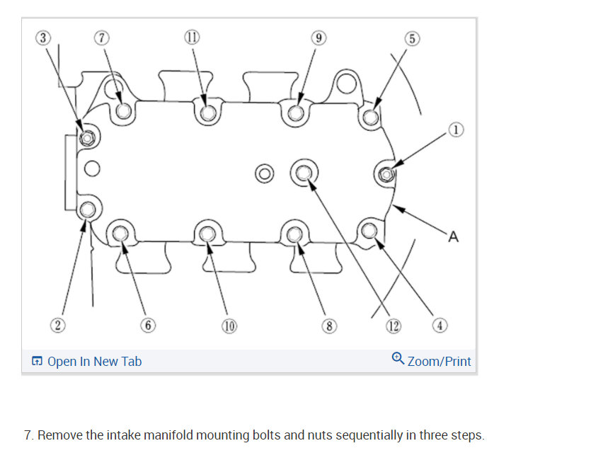

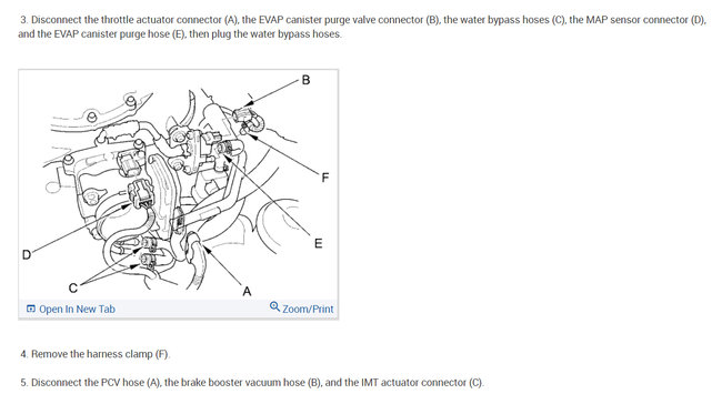

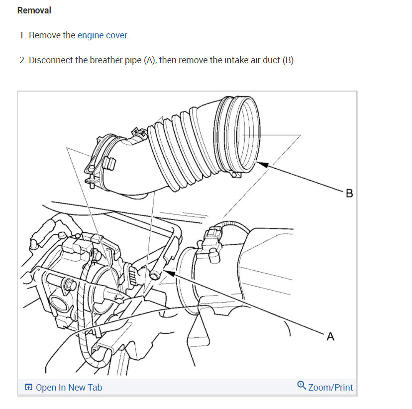

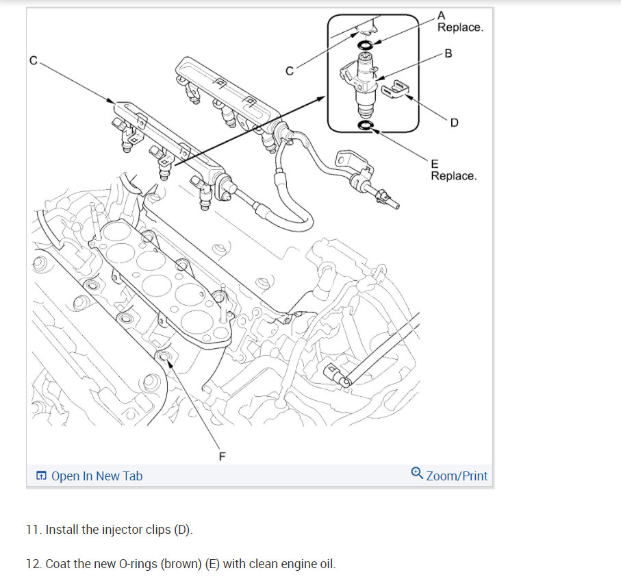

I attached the procedure for removing the intake manifold and the injectors.
https://www.2carpros.com/articles/how-to-replace-a-fuel-injector
https://www.2carpros.com/articles/how-to-test-a-fuel-injector
https://www.2carpros.com/articles/replace-intake-manifold-gasket
I would also do a compression test for that cylinder as well to be sure there is nothing wrong with the engine internally.

Yes, i know how to remove all of that. what i was asking is whether there is a way to test for a bad injector instead of just removing it and getting another one?

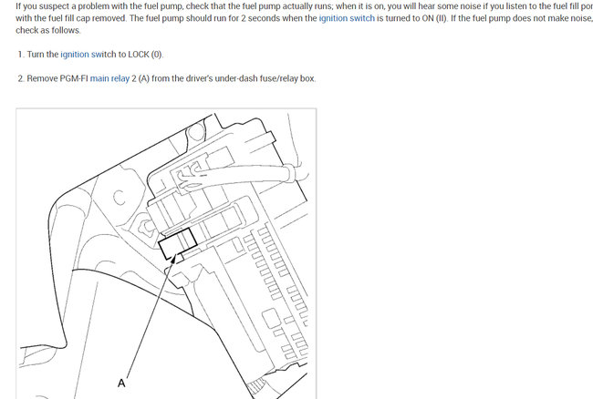

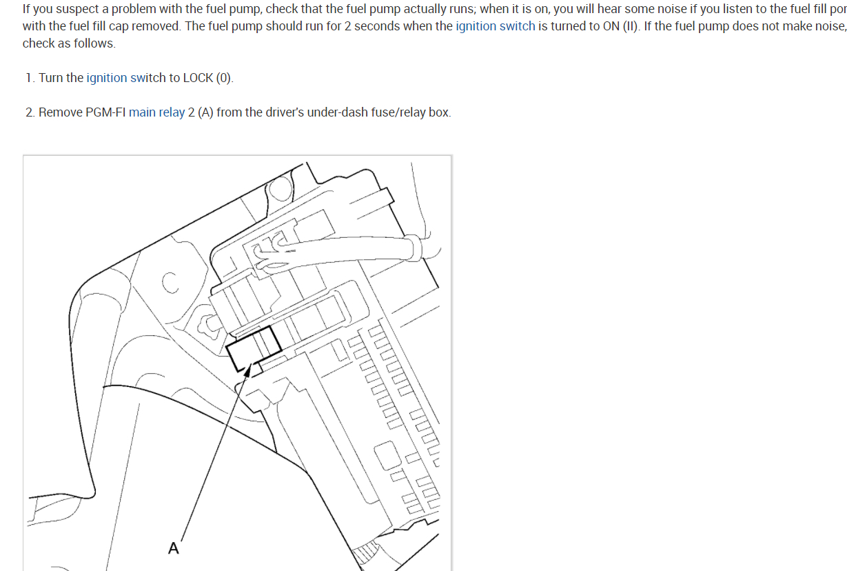

Where is the fuel relay or fuse to remove it before i do a compression test?
Apr 16, 2021 at 3:19 PM
No, there is not. You need to test it right at the injector.
I attached a picture of the relay for you to remove.
