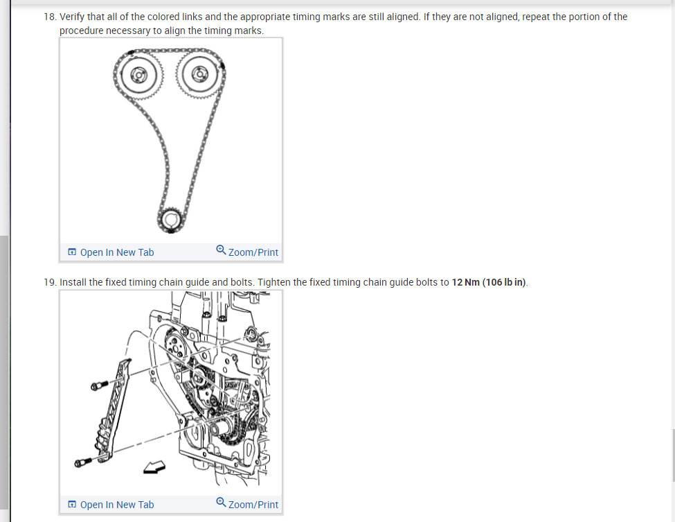

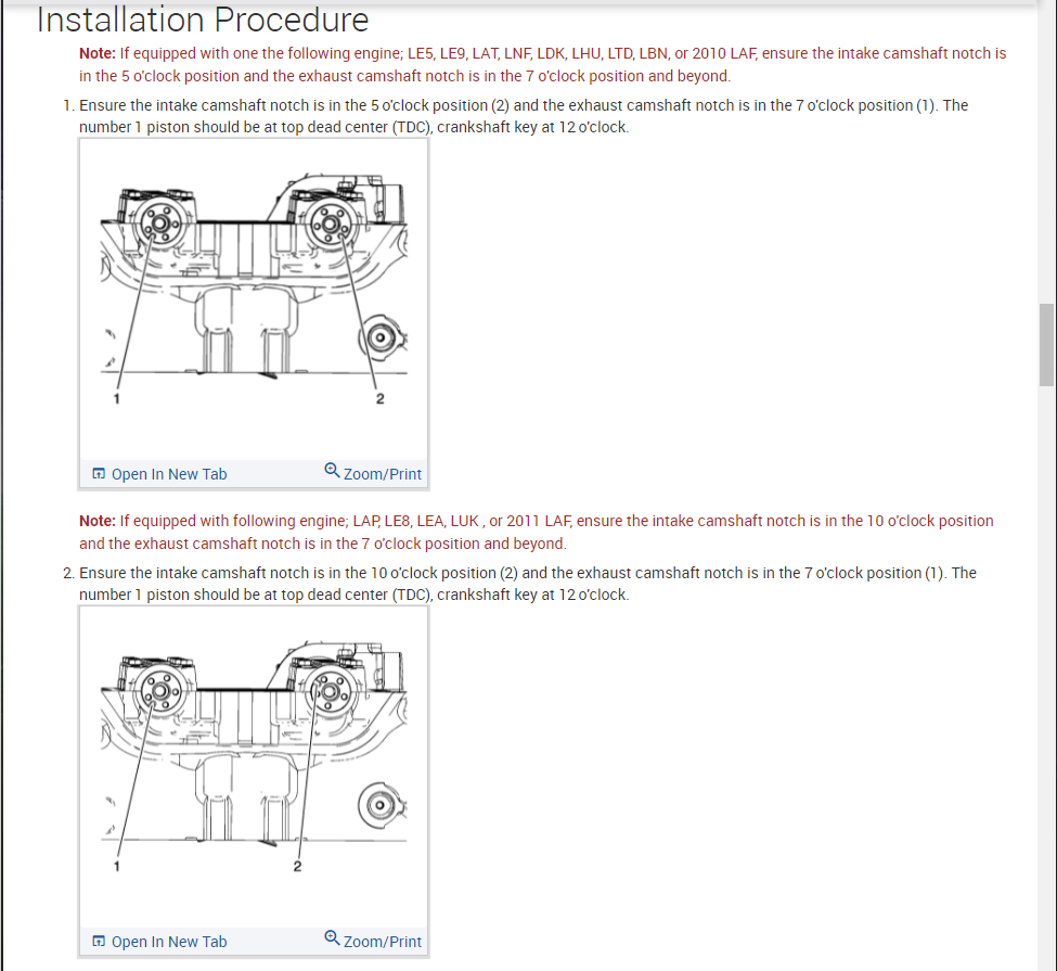

the idler pulleys came loose because of mechanic bad workmanship. Replaced everything Idlers new bolts everywhere. Replaced cam belt tensioner and cam belt , lined up all timing marks on bottom of crank and at the top of the camshaft pulleys. Car starts but backfires when pedal depressed to ref when hot engine sounds okay on revs but rough idle.
Jun 26, 2021 at 9:36 AM

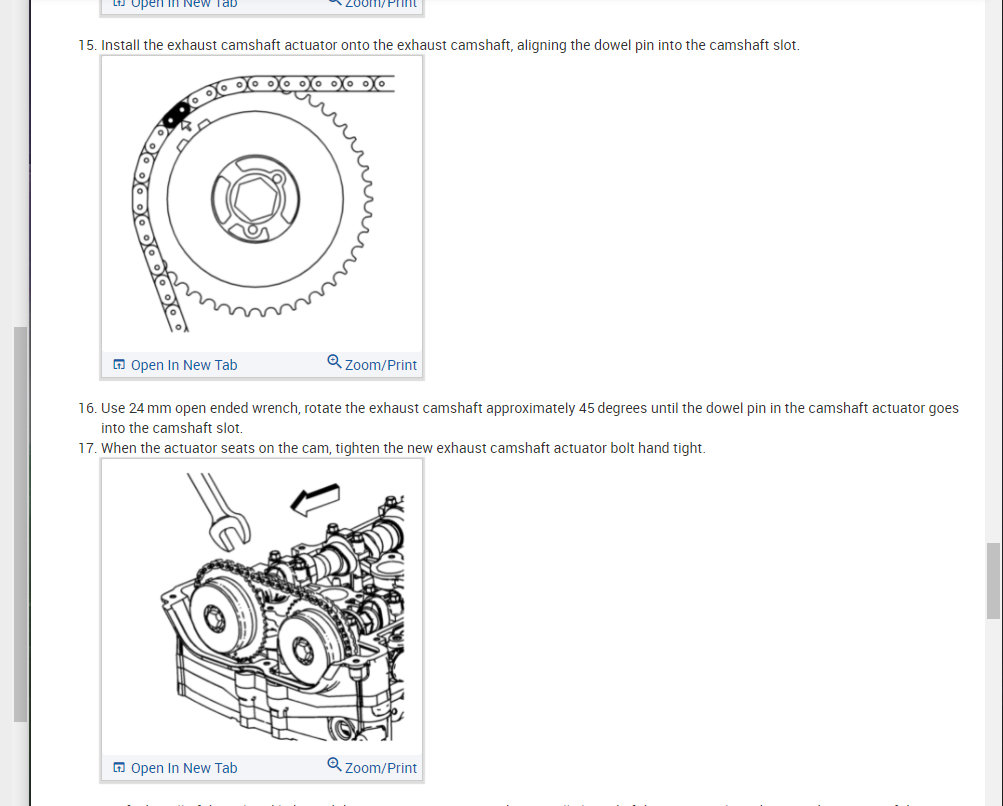

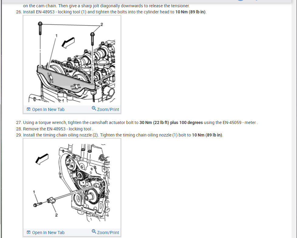

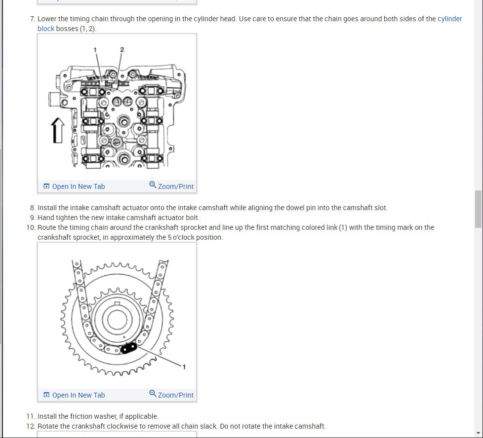

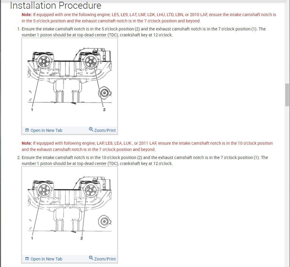

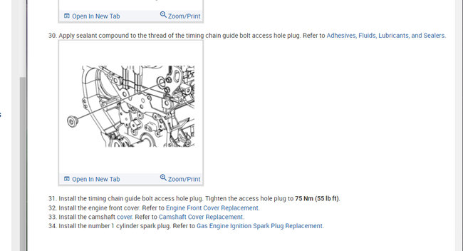

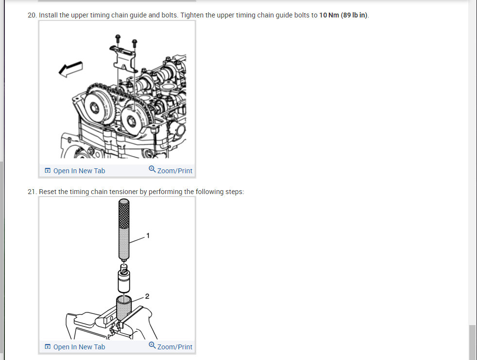

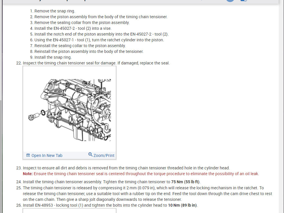

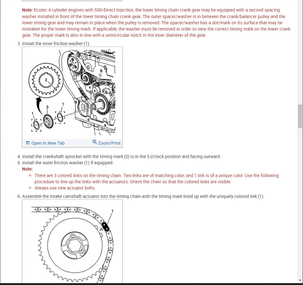

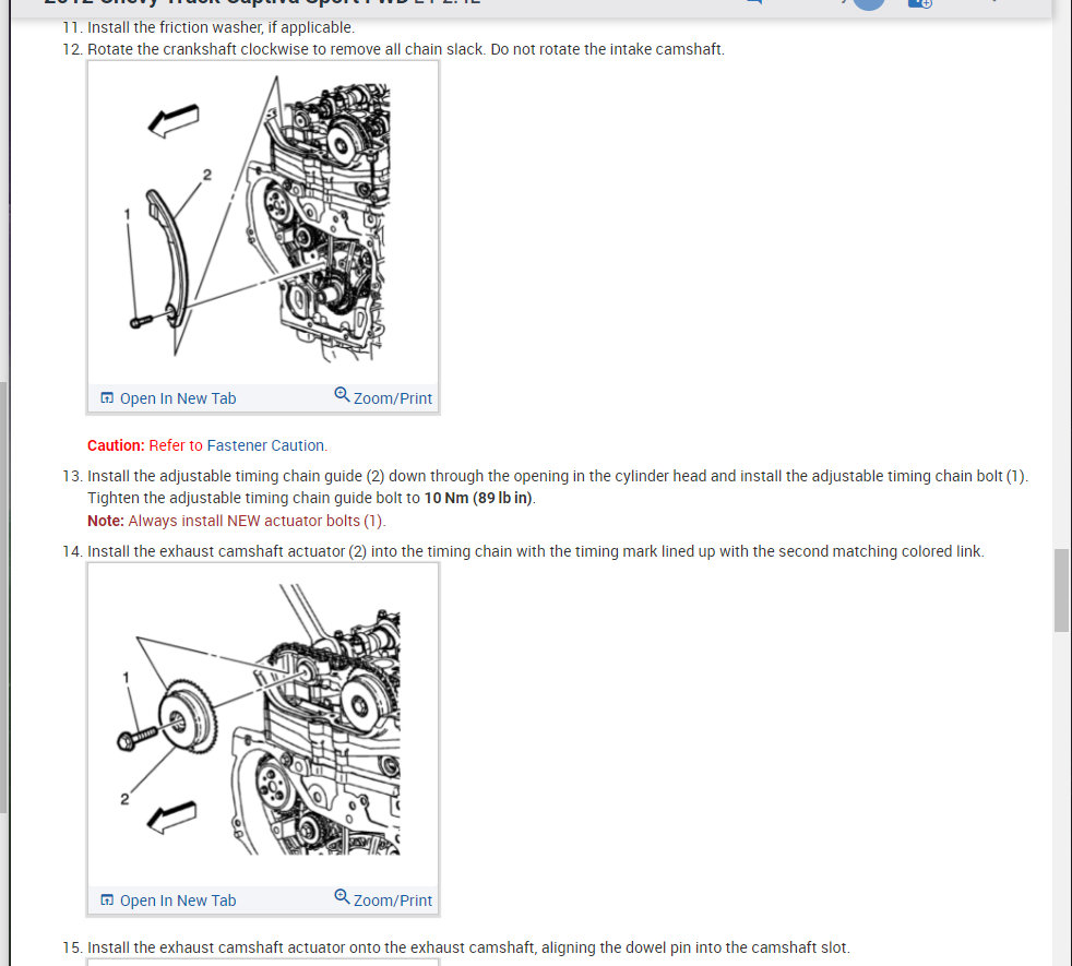

Based on what happened, I suspect the issue is with the timing. Even though you lined up the marks, they have to be in a specific location in order to be timed properly.
However, here are some other things this could be that you need to be aware of so let's review these:
https://www.2carpros.com/articles/engine-backfires-while-running
However the process is below for setting up the timing so I think we need to review this and then inspect the timing again just to make sure it is installed correctly.
Please let me know if you have questions. Thanks

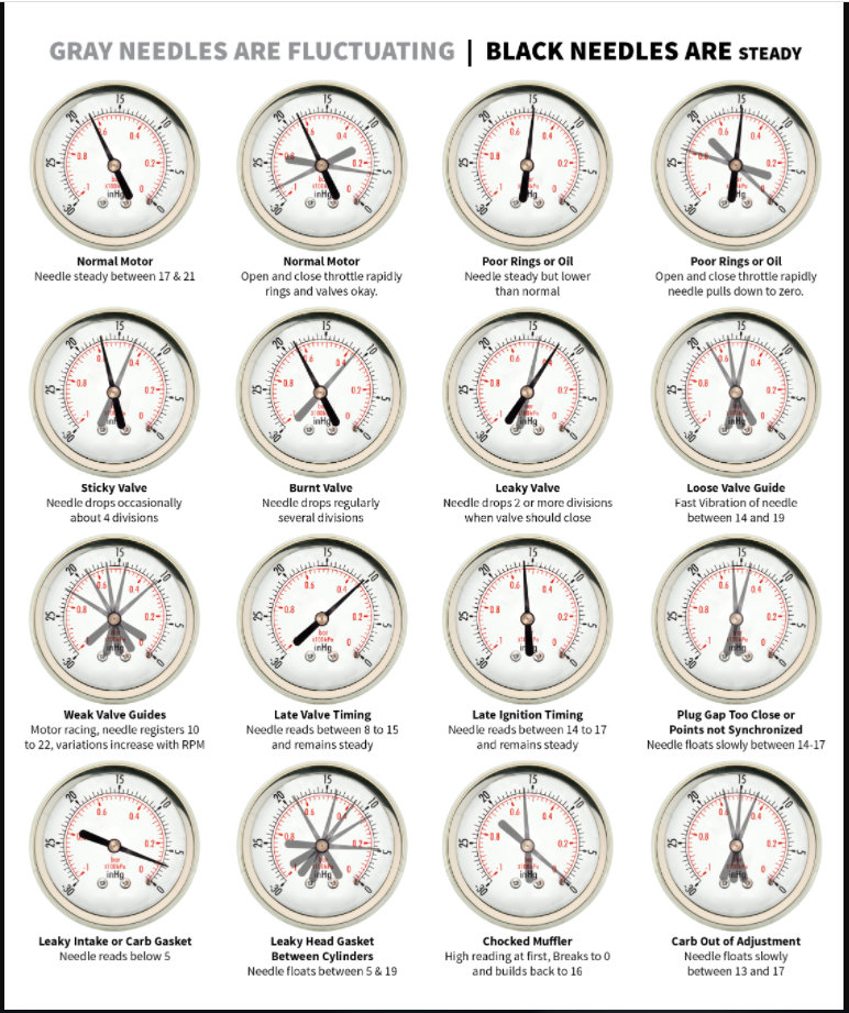

Let's do two things. First we need to do a compression check.
Next we need to hook up a vacuum gauge and see what the gauge is doing when you are idling the engine. See the chart below for possible issues.
Thanks
