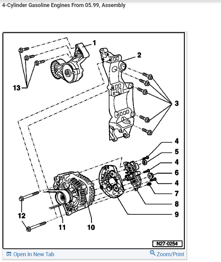

It sounds like the alternator has a diode going out which will allow the alternator to charge the electrical system with AC voltage which can cause the random misfire problems. Here is a guide to help you see if in fact there is AC voltage present (there should be 0 AC voltage when charging).
Here is how to change out the alternator in case you need it. Check out the images (below). Please let us know what happens.
