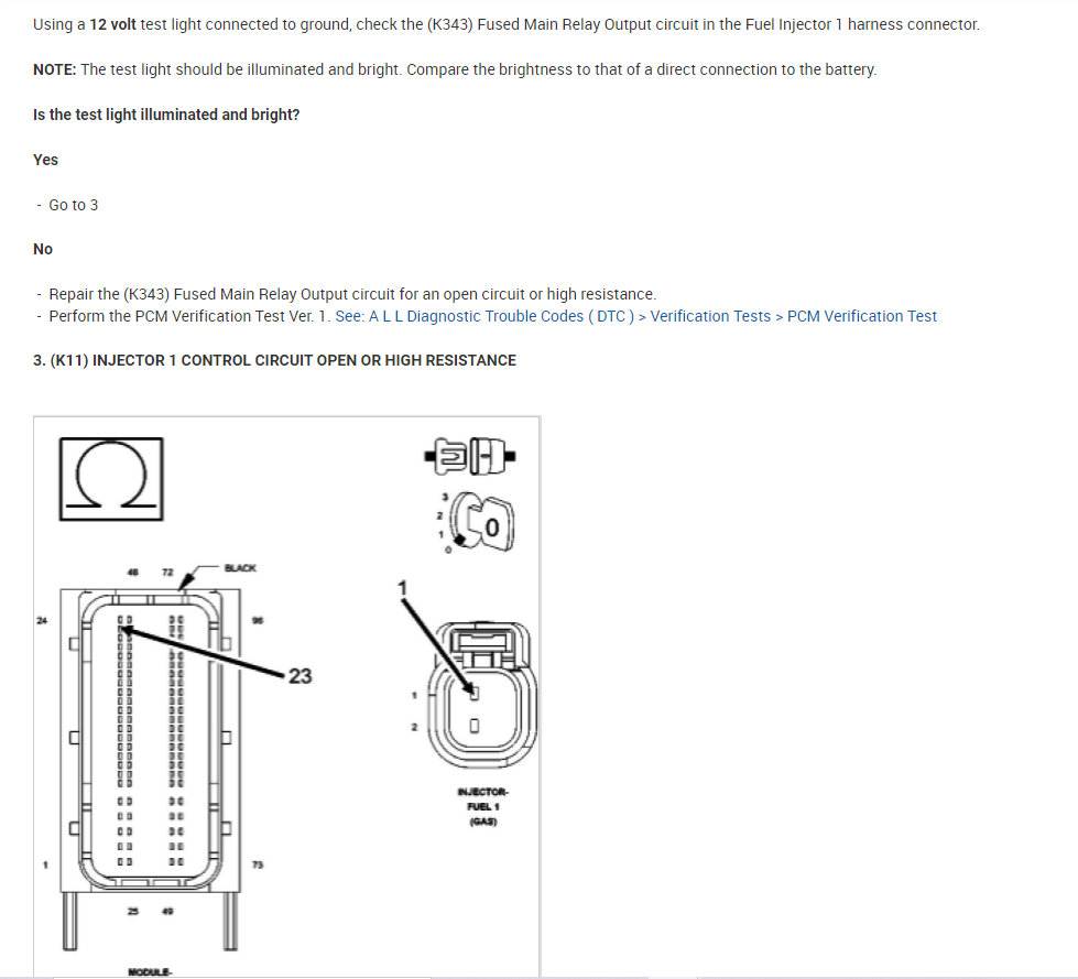

Starting car today it made a popping noise. On second attempt it started but runs rough and makes a hissing noise like air is escaping from somewhere. There's two lightning bolts flashing from my dash and the car seems to be in limp mode. Recently replaced coils and all fuel injectors. Because I was getting a number one cylinder misfire. It's showing 3 codes after this episode today. P0300,
P0171, and P0128.The last code refers to a thermostat issue.
Which I removed 6 months ago.

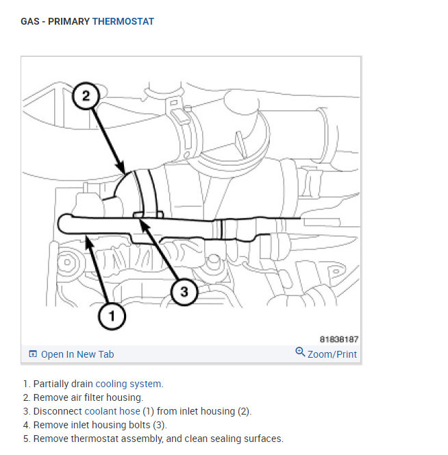

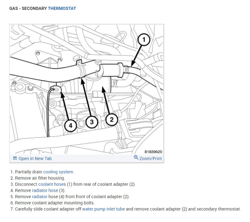

First, if you removed the thermostat and drove for 6 months, there is a very good chance you have damaged the motor. The thermostat must be there for circulation to work correctly. Without it in the motor, only a portion of the block is getting the correct cooling.
This system has 2 thermostats and they both must be there and functioning.

I already have one. All cylinders are fine with no leak down apparently. I will take the thermostat housing back off and replace both therms. If I can find the other one. Where is the second located? In the link it appears to be around power steering pump I think.
Jul 23, 2021 at 7:28 AM
What was the compression?
I would change the plugs while you have them out.
https://www.2carpros.com/articles/how-to-change-spark-plugs
I attached the location in a previous post.

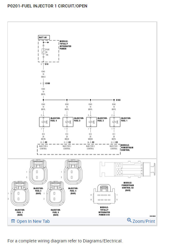

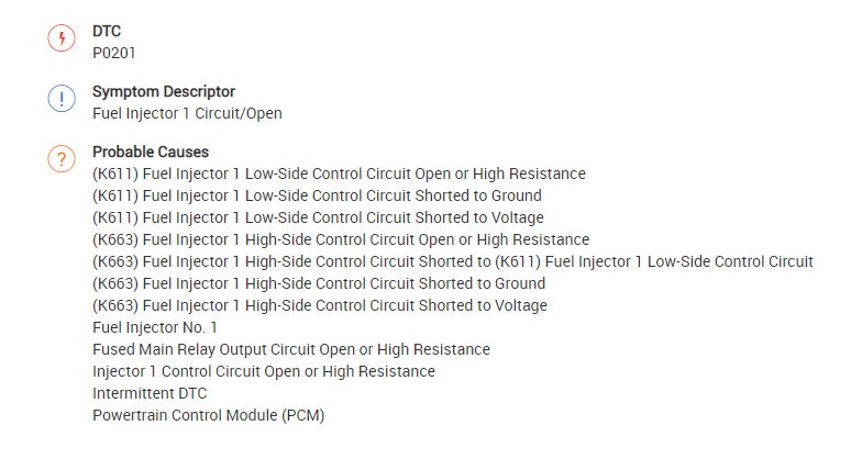

P2004/U0101/ po123/ PO 463/UO141/PO113/P2017/PO480/ PO481/P2311/UO402/PO203/PO202/PO201/U110C
Jul 24, 2021 at 5:37 AM

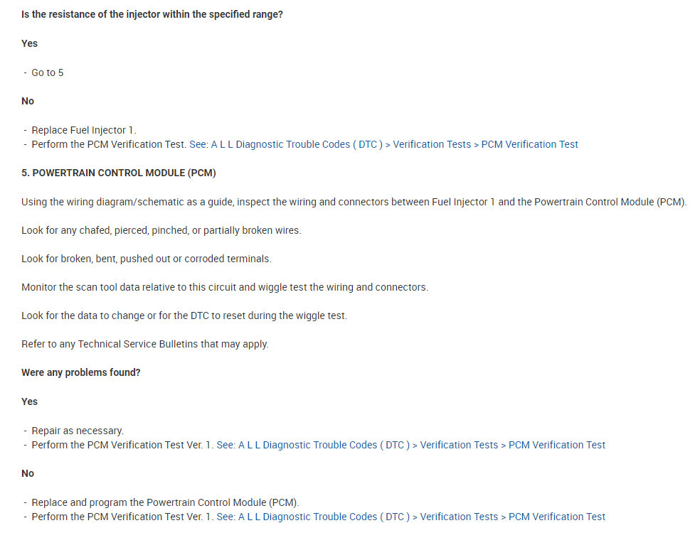

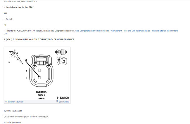

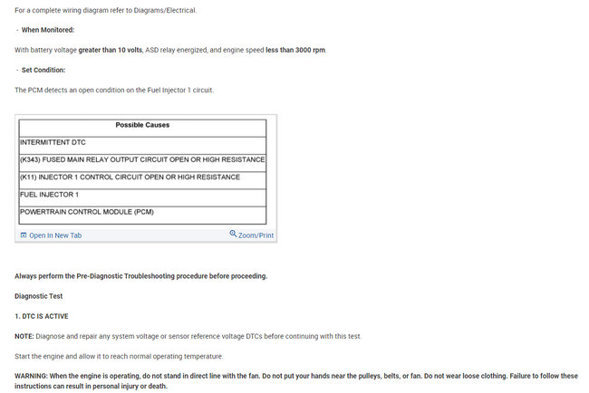

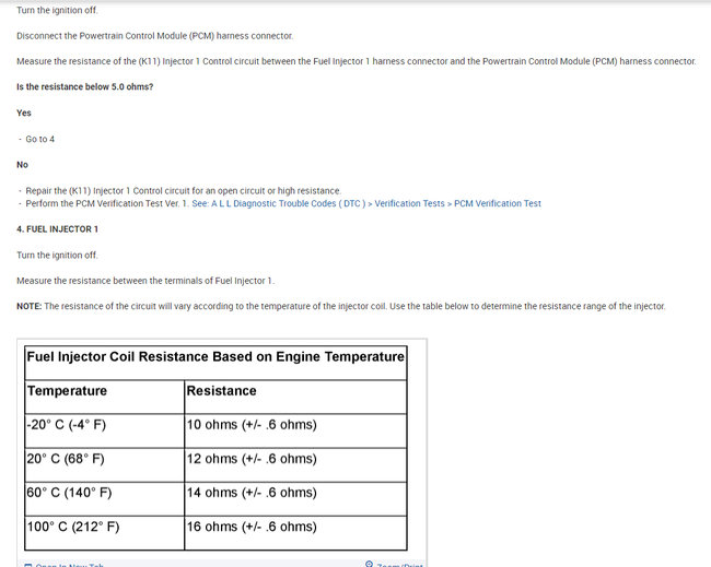

Okay, the key here is the 200 codes for the injectors. Once they are repaired, the other codes most likely will go inactive for the engine controls.
I attached the flow chart for the injectors. Follow the chart and keep me updated on the results.
https://www.2carpros.com/articles/how-to-test-a-fuel-injector
