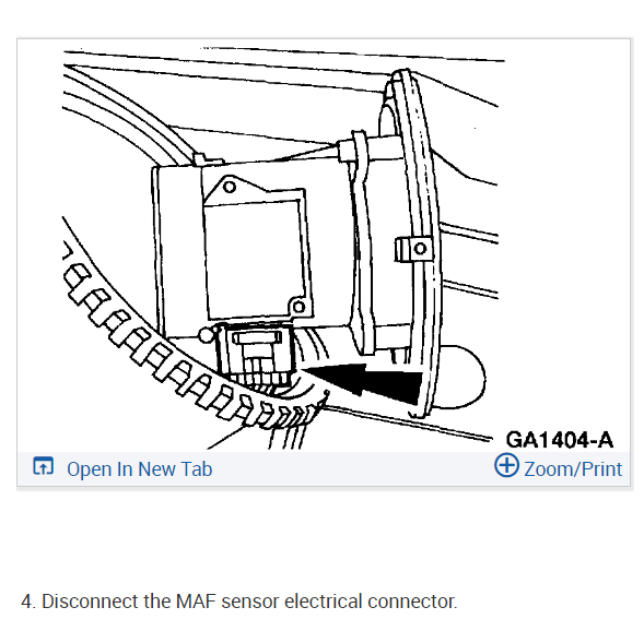

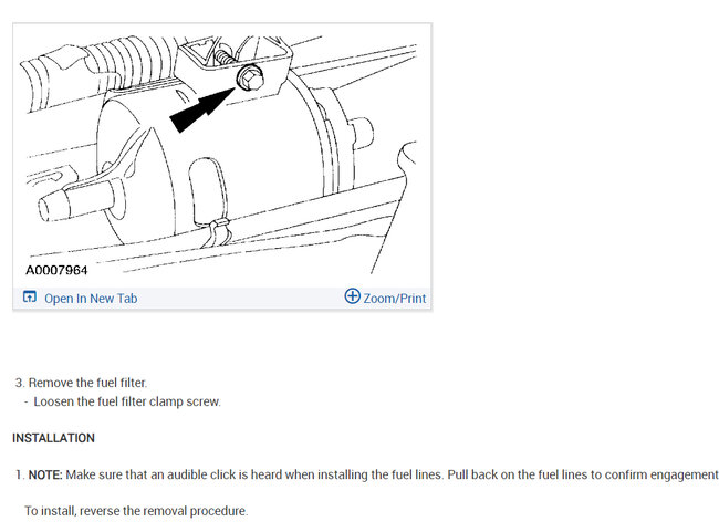

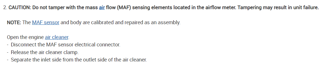

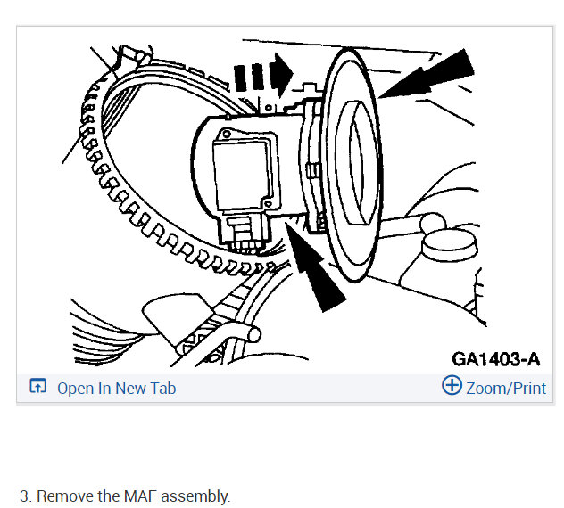

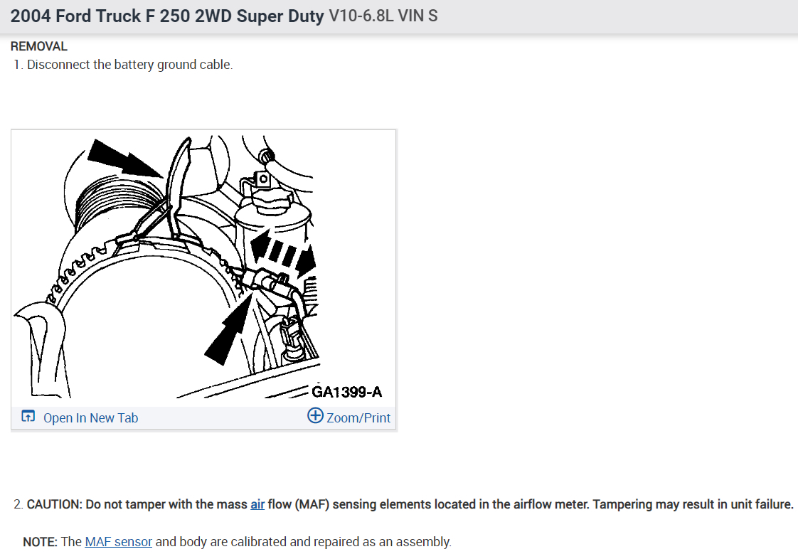

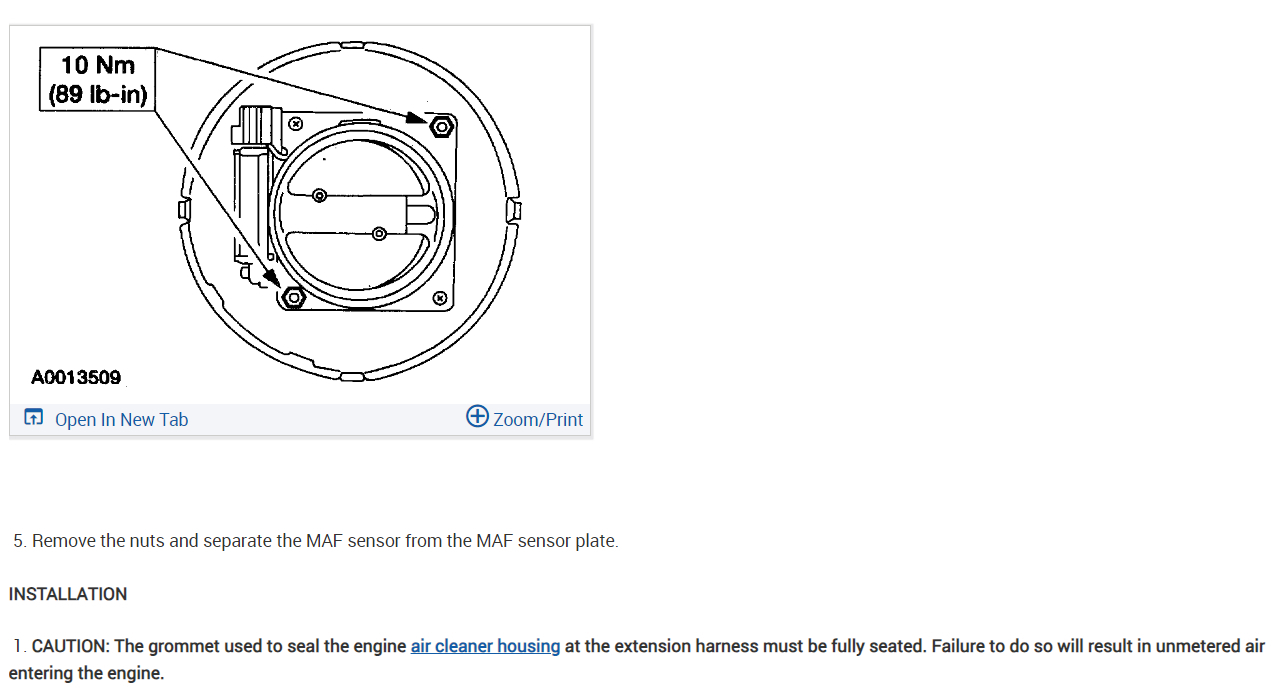

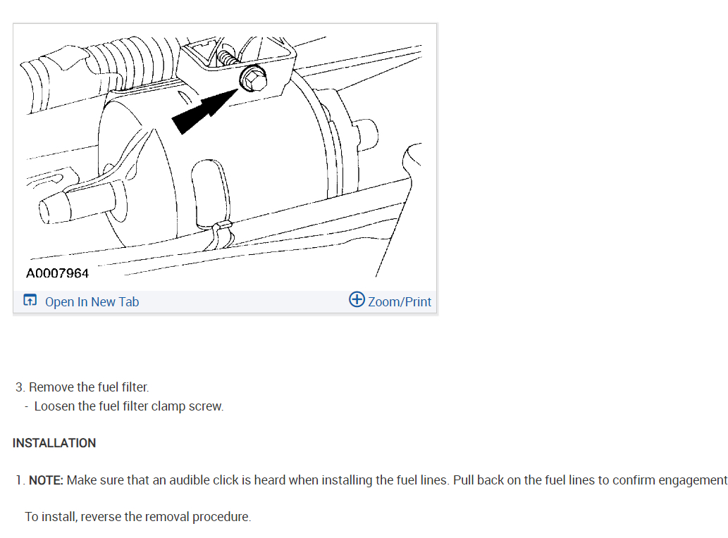

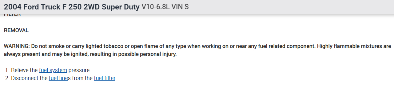

Please upload a shirt video of the problem so we can see what's going on. Is the engine missing or shutting off momentarily like it is a lack of fuel? Also, I would replace the remainder of the ignition coils. I have seen a clogged fuel filter or a bad MAF sensor cause these kinds of problems and not trigger a trouble code. Both are regular service items. Check out the images (below). Please let us know what happens.

Misfires don't always cause codes, but you should be able to see the misfire count on the scanner. To confirm I would double check the spark plugs to make sure one or more is not cracked and that the engine has all new ignition coils. Also, I would install a new MAF sensor and fuel filter.
