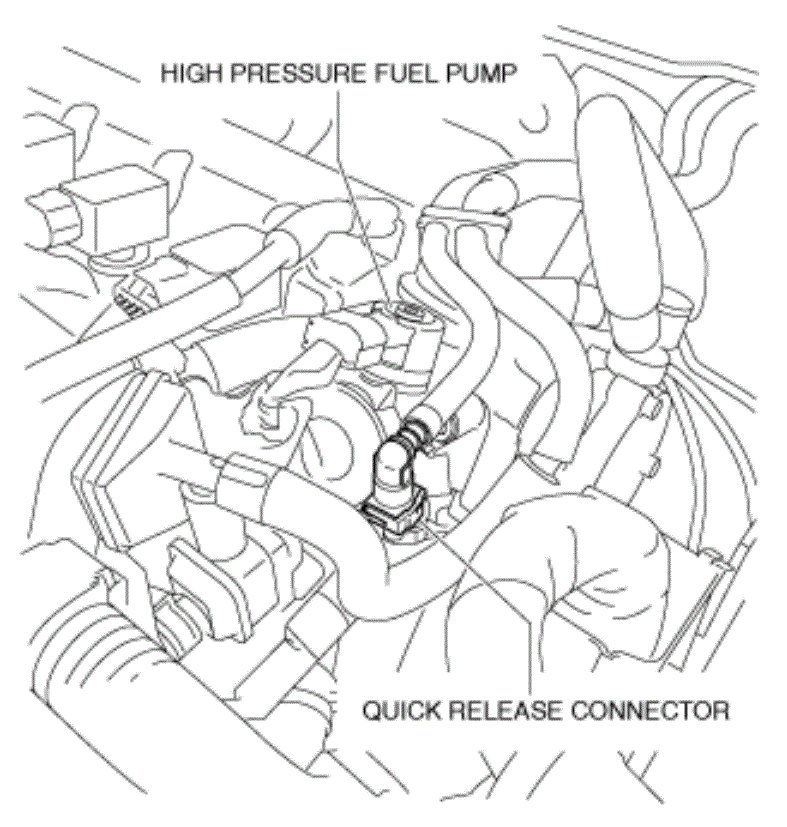

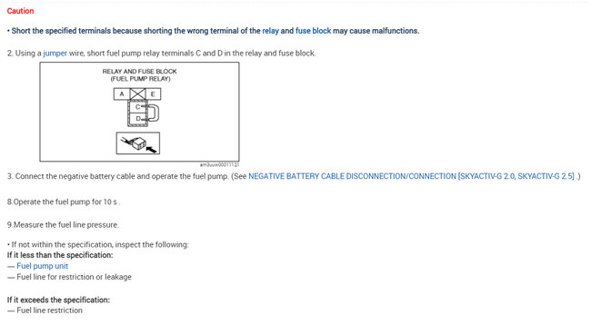

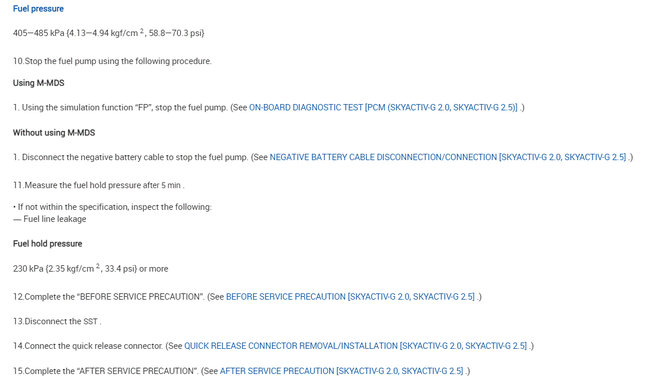

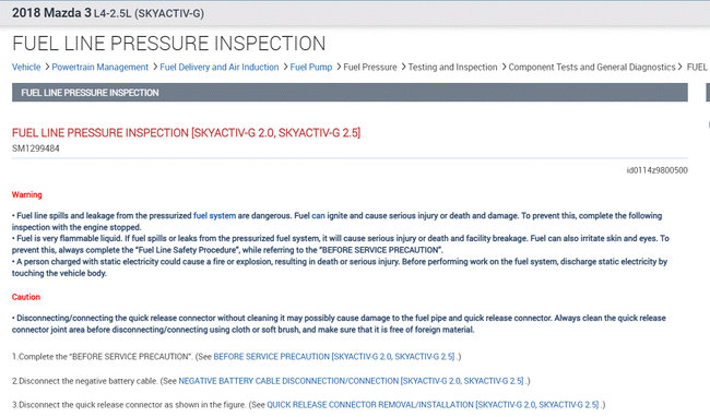

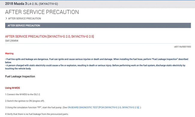

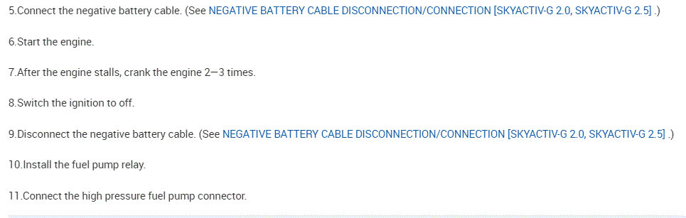

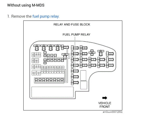

Do me a favor. Take a rubber mallet and tap on the exhaust system to see if you can reproduce the rattle you hear. If you do, note where it is coming from and let me know.

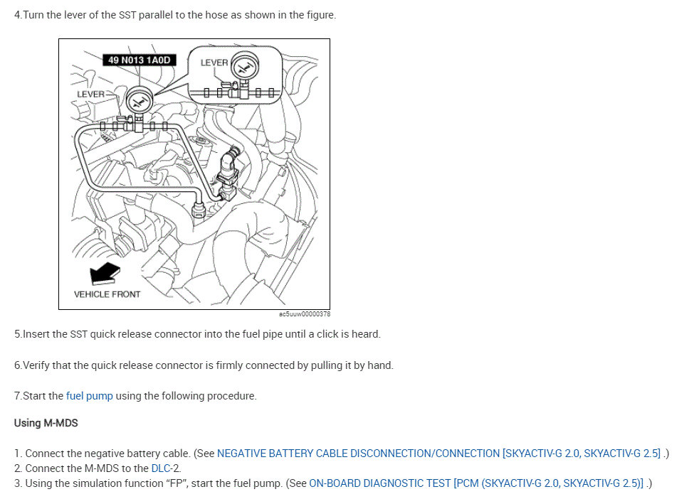

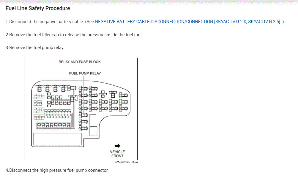

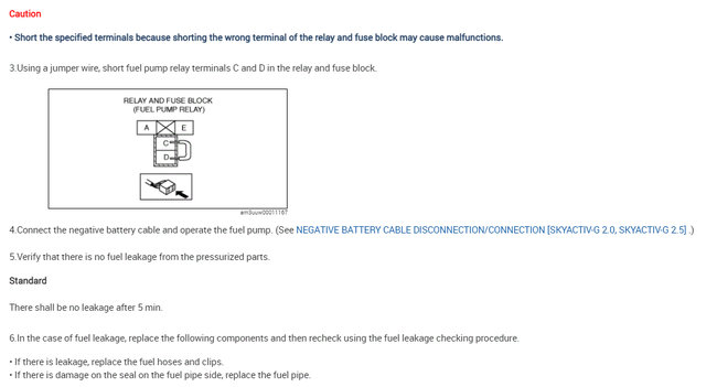

As far as the fuel pressure is concerned, here is a link that explains how it is done:
You will need a fuel pressure gauge, but most parts stores will lend one to you.
The pics I attached below are the directions specific to this vehicle. I included both the preservice precautions and after-service precautions. The manufacturer's fuel pressure specifications are included in the directions.
