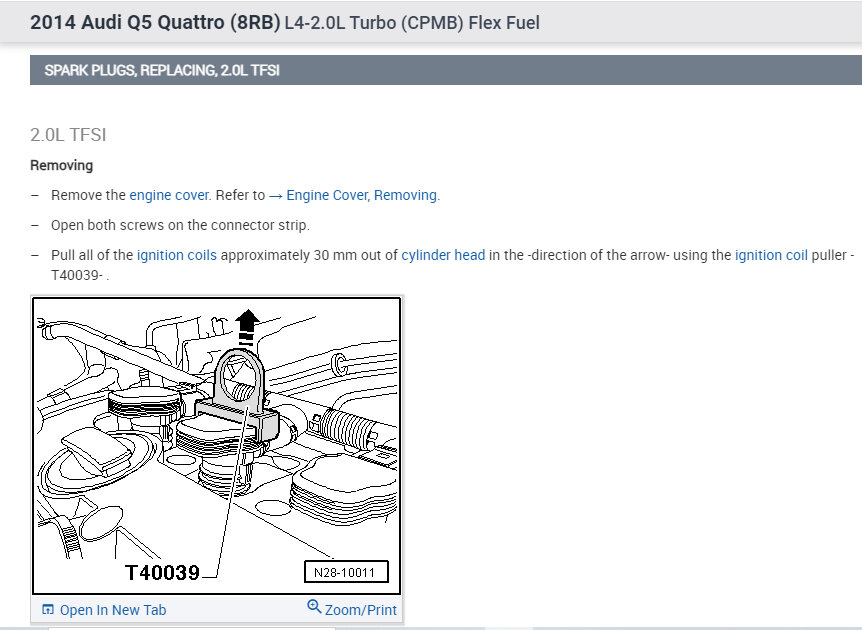

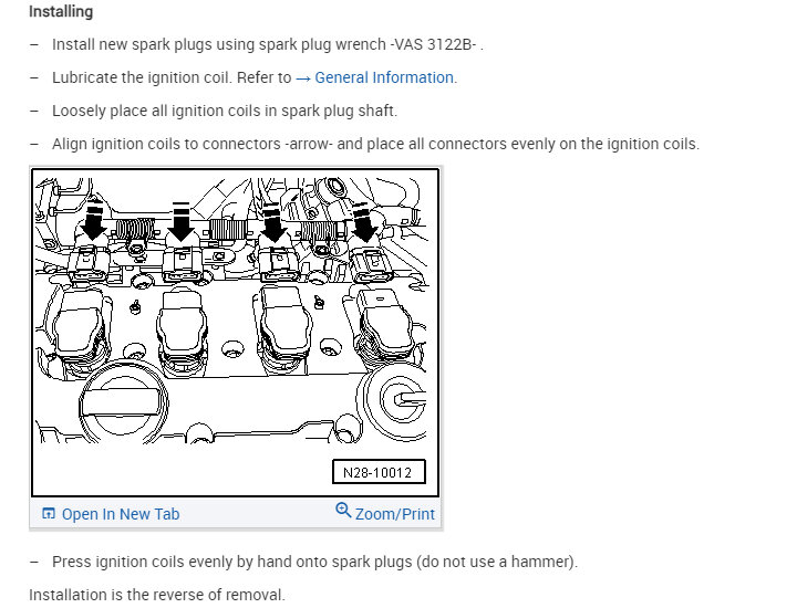

Yes, a failed spark plug can cause a misfire. Are these original spark plugs, or have they been replaced? If they are original, I would replace all of them. I don't know if you need them, but I attached the directions below.
Also, keep in mind there could be other causes. For example, a faulty fuel injector or there may be no power to the coil. Have you checked those things as well?

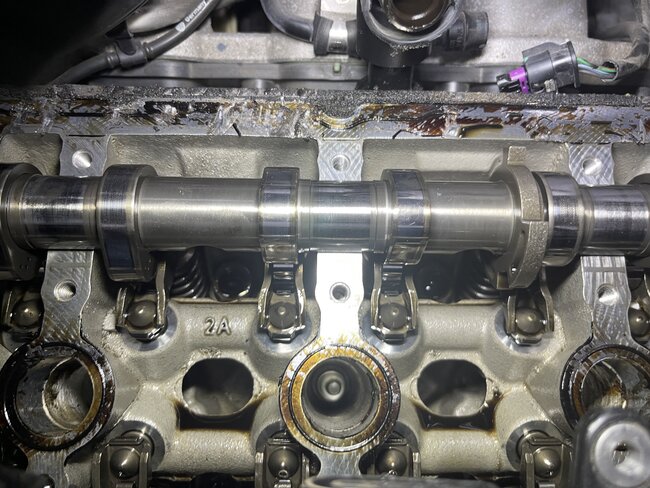

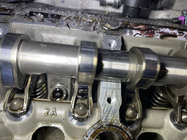

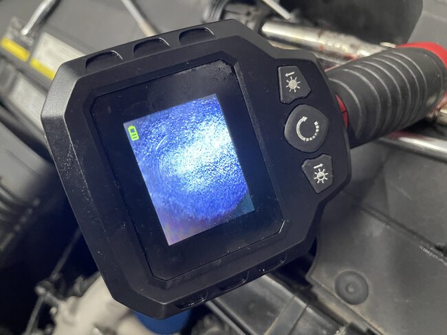

Not seeing anything strange or different here. This was a PITA to remove.
Oct 24, 2023 at 4:54 PM
  • 110,194 POSTS
If you check the cylinder 3 valves, do they appear to be fully closing? You may have to turn it by hand a bit.

I don't want to turn the cams while they are not bolted now, that calls for a disaster if anything jumps as far as the chain goes. Let me check and see if they closed.
Oct 24, 2023 at 5:42 PM
BHAMDOC1973
  • 2,007 POSTS

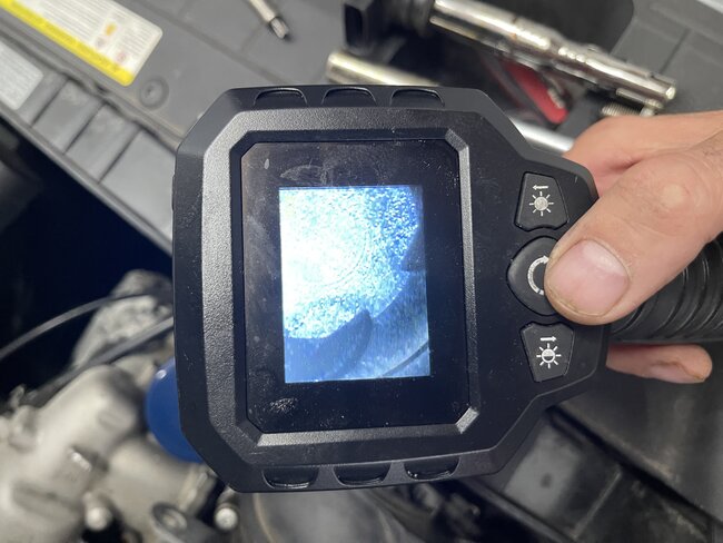

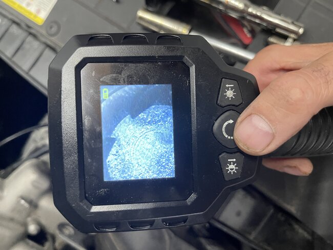

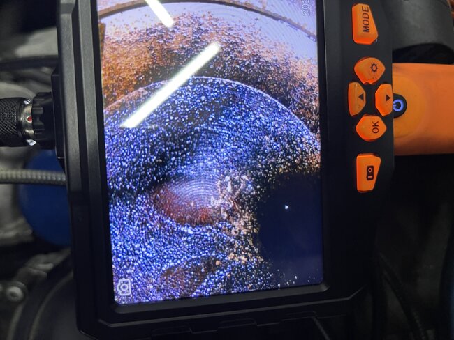

Can't really tell if they are or not.
Oct 24, 2023 at 5:52 PM
  • 110,194 POSTS
Is it possible for you to get a clearer image with the borescope? I couldn't make out things too well.
If you can't get a better pic or tell if the valves are closed, other than removing the cylinder head for inspection, there isn't much we can do.
Let me know your thoughts. Also, let me know what I can do to help.

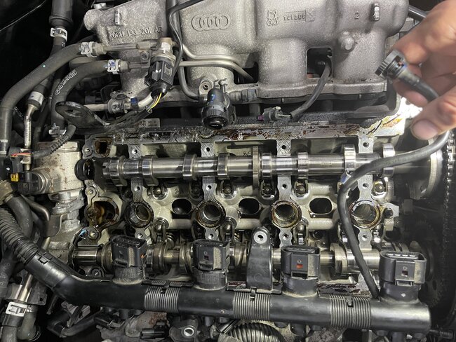

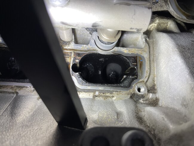

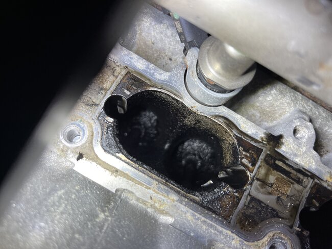

Removed intake. Geez the carbon build up. All intake mantild runners move like they should. Not seeing any damage to aby valve ir broken pieces.

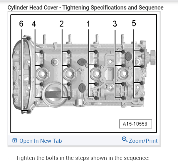

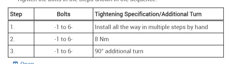

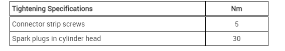

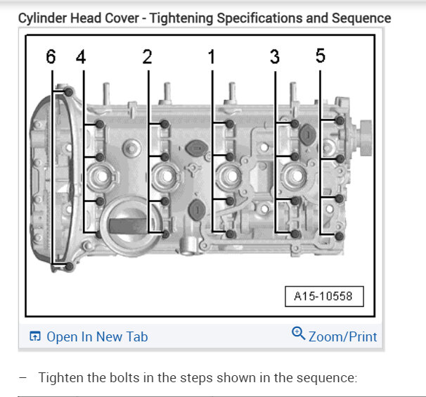

And this silly design where i must out back the valve cover if i want to spin the motor cause the valve cover bolts hold down the springs. Can you get me the torque specs for these torx bolts?
Oct 25, 2023 at 2:01 PM
  • 110,194 POSTS
Wow, that is a lot. Now that I see that, I suspect we may have a valve not fully seated. Are you able to get it cleaned out at all?
As far as the torque specifications, I added them below. Make sure you follow them in the three-step process indicated. Also, don't overtighten them. Make sure the surfaces are clean and dry before installing the sealant.

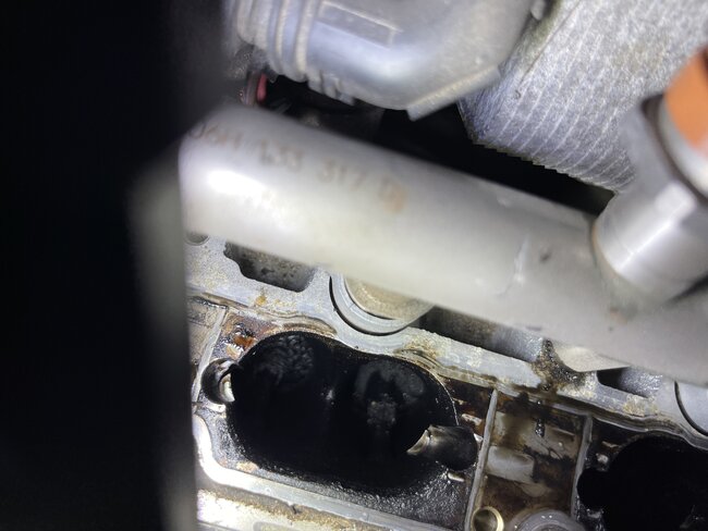

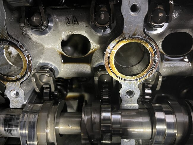

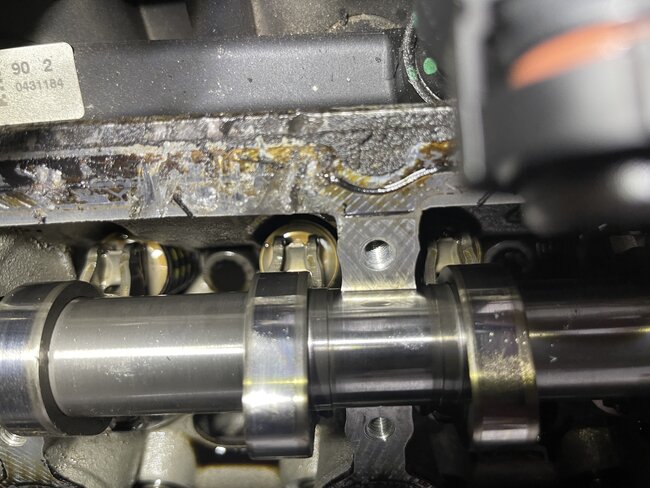

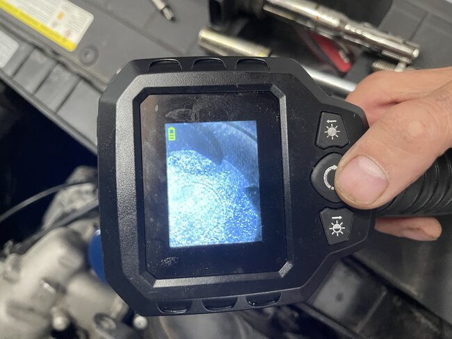

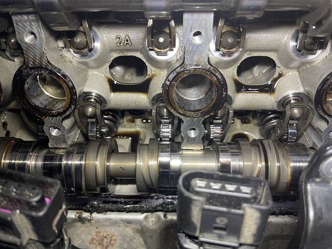

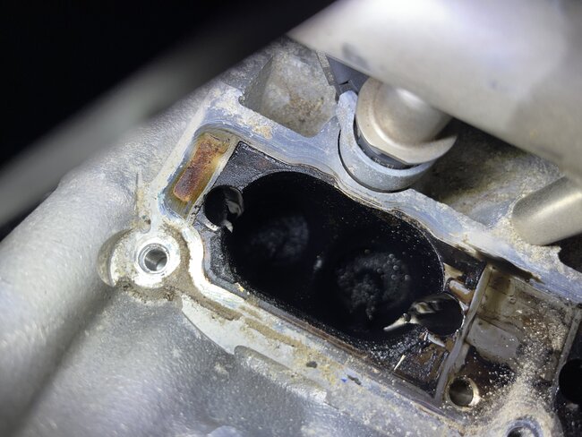

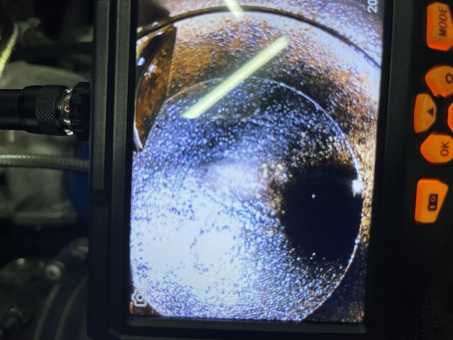

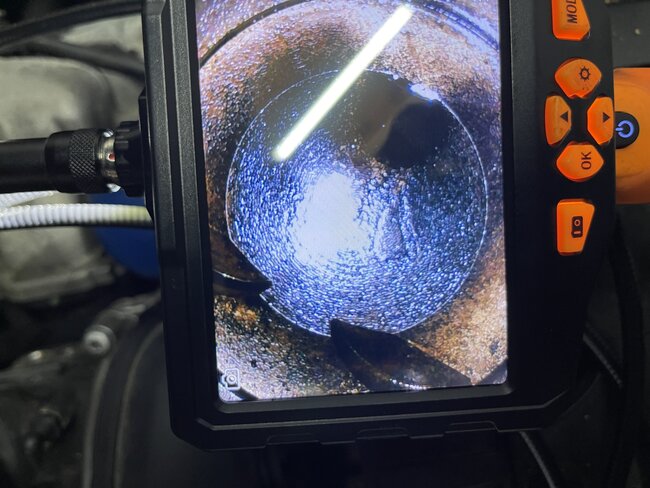

I took a few pictures, does this look like a bent valve or is this normal? Not sure if the cylinders usually have groves on these engines.
Oct 31, 2023 at 8:14 AM
  • 110,194 POSTS
Are the pics you attached all from the same cylinder? I do see marks in picture number two, but pics 1 and 3 don't appear to have the same marks. Also, if there was interference between the valves and pistons, you would know. The pistons would have a clean mark where they touched.
The idea that you may have a bent valve really isn't shown in these pics. Remember, since you have 30 psi compression, which indicates there isn't a bent/stuck open valve. Based on that information, I would suspect something is preventing one of the valves from fully closing.

Yes, all from same piston 3, one was a side picture to show valve. Strange problem to tackle.
Oct 31, 2023 at 6:34 PM
  • 110,194 POSTS
Is it pic 1 that shows the valves? If so, they don't look seated properly. I may be wrong because it's difficult to tell in a picture, but is what I see.
Oct 31, 2023 at 7:16 PM
BHAMDOC1973
  • 2,007 POSTS
Yes, that's what I am seeing. Do exhaust valves usually suffer from carbon build up as well?

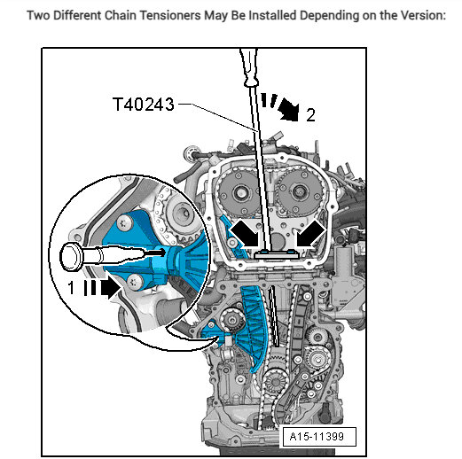

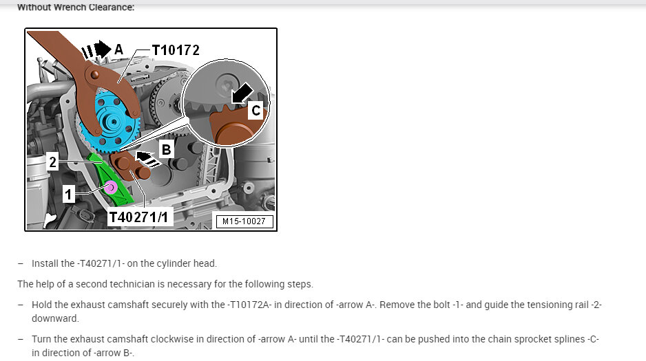

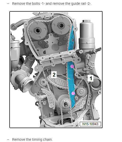

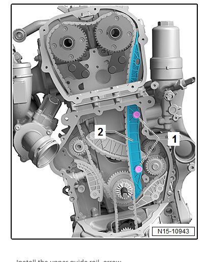

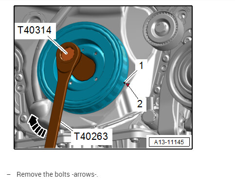

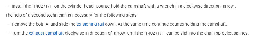

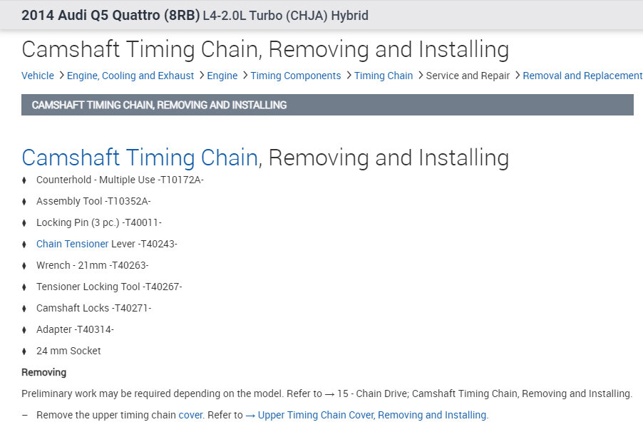

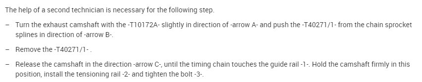

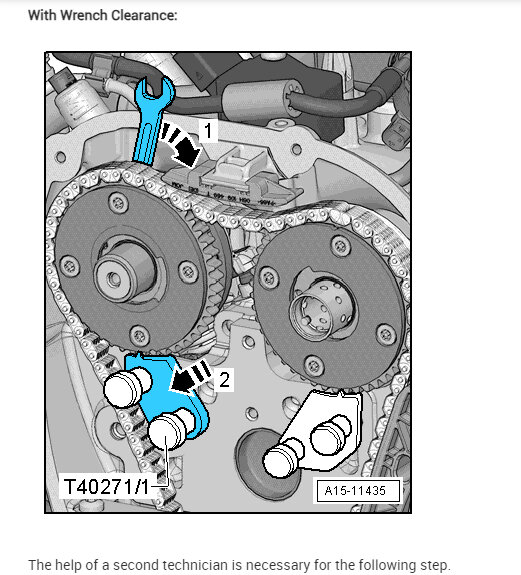

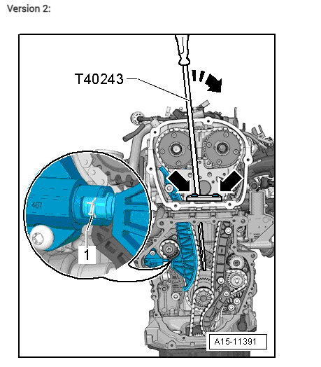

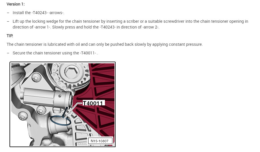

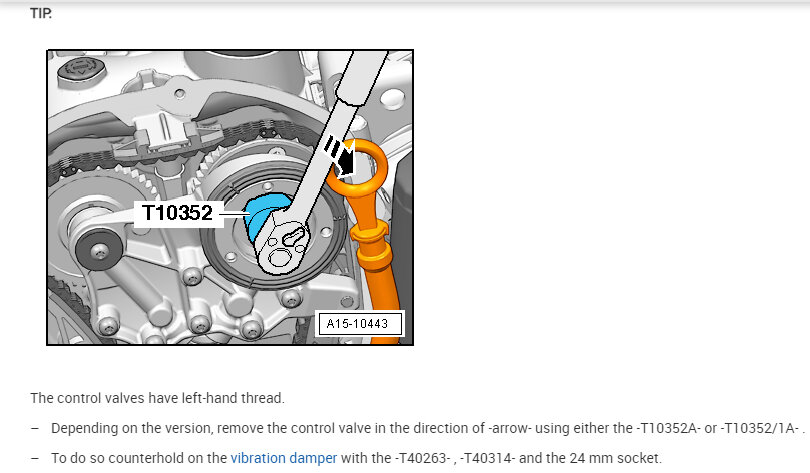

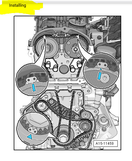

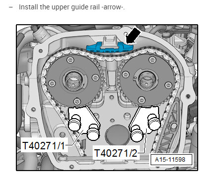

The only thing that scares me when removing the head is the chain. I don't want to deal with timing as i know I am not so good at it. So, i don't want to remove the chain completely but rather just hang it on each side. Also, i see some people remove the turbo aside some don't so i don't know which is easier in this case, whether to leave it on car or remove it with the cylinder head.
Nov 1, 2023 at 6:52 AM
  • 110,194 POSTS

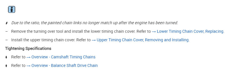

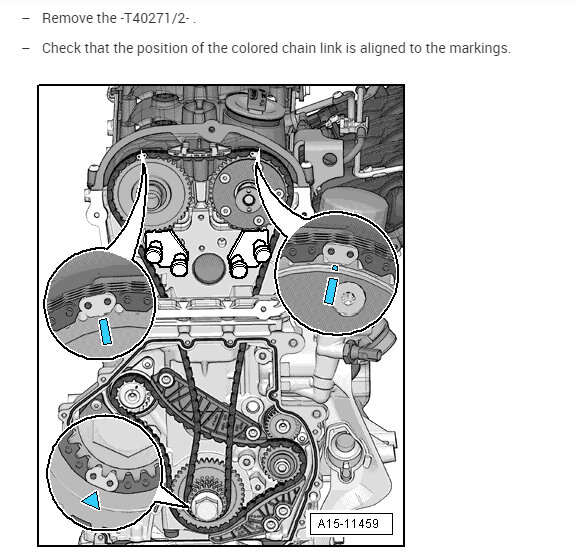

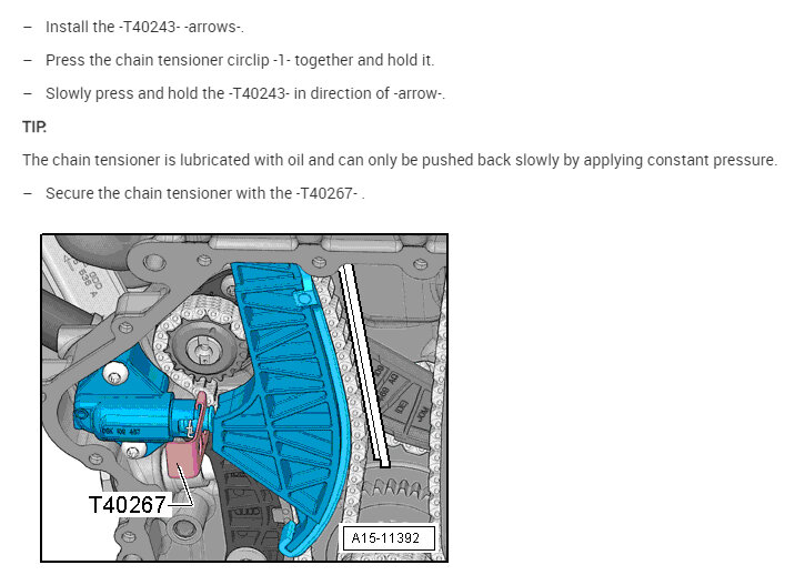

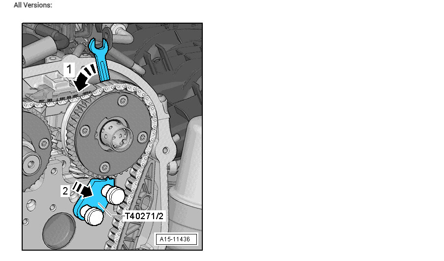

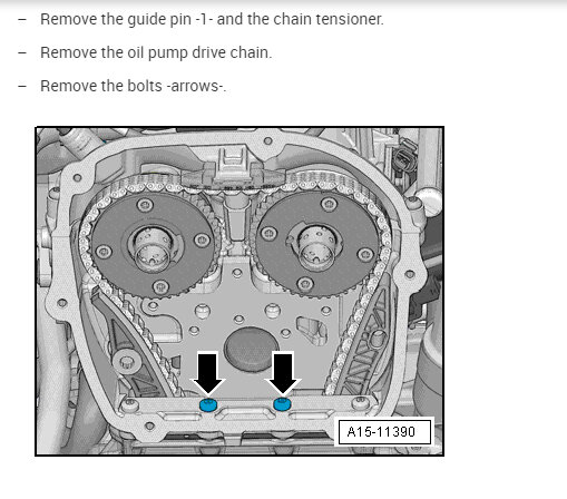

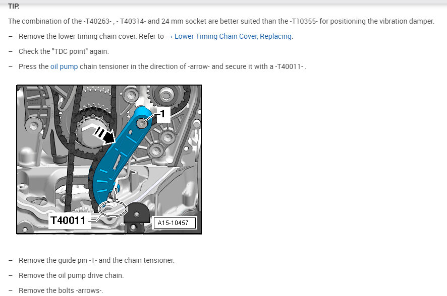

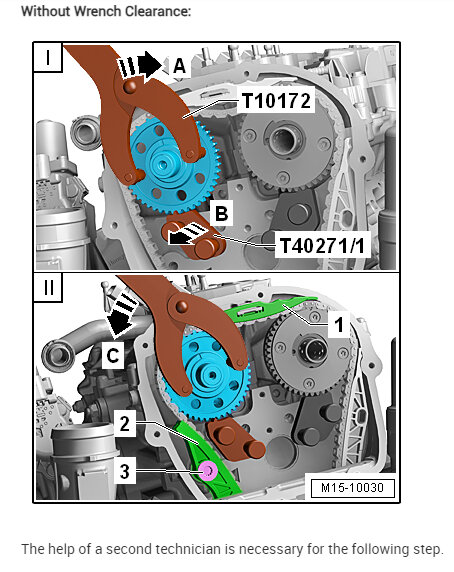

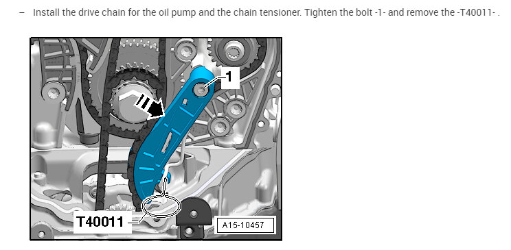

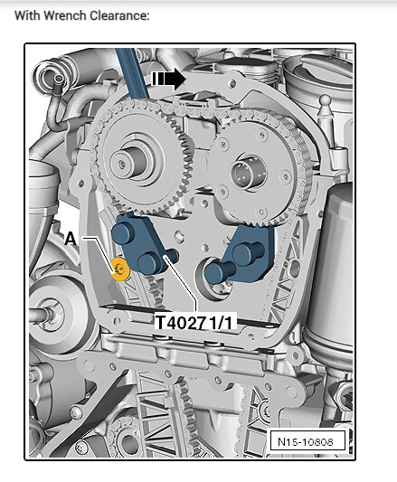

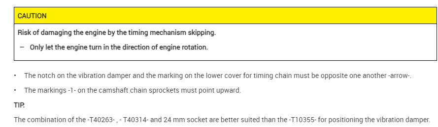

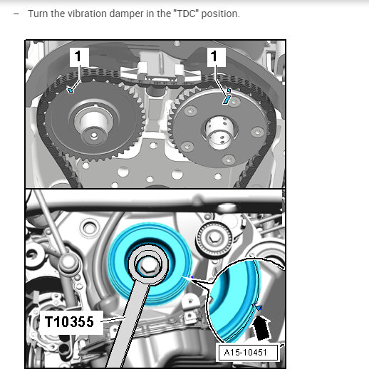

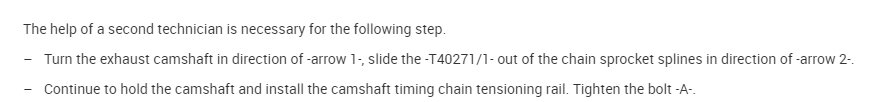

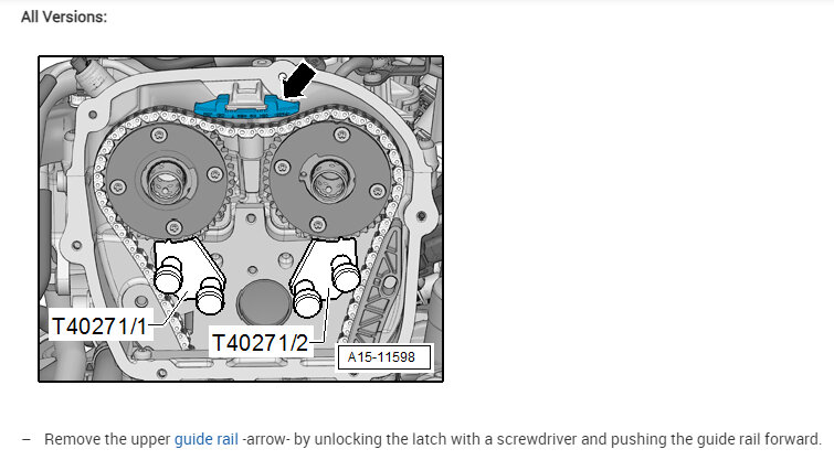

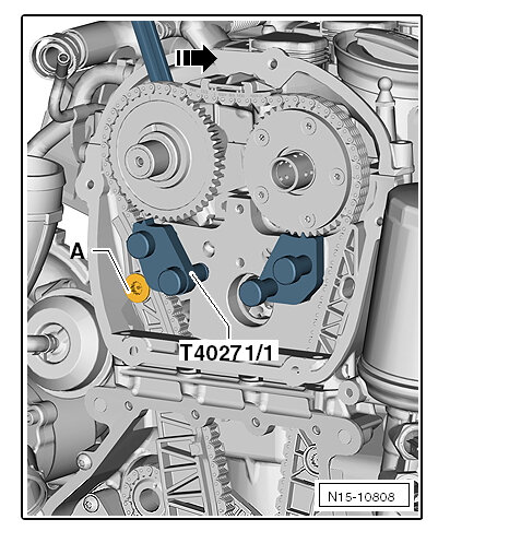

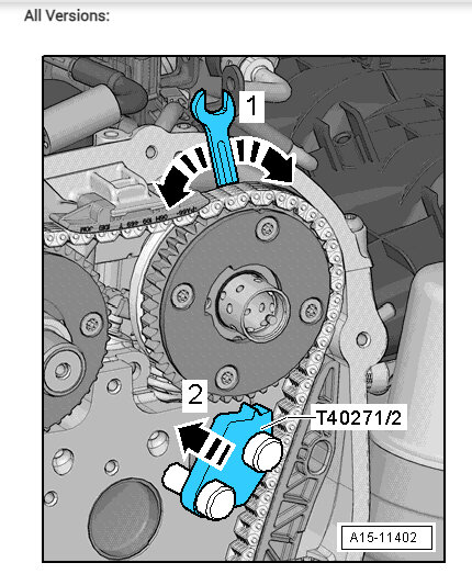

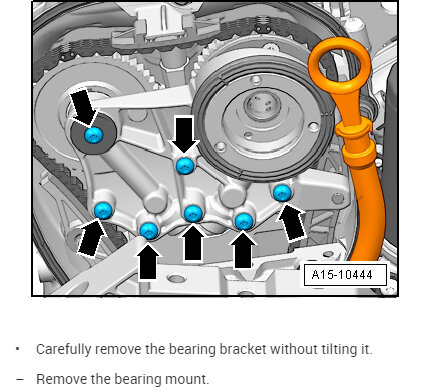

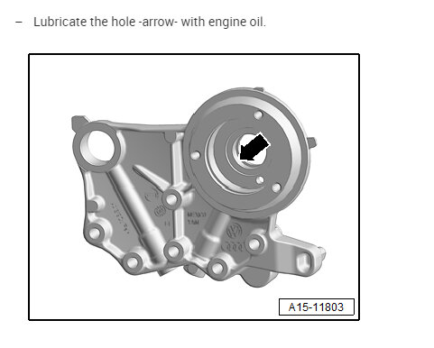

Hi, 43
Either valve can have a carbon issue. If you check other cylinders, do they look the same?

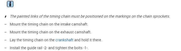

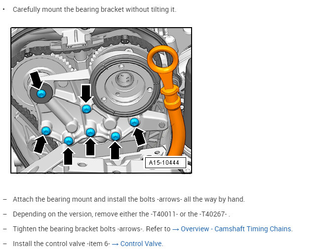

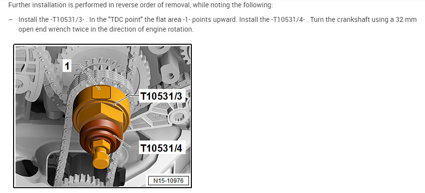

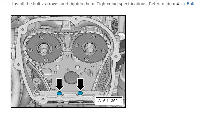

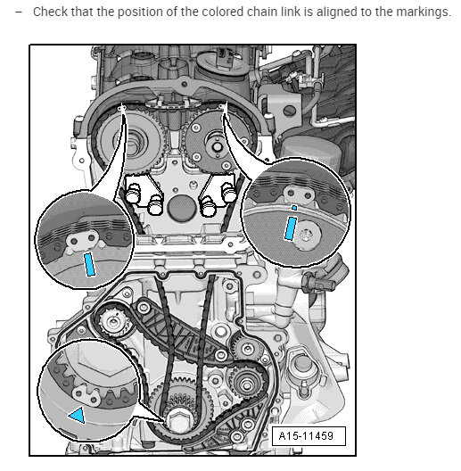

As far as the timing is concerned, I totally understand. This vehicle will require special tooling to hold the cams in place. I attached the directions for camshaft timing chain removal and installation so you can see what needs to be done.
Let me know if this helps.

Thanks. All valves had build up which i walnut blasted. Still same exact compression of 30 on that cylinder. No knocking, no timing codes. Ya the chain is scary, i have seen people remove the sprockets and hood the chain to each side tight till done, but not sure if it's doable. One mistake and it's done. I have all of these tools pretty much. Not sure if the issue could be on the exhaust side or if build up can happen there like it does on intake side.
Nov 1, 2023 at 7:16 PM
  • 110,194 POSTS
It could be either side. If you decide to remove the head, let me know. I'll try my best to help from here. Also, as long as the colored links on the chain are aligned with the marks, it will be in time. Once reassembled, you can rotate it by hand to make sure there is no interference.
