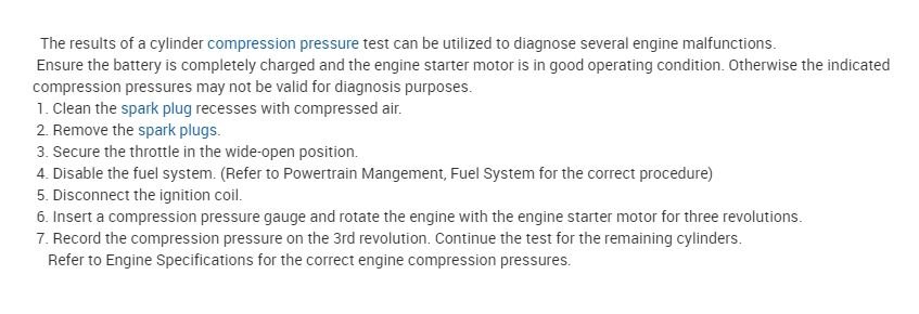

I have changed plugs, coil pack, injectors and MAP sensor, but still have a misfire on cylinder two. Any suggestions?

Good evening,
I would check the compression to be sure there is no internal engine damage.
I attached the procedure and the spec for you to check.

I’ll give it a try and let you know what happens. Thanks
