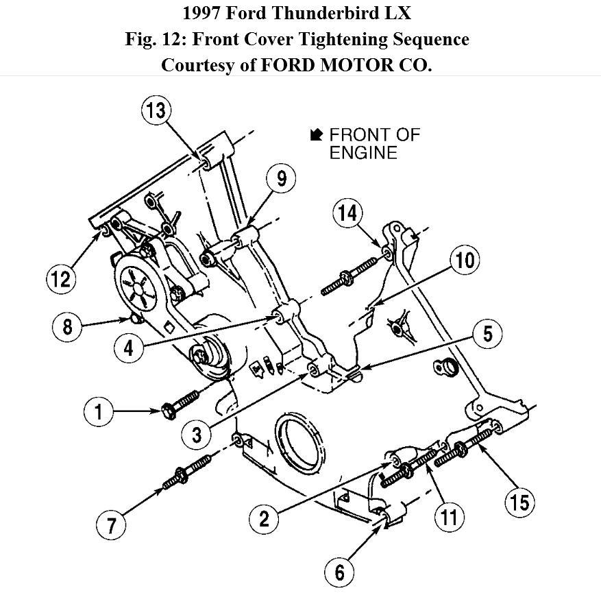

2 cylinders share the same point of reference for the cranksensor and there are 4 separate pickup points in total.

How would I check that out? The manual talks about voiding the A/C system and removing the compressor yada yada!
Thursday, June 13th, 2013 AT 11:29 AM
KHLOW2008
  • 41,814 POSTS
Yup, not an easy job. The front cover has to be removed to gain access to the cranksensor pulse wheel, which would mean a host of components to remove.
