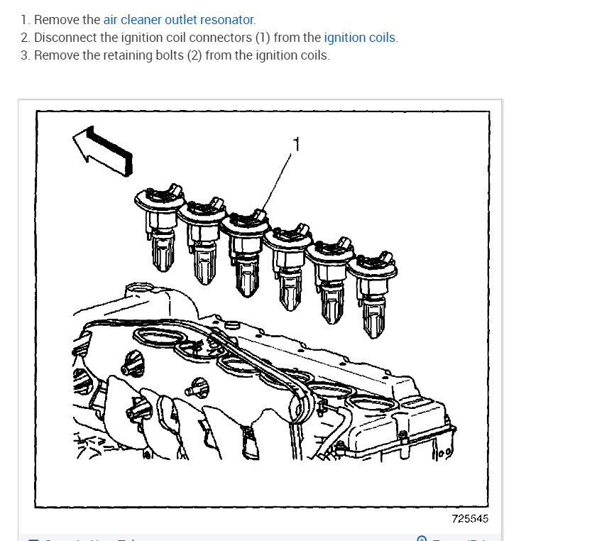

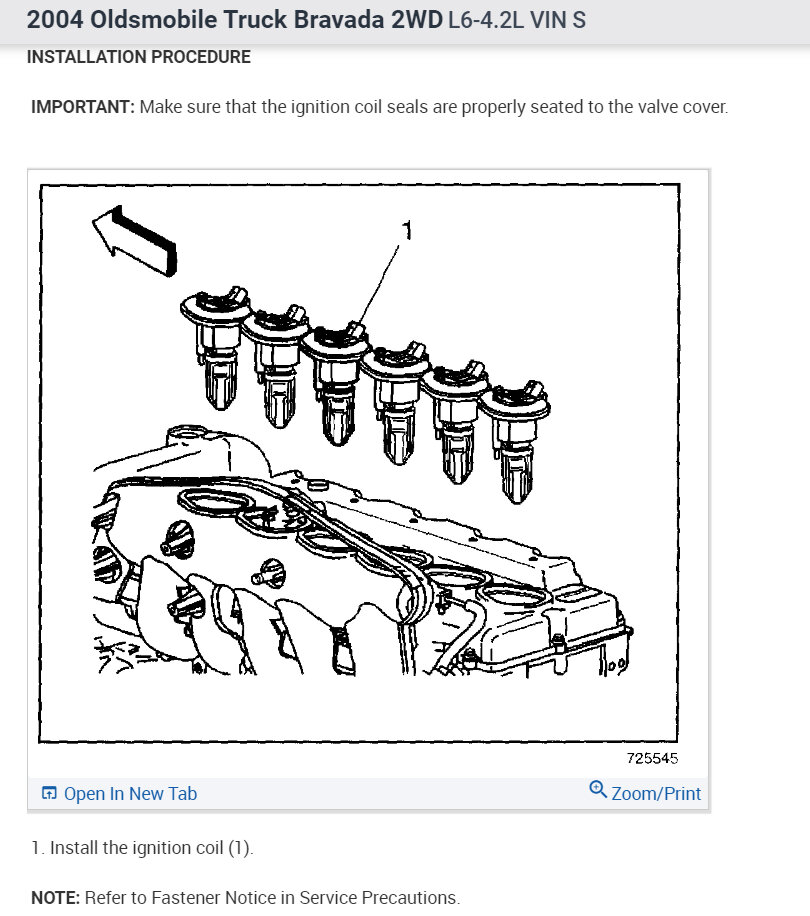

I developed a misfire on cylinder #2 according to OBD2 error codes and I replaced all the plugs because it needed that anyway, but that made no difference. Then I swapped the #3 coil, which is pretty new, with the #2 coil and the specific error code P0302 went away, but then I got a P0300 general random multiple cylinder misfire. Could switching those coils have something to do with that? Also, I have 5w-30 oil in this car and I am in a hot climate (west central Florida) and someone told me that I should have 10-w30 in there and that it might, even though it's remote, cause the P0300. I don't think that's true though. Am I mistaken, or is he? Thanks.

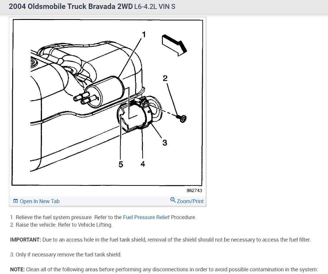

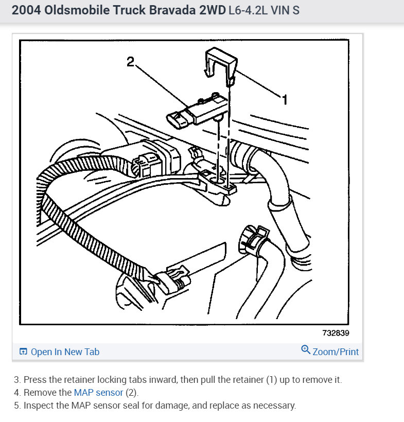

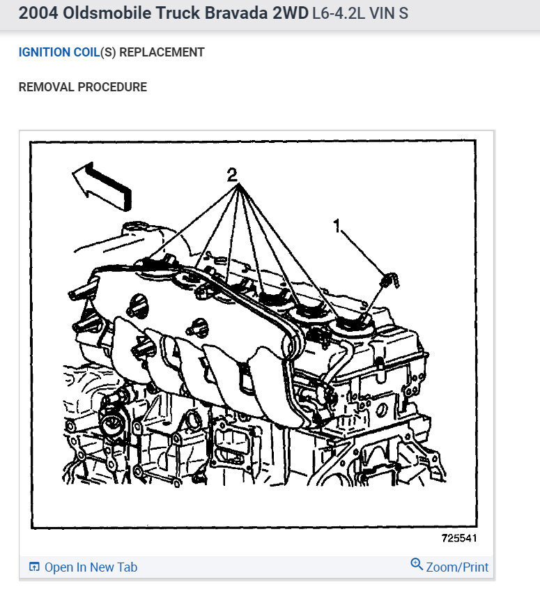

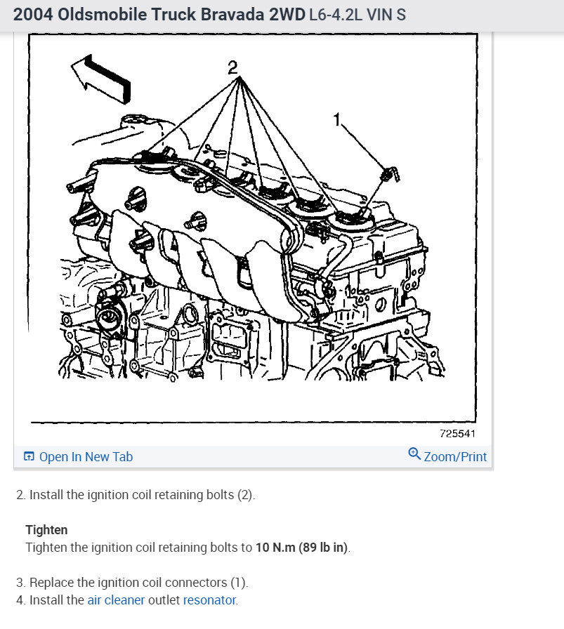

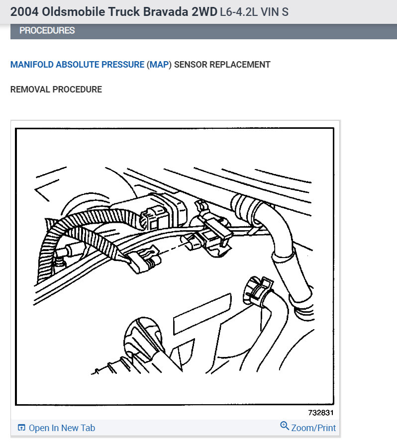

Yes, it sounds like you need a set of coils which is common, the engine oil will not make a difference on the misfire issue. Also, you might need a MAP sensor and to change out the fuel filter. I would also clean the throttle body, here are guides to help with instructions in the images below:
Check for a vacuum leak when the engine is cold only.
Check out the images (below). Please let us know what you find. We are interested to see what it is.

Hello. Sorry it's been so long. A lot happening. Well, it turns out it was a bad coil. Originally, the misfire was on cylinder 2. I swapped the coil with the one on cylinder 3, and the misfire continued, but I did not get the single cylinder misfire code but the general one as I said. I had a hunch and replaced that coil with a new one and the misfire was gone, along with all the error codes. Tests for codes are coming up clean now. Thanks for the help.
