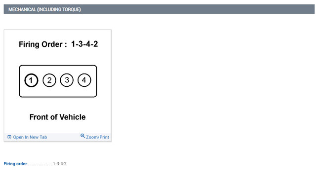

I have a code for a misfire in cylinder 1. I just need to know where cylinder one is located on my vehicle listed above. These firing orders always get me confused and i want to make sure i replace the right one. I will replace them all when i can afford it but for now just this one. Thank you

Hello, if you're facing the vehicle cylinder 1 is all the way to your left, passenger side of the engine.
