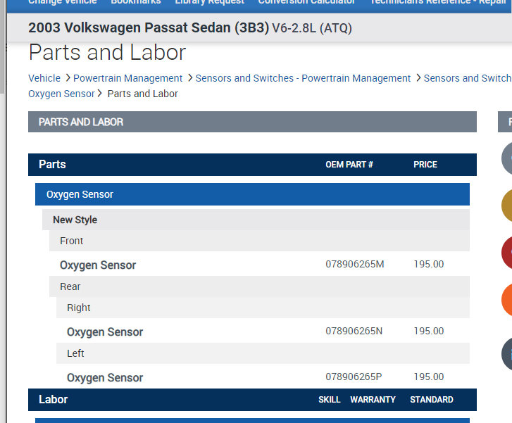

I have a question, can a swapped rear o2 sensor from bank 1 to bank 2 and the other from bank 2 to bank 1? Because a misfire. I've been having a misfire on bank 1 on heavy acceleration and don't know if rear o2 sensors are reversed.
Aug 7, 2021 at 3:28 PM

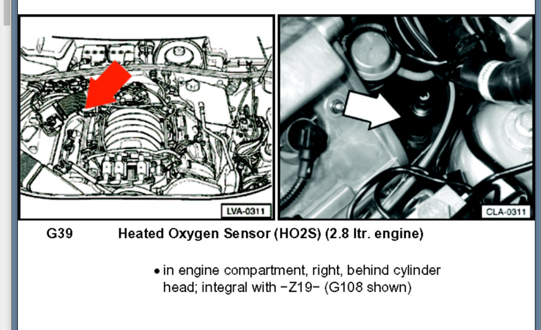

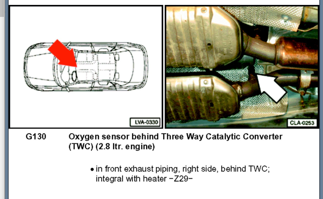

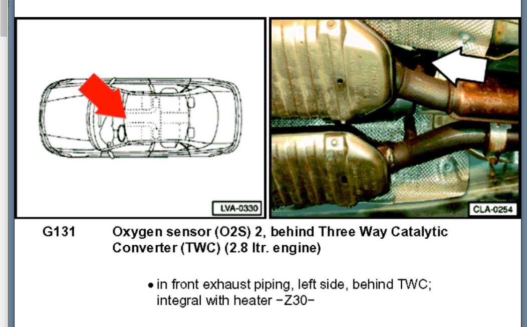

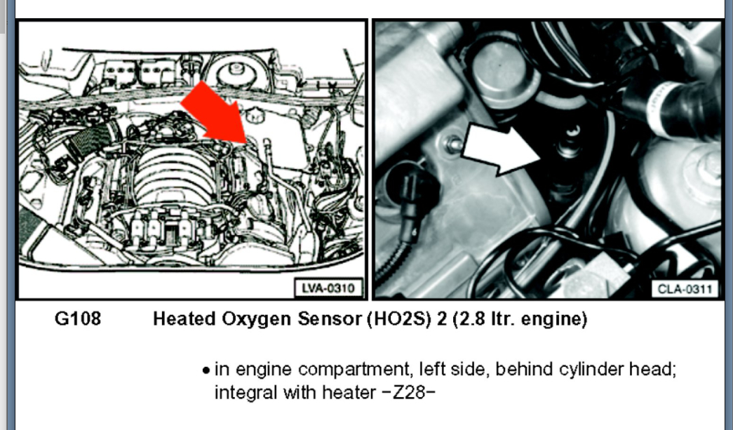

Yes, you can. An o2 sensor is just an o2 sensor so the only real difference between them is the fitment. So you have a sensor for just the left front and that may be just because it is a tight space and the may not fit.
However, they are only measuring oxygen content so there is no difference with the actual sensors.
Here is a guide that will help with testing o2 sensors if you would like to do this as well:
https://www.2carpros.com/articles/how-to-test-an-oxygen-sensor-02-sensor
However, if you have a misfire, this guide will walk you through some other things as well but swapping the sensors to see if the misfire changed banks is a good idea.
Please see the info below on each of the sensors and let us know if you have questions and what you find.
Thanks
