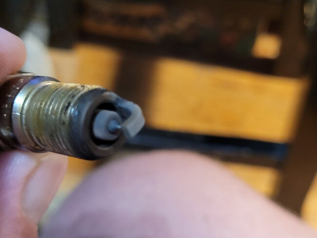

Car began running rough and check engine light came on,ran diadnostic and said cylinder 1 misfire coil a primary/secondary,change coil,swapped plug with diff cyl to save money plus they arent very old,however still misfiring,i even swapped coils with another cyl and still have trouble with same cyl,runs ok when in motion but idles rough.tried unplugging coil while car runnin but no change,check all connections and all show same voltage.at a loss for further diagnosis?could be power control module mabye,your thoughts

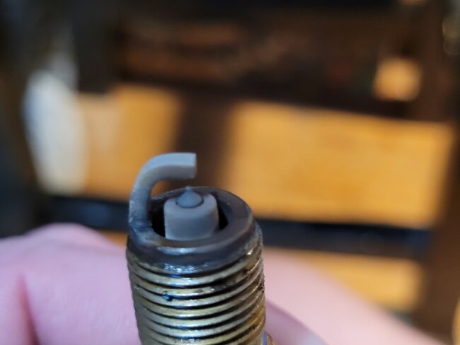

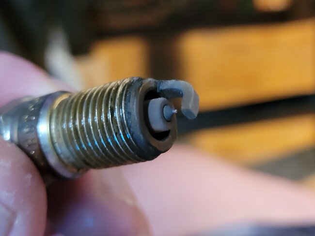

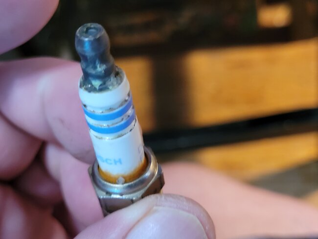

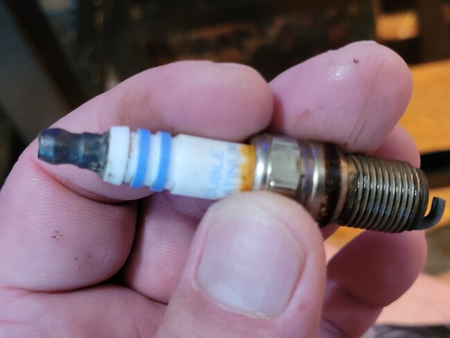

We were able to plu a long extension on injector and it sounded like the other injectors.heres a pic of the plug,i will have results from compression test soon.

Yep, the spark plug looks normal, I would do the compression test, thanks for the images they help. I would still swap a new spark plug in there just in case.
