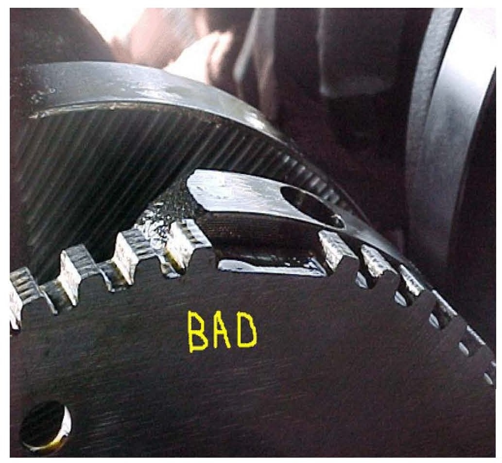

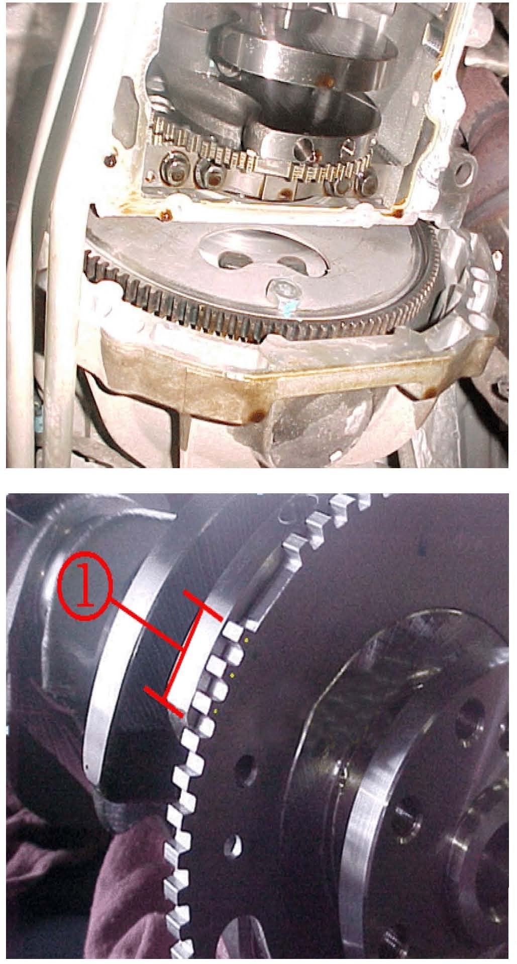

Second, there was a technical service bulletin (TSB) related to the reluctor attached to the crankshaft on these engines. They were actually moving on the crankshaft and causing ignition issues. Here is the TSB related to this issue:
The reluctor for the crankshaft sensor pressed on the crankshaft may have moved.
Refer to attached photographs for exact location.
(It is possible on some applications to view this with a bore scope through the crank sensor hole without removing the oil pan)
If the reluctor has moved then replace crankshaft.
1= The actual measurement of a good Reluctor wheel.
25 to 26 mm This measurement is from the end of the machined surface of the crankshaft throw to the edge of the open space in the reluctor. (approximately 3 1/2 teeth)

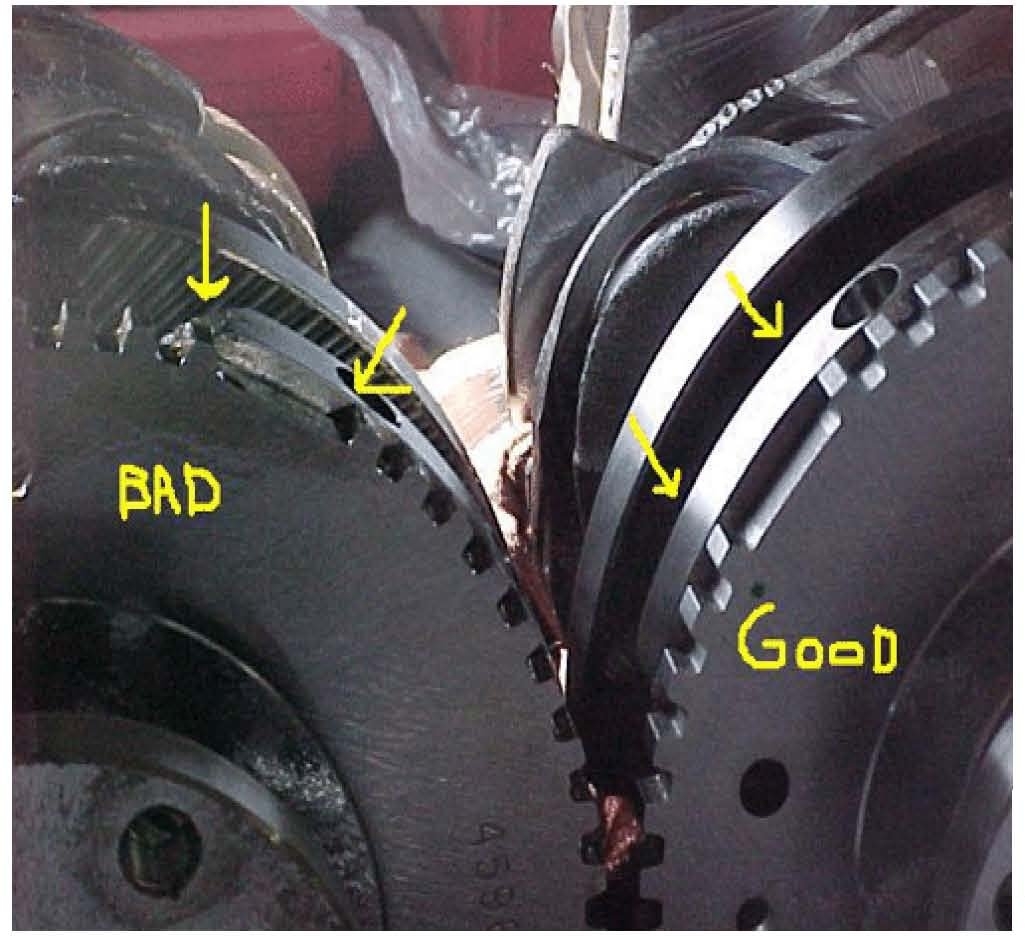

2 and 3 = Show a good reluctor next to a bad reluctor.
Crankshaft with bad reluctor wheel.
Note :The distance can be offset either clockwise or counter clockwise. Both will result in these codes.
Note : The balance hole does not come into play when determining if the reluctor has slipped or not.

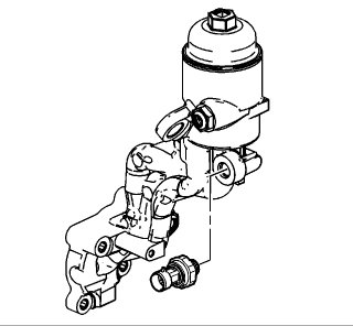

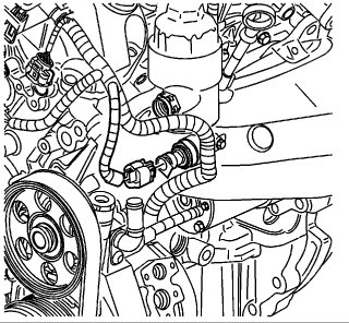

Now, with that being said, I would do the following. First, determine that oil pressure is good at start up. Here are the directions from alldata for checking oil pressure. You will need a pressure gauge, but most parts stores will lend one to you. Also, I've attached pictures to help you locate items. The pictures relevant to these directions are 5 and 6.

Disconnect the oil pressure sensor wiring harness.
Remove the oil pressure sensor.
Install the J21867 with the J36648-A.
Measure the engine oil pressure.
Compare the readings to the Engine Mechanical Specifications.
