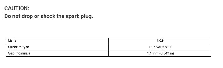

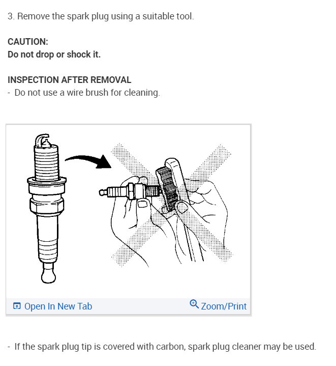

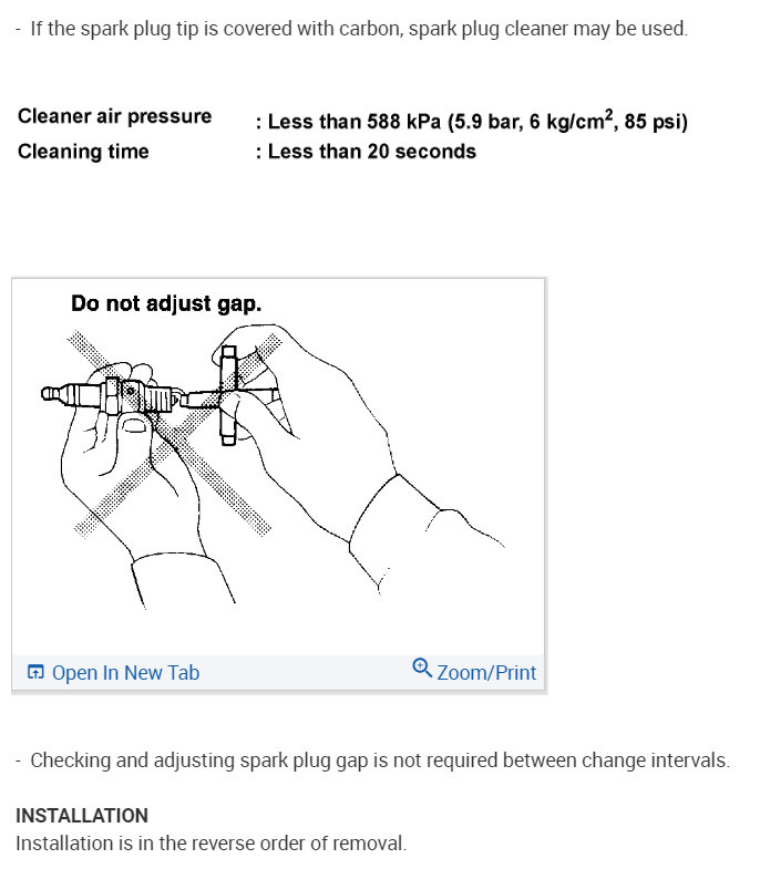

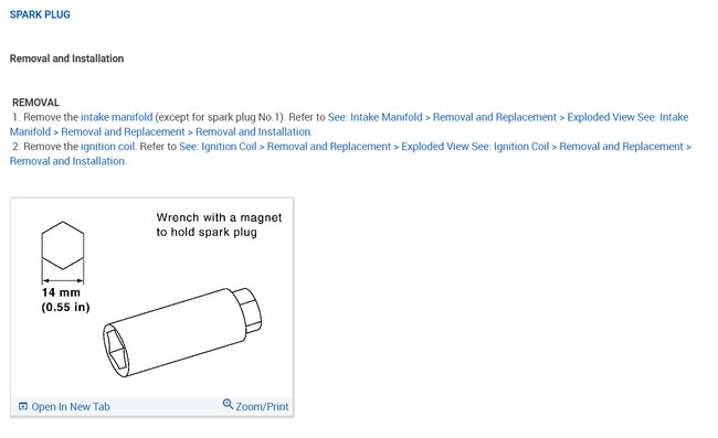

Yes, the injector connector will cause the engine to misfire, you can get what they call a pigtail injector connector from eBay or Amazon and splice it in to fix the problem. also, I would install a new set of spark plugs, here is a guide to help walk you through the repairs and explain about the bubbling noises:
https://www.2carpros.com/articles/vehicle-bubbling-noise
and
https://www.2carpros.com/articles/how-to-tune-up-a-car-engine
