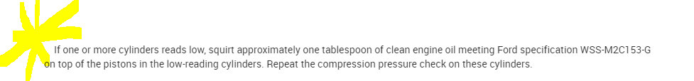

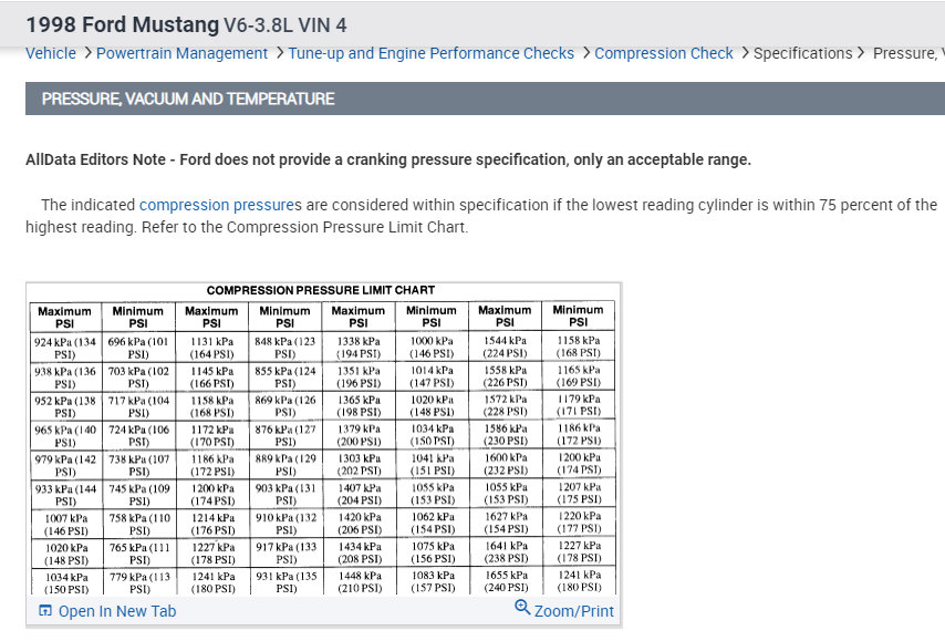

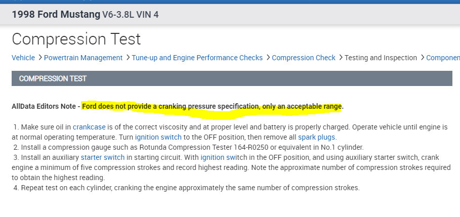

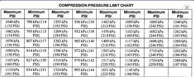

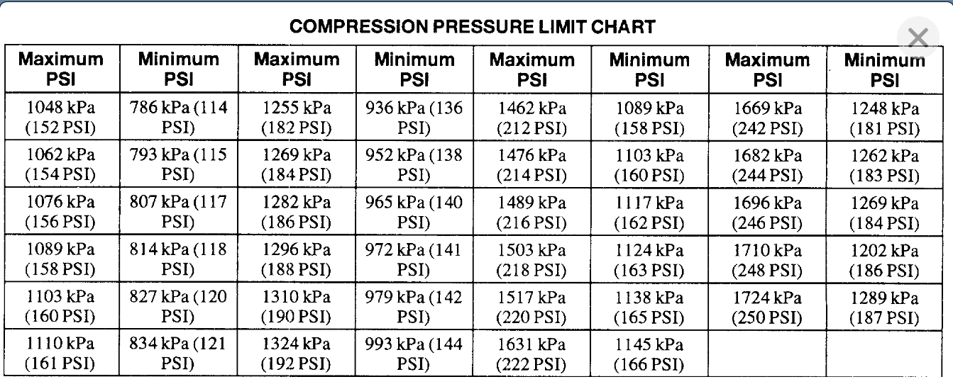

Pic 1 below are the directions specific to the vehicle. Note that Ford doesn't provide a specific compression reading. Instead, they provide an acceptable range only. The last pics are the range charts.
