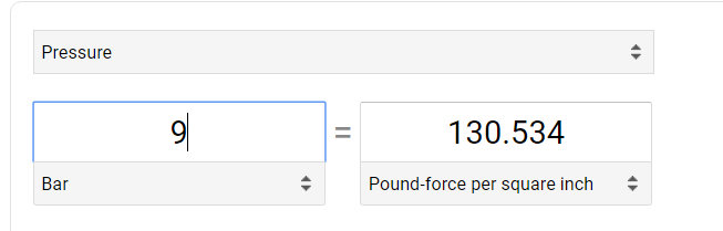

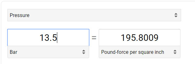

It looks to me like compression is low in all four cylinders. I have included a compression pressure chart for your vehicle down below in the diagrams. Your vehicle should have between 130 - 195 PSI in all cylinders. As a general rule of thumb, compression in lowest cylinder shouldn't be less than 10% of the highest cylinder. I have also included a link for you down below. Please go through all the information and get back to us with what you find out.
