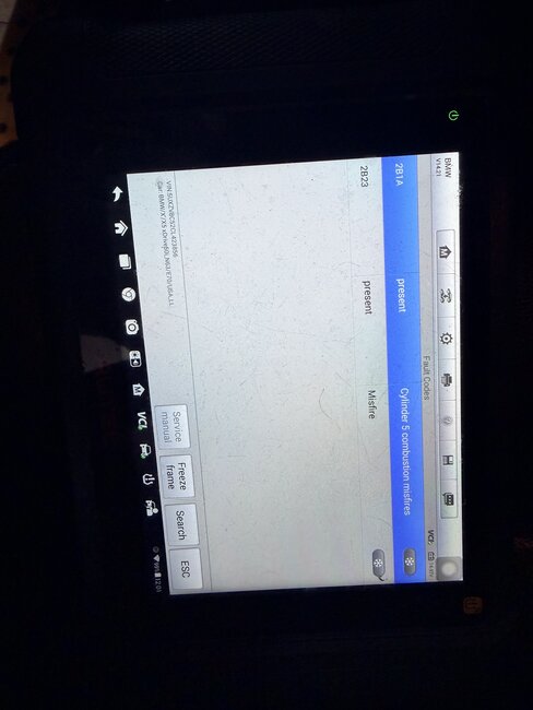

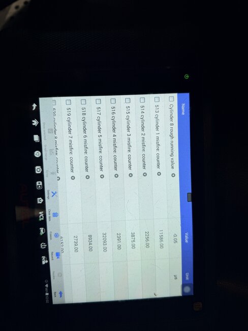

Starts fine when cold. Leave it few and it misfires on cyl 5 which i assume is on front of driver side. Changed coil and spark plug. Same thing takes few minutes before it misfires from cold. Scanner shows a history of all cylinders misfire at some point but cyl 5 in the 32000 compared in the thousands for others. Engine is smooth until this misfire of cyl 5 happens. Delete it even when warm its fine till it misfires again.
Oct 1, 2026 at 1:06 PM
BHAMDOC1
  • 423 POSTS
Also the only code is a misfire on cyl 5. No smoke when u first start it and the plug was not wet so i doubt a leaking injector

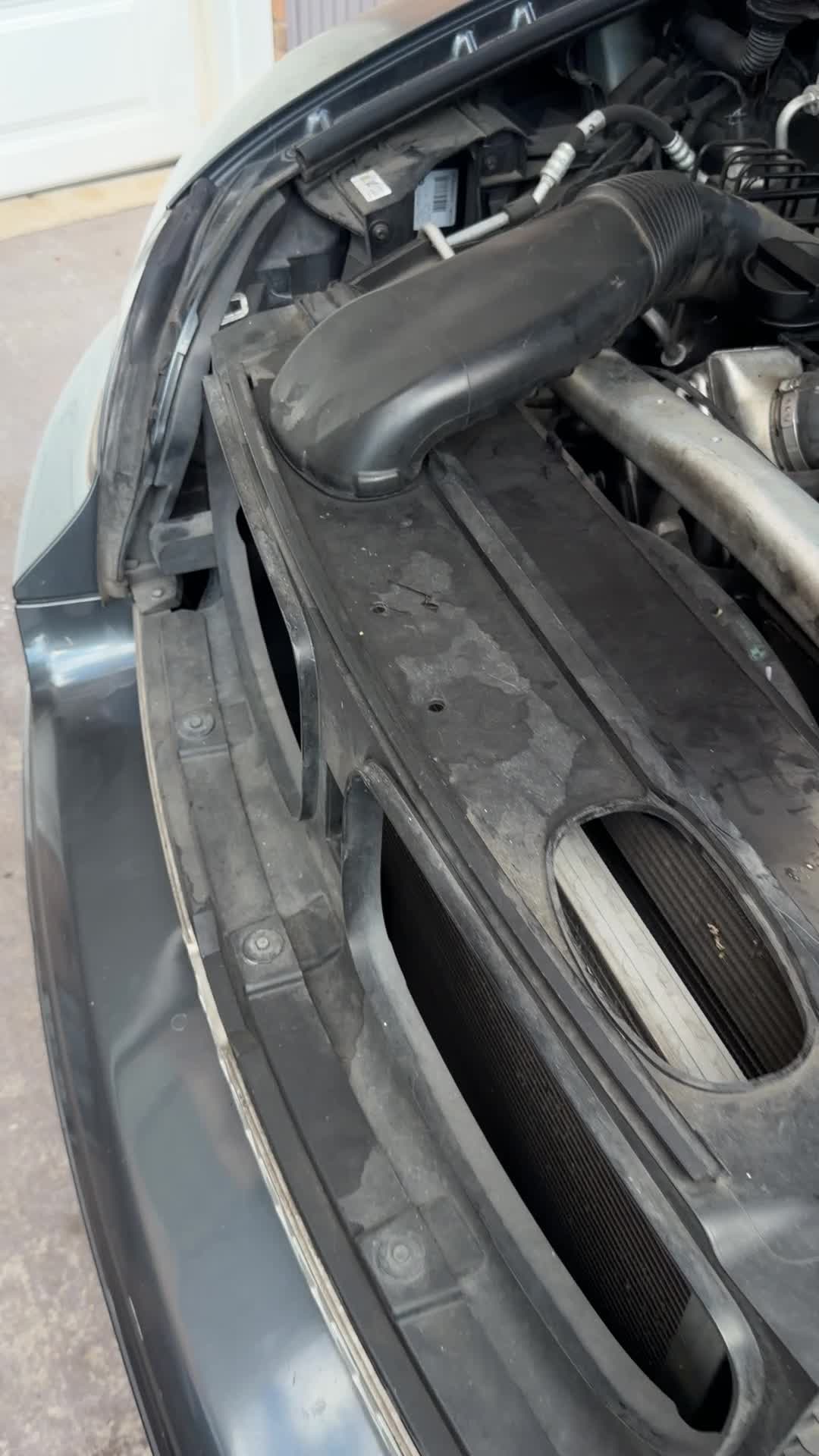

Some videos. Drove it in front of my home after deleting the code and it drove nice and strong. It randomly does it sometimes after 3-4 minutes sometimes 30 seconds after start

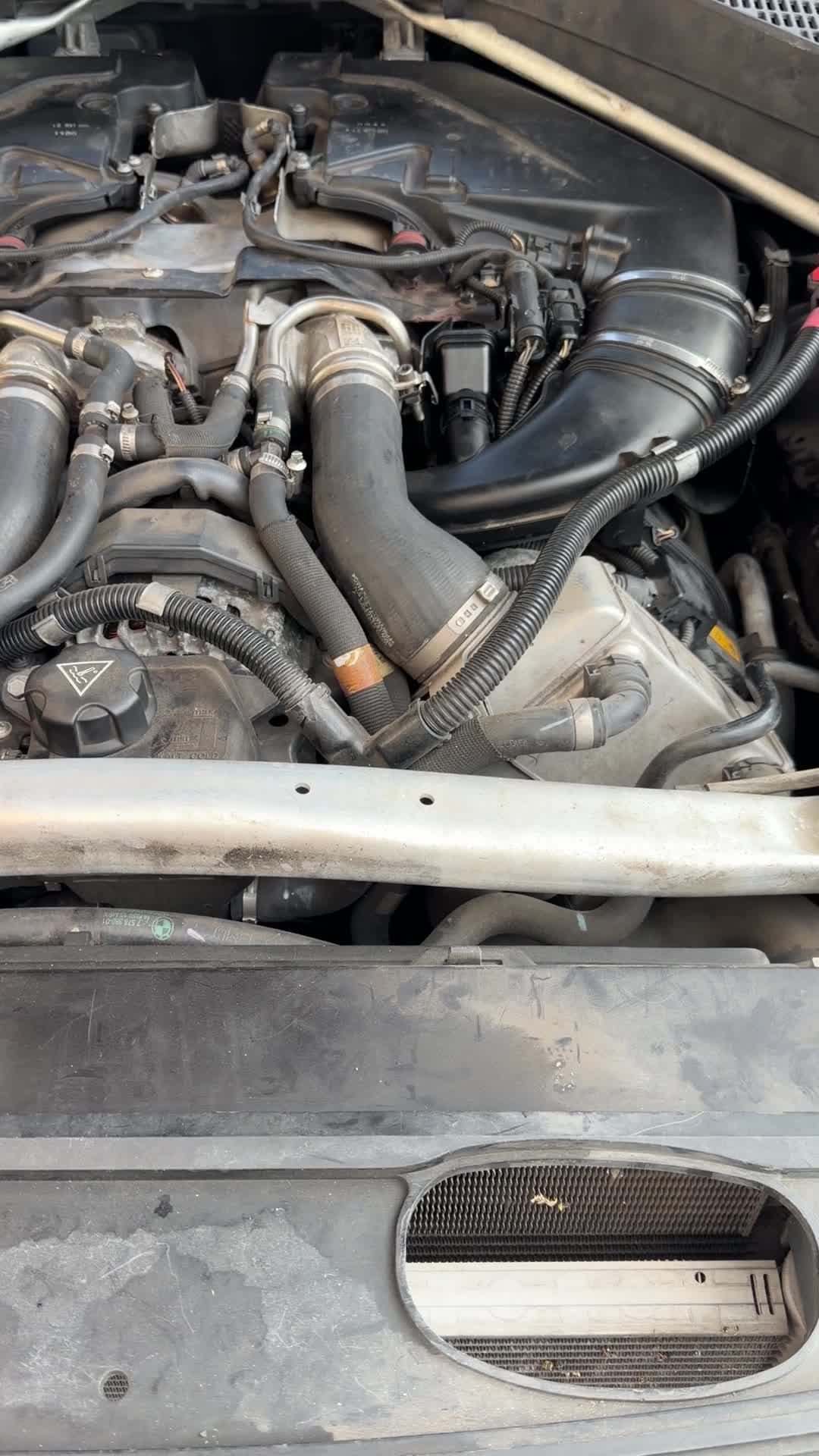

You have found the problem, when you release the oil cap, the vacuum is too high, this is because the check valve for the Positive Crankcase Ventilation system is blown. This will cause the misfire codes. Here is the part you need to replace to fix the issue.

These engine have an internal crankcase vapor control diaphragm at the front of the engine that sounds like it is blown. This will create the vacuum inside the engine like you have.

kept it running 20 minutes till fully warm, then once you rev it the motor to 2500 rpm it misfires, same codes, cyl 3 and 5. No those v8 engines only have those PCV, the ones on front of engine on valve covers are usually on the inline 6 engines
Oct 12, 2026 at 4:18 PM
  • 55,691 POSTS
Hmm,, that vacuum when you remove the oil fill cap is the issue. We need to figure out where it is coming from.
