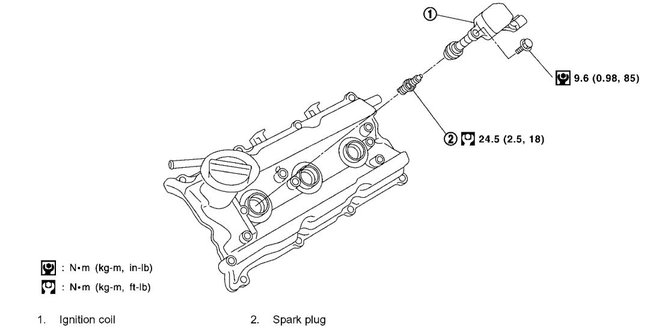

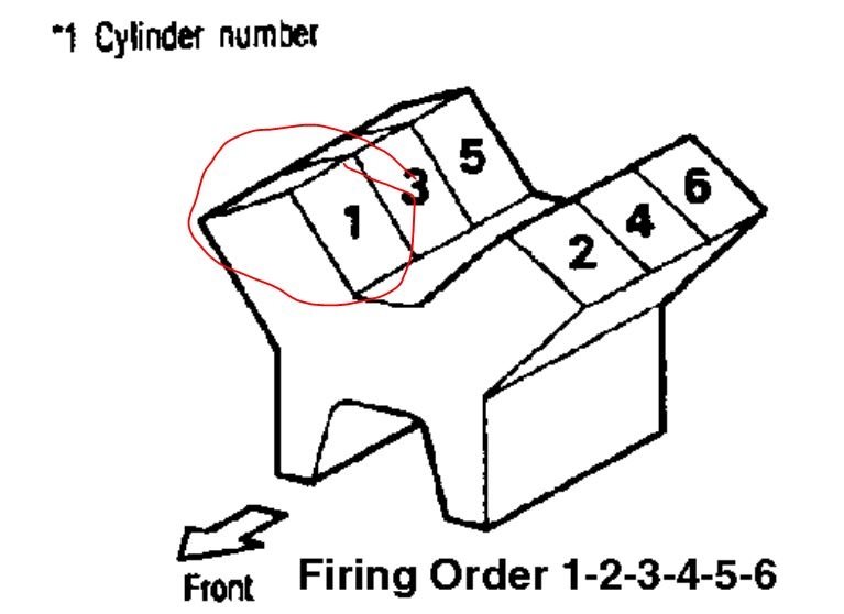

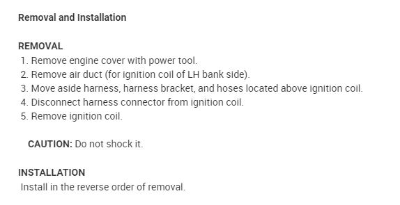

Misfire code. Is the number 1 coil located on the front of passenger side when standing in front of the car?
Mar 9, 2020 at 1:54 AM
Good afternoon,
I attached the diagram for you. It is on the left front if you are standing in front of the car.
