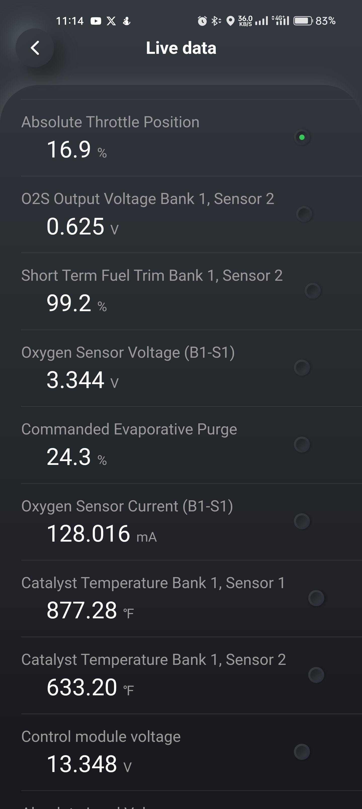

Short term fuel trim bank 1 is 0.8 %
Short term fuel bank 1 sensor 2 is 99.2 %
Oct 30, 2023 at 4:16 AM
  • 110,194 POSTS

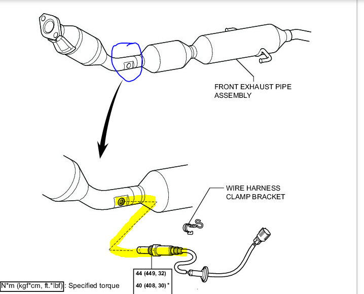

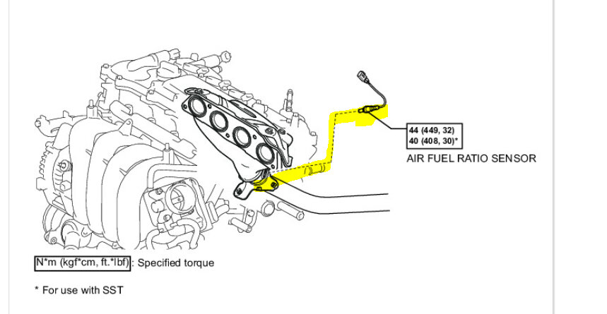

If sensor 2 is at 99.2%, either we have low fuel pressure, a rather large vacuum leak, or the sensor is faulty.
Since you have a live data scan tool, watch the voltage signals from B1S2. It should adjust itself between 0.1 and 1.0V. If you notice no change in the voltage, replace the sensor. It is the likely issue. However, also confirm there isn't a wiring or connector issue.
Let me know what I can do to help.

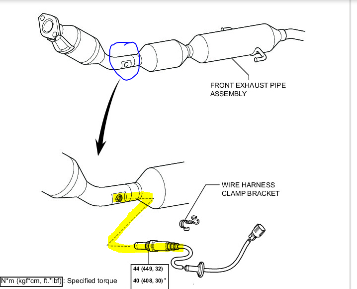

See pics below. Note: B1S2 is after the catalytic converter. I attached pics showing both sensors. The air/fuel sensor is sensor 1 (pic 1). The heated O2 sensor is in pic 2 below.

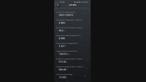

I don't think the B1S2 is faulty, the reading is normal. I will send you a video recorded from the live data.

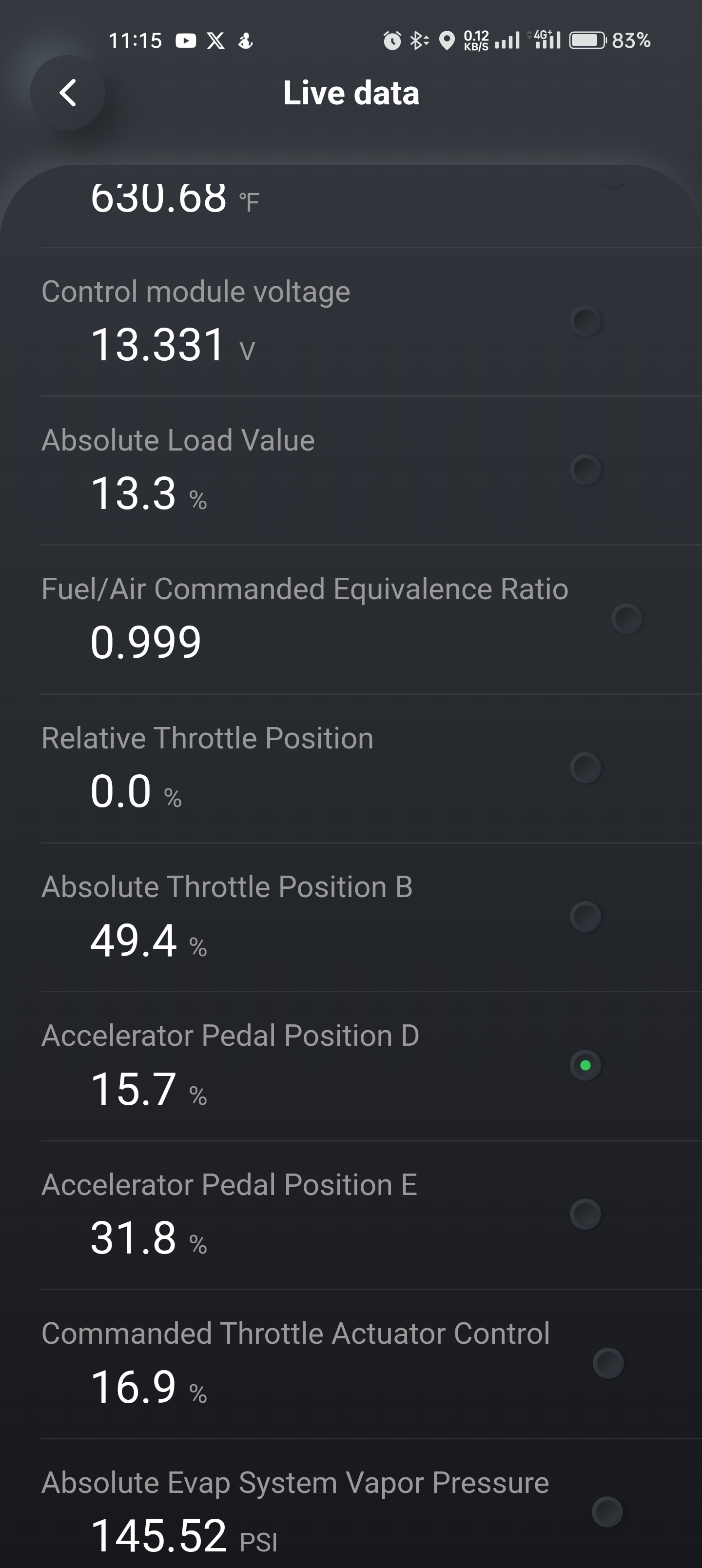

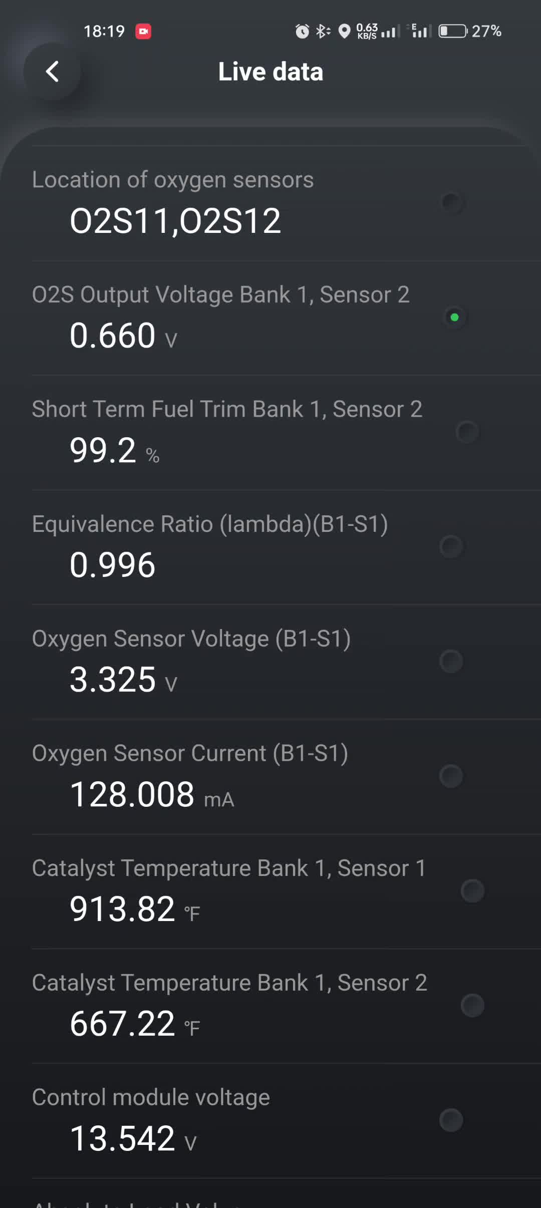

HABIB2022
  • 10 POSTS
Take a look!
Oct 31, 2023 at 1:06 PM

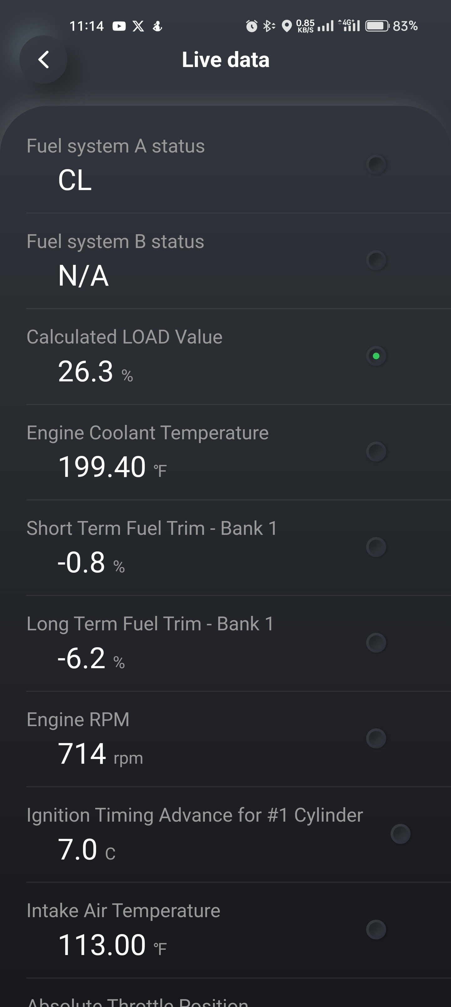

HABIB2022
  • 10 POSTS
Here are some screenshots.
Oct 31, 2023 at 1:09 PM
  • 110,194 POSTS
I watched the video. The STFT shows 99.2%. That usually indicates the fuel trim isn't being used. Was the engine at operating temperature?
The voltages are within spec for sensor 2. Sensor 1 is higher than expected, but if the vehicle was cold, that could be a reflection of a rich air/fuel mixture.
Oct 31, 2023 at 7:04 PM

HABIB2022
  • 10 POSTS
What do you think about the reading voltage of O2 sensor B1S1?
It's always above 3 volt!!!!!
Nov 1, 2023 at 4:50 AM
HABIB2022
  • 10 POSTS
What's the voltage range reading of O2 sensor B1S1 in Toyota Corolla 2013?
Nov 1, 2023 at 5:39 AM

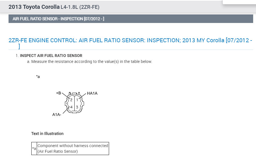

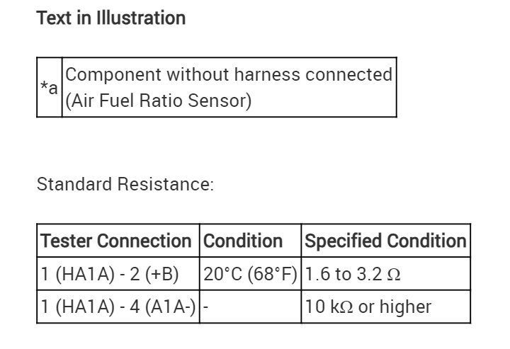

  • 110,194 POSTS
Normally, the voltages should range between 0.1 and 1.0v. However, although 3v is high, it isn't uncommon. Especially if the engine is cold. That's why I asked.
As far as testing is concerned, the manufacturer doesn't provide a voltage reference point. Instead, they want you to check the resistance in the sensor itself.
I attached those directions below.
See pics below. I never confirmed if this is a 1.8L or a 2.0L. Also, the information provided below is bank 1 sensor 1. Your crazy readings are for sensor 2. Confirm the engine size for me.
