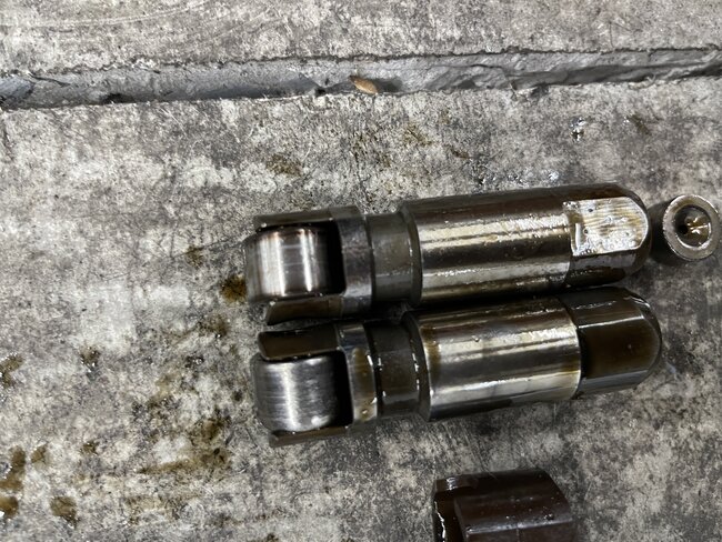

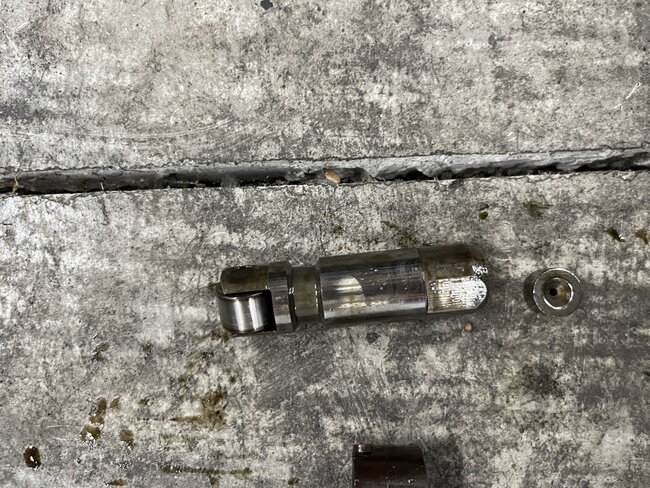

Yes, possible that the noise was worse, so they left the rod out. Anyways, just removed the head to find out that the same cylinder has one bad lifter, cam looks good. Also found that the cap that goes on the end of the other lifter, which has the missing rod is just lying there. So weird, never see that before. And guessing having no rod she popped off, but i see the others actually have a snap ring, so heck i don't know where that is, I'll look further maybe i will find it. I will order 2 lifters.

Here
Mar 13, 2023 at 10:17 AM
  • 110,248 POSTS
Wow. I guess if the lifter was totally collapsed, the pushrod could have come out, but that is an odd one. I don't remember seeing that happen in the past. I've seen bent ones, but not this.
Let me know how things turn out when the parts arrive. Also, let me know if I can help in any way.
Take care and thank you for the update. It's appreciated.

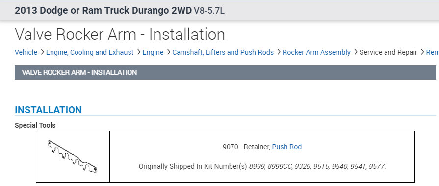

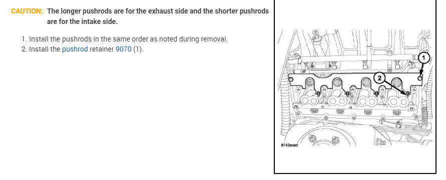

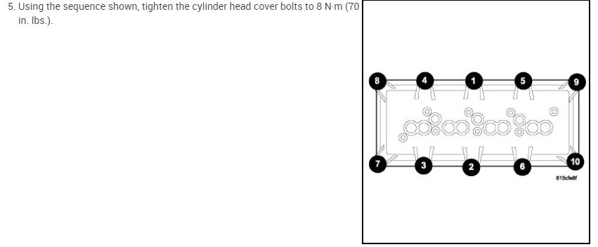

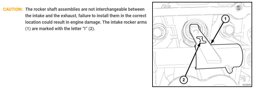

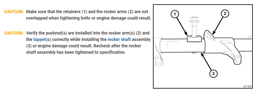

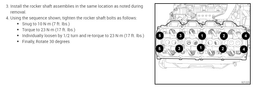

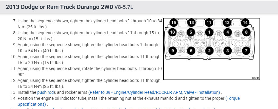

What is the torque spec for the head bolt as well as the 10 mm bolts on the head by intake please. Also, the torque for the rocker arm assembly bolts.
Mar 16, 2023 at 9:06 AM
  • 110,248 POSTS

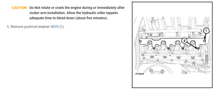

If you look at pic 1, it provides the torque specs and sequence. Note there are several steps that need to be performed when doing this. Follow them as closely as possible.
The remaining pics are the directions and cautions for replacing the rocker assembly. The torque specs and procedures are included.
The very last pic is for the valve cover. I figured you may need that as well.
