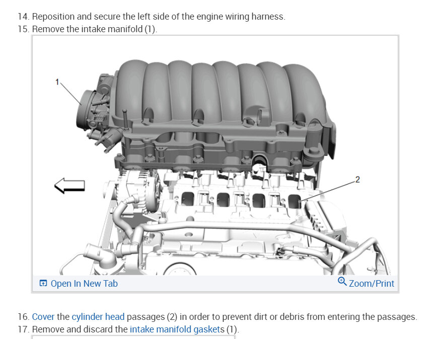

For the misfire. I have a code showing for cylinder 5 misfire. Changed the plugs and I changed the number coil pack and still having misfire. You can't notice it unless it's at idle or speeds below 40. No taping or ticking noises, just a rough shake. Before I spend more money on things that don't work, I need directions about what to do next. Also, the back air isn't working. I need some direction. I just bought it and didn't realize it has these problems and now I'm wanting to pull my hair out. Please help. Thank you !

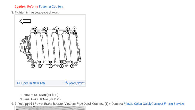

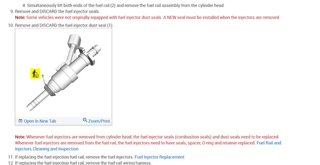

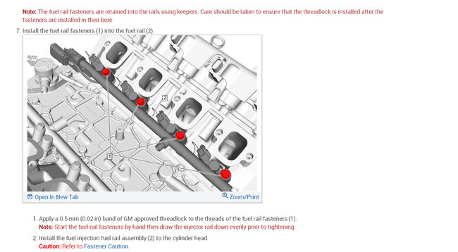

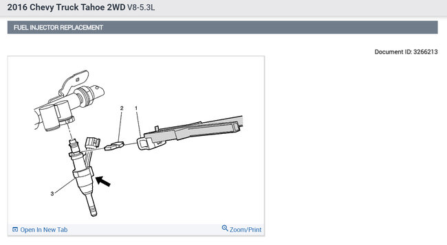

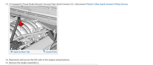

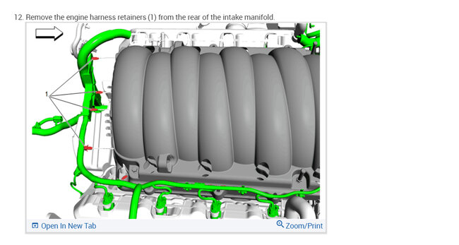

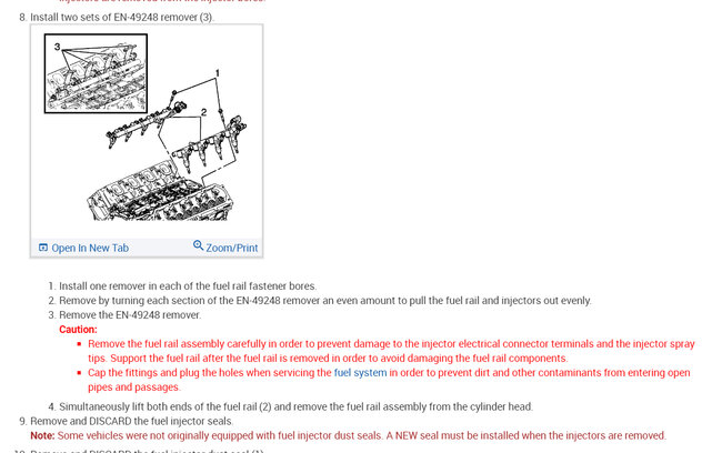

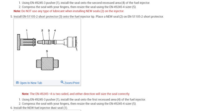

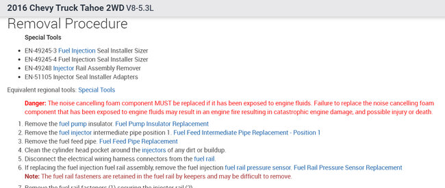

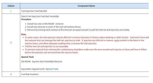

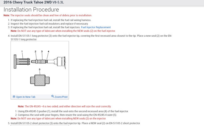

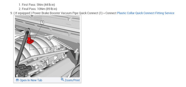

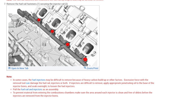

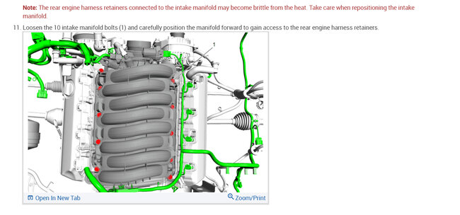

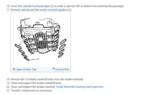

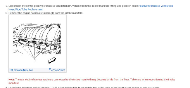

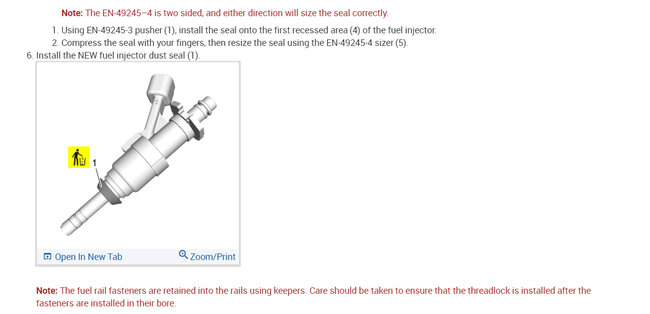

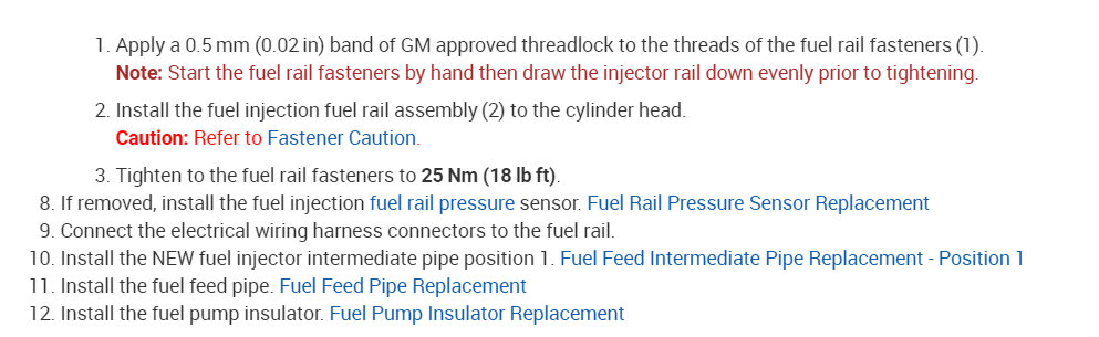

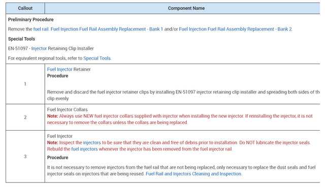

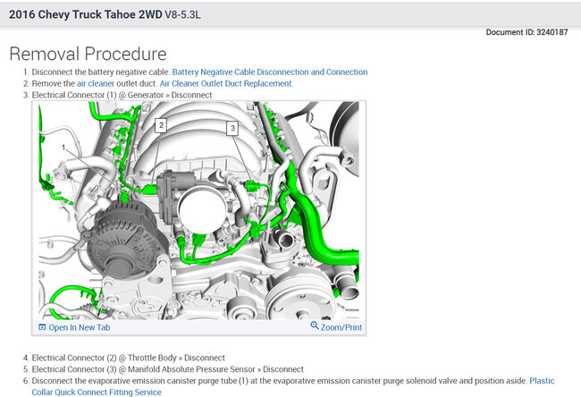

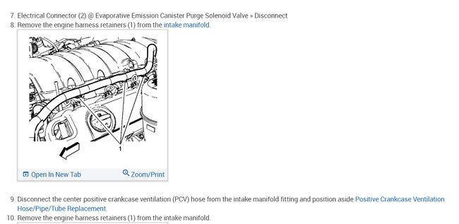

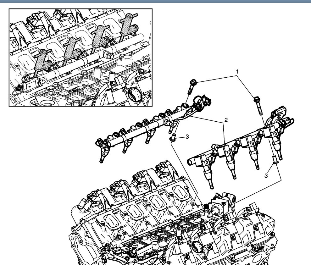

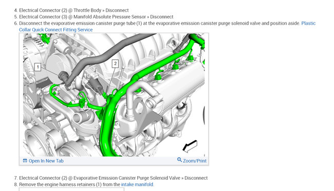

We only handle one problem per thread. We need to remove the spark plug to see what it looks like, if it is clean or like new there is no fuel getting into the cylinder and the fuel injector needs to be changes out here is the instructions so help you do the job and I have included this guide which may help as well.
You will need to remove the intake manifold which I have included instructions on as well. Check out the images (below). Let us know what happens and please upload pictures or videos of the problem so we can see what's going on.

Yep, it sounds like a bad/weak fuel injector, if it was not firing you would have raw fuel on the spark plug.
