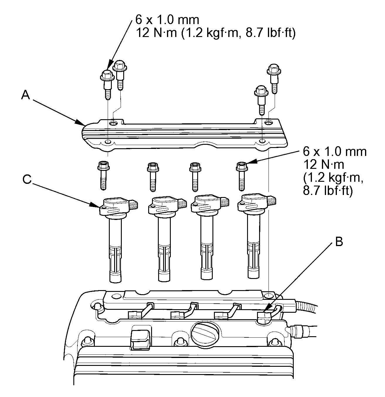

My car turns on and goes in gear but no acceleration, wouldn’t pass 3,000 RPM's at first with minimal acceleration. Up to 60 MPH.
Got codes: P0303, P0341, P1000.
Any suggestions? What should I do?

The P1000 is likely the result of clearing codes or disconnecting the battery. That leaves us with the other two.
I need to clarify something. You mentioned the clutch. Does it seem to be slipping? In other words, the engine revs but the vehicle doesn't accelerate.
Have you pulled the number 3 spark plug to check it?
_______________
In all honesty, I suspect the misfire (p0303) which is causing the loss of power is likely related to the camshaft position sensor. However, I would pull the spark plug to inspect it. Also, you will need to remove the coil pack to that cylinder to access the plug. Do me a favor. Switch cylinder 3 coil pack with one of the others so we can check if the misfire changes cylinders. If it does, then we know the coil is bad.
Here are the directions. If possible, take a pic of the spark plug end from cylinder 3 and upload it for me to see. The attached pic correlates with these directions. Also note the directions are for all cylinders. In this case, we only need to remove the number 3 plug.

REMOVAL AND REPLACEMENT
Ignition Coil and Spark Plug Removal/Installation
1. Remove the ignition coil cover (A).
pic 1
2. Disconnect the ignition coil connectors (B), then remove the ignition coils (C).
3. Remove the spark plug and inspect them See: Spark Plug > Component Tests and General Diagnostics.
4. Apply a small amount of anti-seize compound to the plugs into the cylinder head, finger tight. Toque them to 18 Nm (1.8 kg-m, 13 lb-ft).
5. Install the ignition coils, then connect the ignition coil connectors.
6. Install the ignition coil cover.
