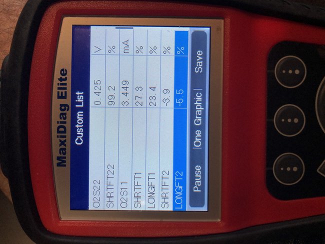

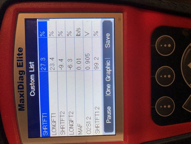

I just rechecked the compression and its 130 or so on all. when first started in the am mo clutch bearing sound and the car is 95% smooth and very minor misfire. here are the fuel trim numbers. I will report with the numbers again after she starts to misfire while idling, am starting to think maybe the injector? 72,000 miles though that usually isn't an issue.

Still no major misfire but here are the readings when warm:

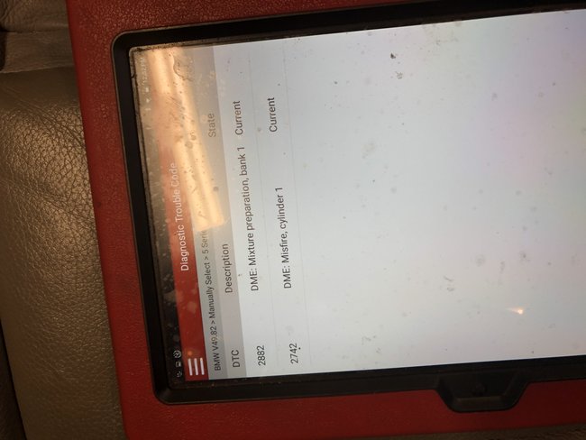

Found this to not sure what it means. after i switched over injector 1 to 2, swapped, waiting to see if she will set the same code as cylinder one, once warm.

Sane code again number 1 but with number 2742.
Oct 17, 2019 at 7:14 AM

Bank 1 is overcompensating for a lean mixture. What all have done to check for a vacuum leak? Are you certain there are no exhaust leaks pre cat on bank 1.

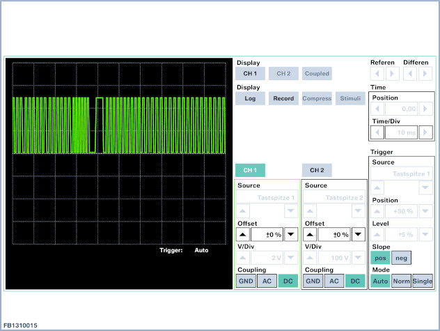

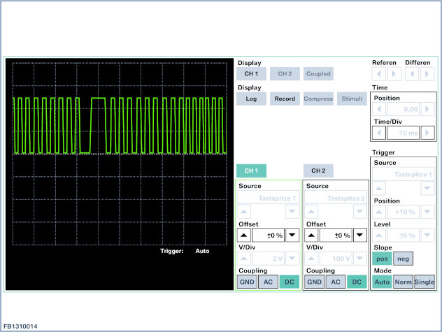

You know, and this is a long shot, I wonder if the noise is causing an issue with the crankshaft position sensor., Think about it, if it is banging on the crankshaft via the clutch, it could be causing an erratic signal from the sensor. I have no idea if you have an oscilloscope to test the signal from the sensor. However, if you do, here are the directions and what you should expect to see. I have no idea how bad the knock is you hear, but it could even be related to the crankshaft thrust bearings which commonly wear out faster with a manual transmission. In addition to the test below, check the crankshaft at the harmonic balancer for excessive end play.
Here are the directions I mentioned. The attached pics correlate with the directions.
__________________________
2004 BMW 525 (E60) L6-2.5L (M54)
Set Oscilloscope Display Crankshaft Sensor [FUB-SOW-FIN0201SO47TU001 - V.4]
Vehicle Powertrain Management Sensors and Switches - Powertrain Management Sensors and Switches - Computers and Control Systems Crankshaft Position Sensor Testing and Inspection Oscilloscope Patterns and Waveforms Set Oscilloscope Display Crankshaft Sensor [FUB-SOW-FIN0201SO47TU001 - V.4]
SET OSCILLOSCOPE DISPLAY CRANKSHAFT SENSOR [FUB-SOW-FIN0201SO47TU001 - V.4]
Functional description
Set oscilloscope display crankshaft sensor
Signal at idle:
Pic 1
Signal at starting speed:
pic 2
Let me know what you find

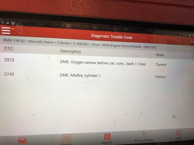

Car acting crazy, after i installed the injectors back it runs the same, but i have an o2 code now.
Oct 19, 2019 at 3:47 AM
NASER NASER
  • 836 POSTS
And sometimes these codes:
Oct 19, 2019 at 3:57 AM
  • 110,248 POSTS
Welcome back:
The codes indicate a misfire and an issue with fuel mixture. Are you sure the O2 sensor is properly installed and the connection is proper? Was it a bank one sensor? Can you provide me the short term fuel trims so I can see what is happening?

They just gave me a sheet with couple of things, dme: misfire cylinder 1, and dme: fuel trim, bank 1, both present.
Oct 24, 2019 at 4:13 AM

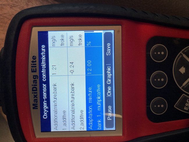

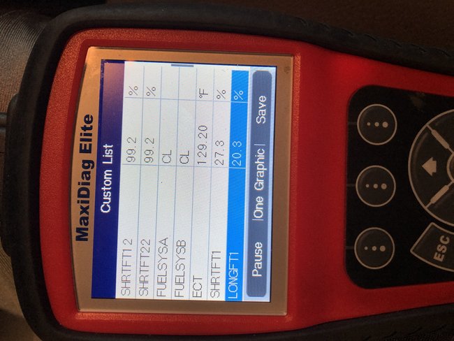

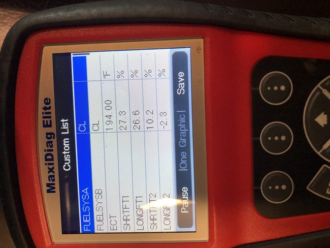

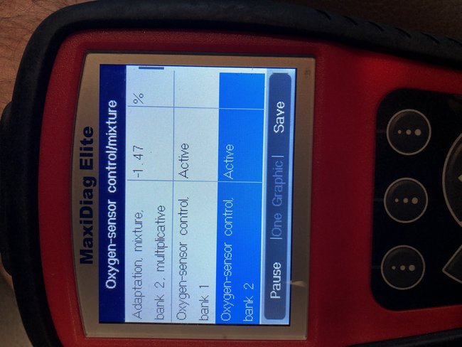

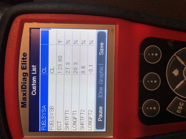

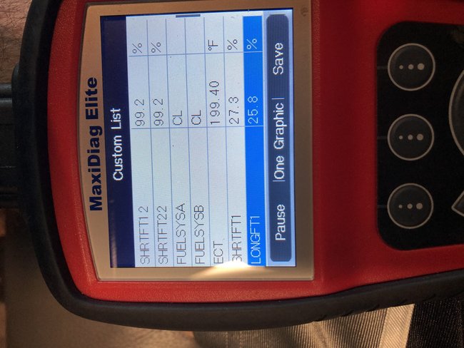

Here are the numbers you requested and more, at optimal engine temperature.
Oct 30, 2019 at 1:47 AM
NASER NASER
  • 836 POSTS

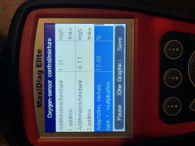

Attached.
Oct 30, 2019 at 1:49 AM
  • 110,248 POSTS
Welcome back:
The computer is trying to adjust bank 1 to compensate for a lean mixture. The STFT should be close to 0 and the positive (high) number indicates it's allowing the injectors to stay open much longer than normal which is most likely the cause of issues on bank 1. Are you certain there are no vacuum leaks or even an exhaust leak pre catalytic converter?

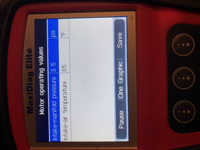

NASER NASER
  • 836 POSTS

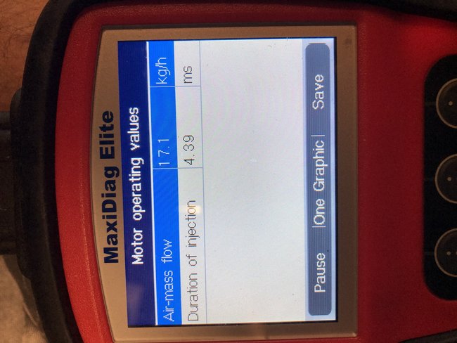

Nothing. If i remove the harness to the MAF sensor i saw a code for it plus one for the intake air temperature sensor, but i don't have one on this engine. Cleaned the MAF and put it back and plugged it. Do these readings look right? The engine is up to normal temperate. Also after clearing the codes i have none now but the oxygen sensor before catalytic converter bank 1 code is present.
Oct 31, 2019 at 12:38 AM

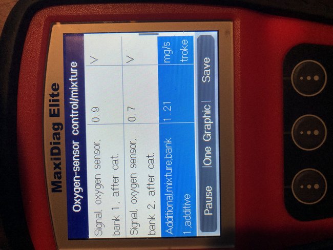

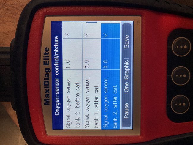

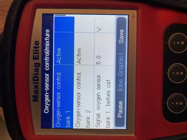

And i just checked the values on the oxygen sensors. do these look right?
Oct 31, 2019 at 12:53 AM
  • 110,248 POSTS
Welcome back:
It is based on how long the vehicle was running. They can go up to about .9v with a rich mixture when cold but should level out to aprox .45v when at operating temp.
So, one of the pics is higher than the other. If that was before warm up, no problem. The other is really close to normal, which should be after warmed up.
I hope this helps.
Oct 31, 2019 at 12:40 PM

As i indicated the engine was fully warm. i also noticed that one at 4.5v and the graph also shows that it sometimes move and others its solid line.

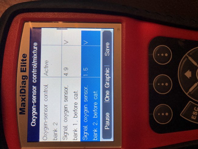

NASER NASER
  • 836 POSTS
replaced the bank 1 before cat oxygen sensor and now reads 1.3 just like bank 2 before cat, and both after cat reading around .7, so far so good, crossing fingers, if that doesn't fix it i assume this was one of the issues, because the oxygen sensor is real black and was reding 4.5v all along, i just don't know why they reading 1.4 and not in the range of .1-.9 while warm.
Nov 1, 2019 at 7:04 AM
  • 110,248 POSTS
Welcome back:
It sounds like you found the problem. Let me know if things change.
