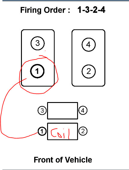

The P0301 is a cylinder 1 misfire. So, that will cause a power loss and allow raw fuel to enter the exhaust and could damage the converter.
When were the spark plugs last replaced? Do you know if the spark plugs were ever replaced?
Inspect the spark plug wire and the spark plug in the cylinder. Check the wire to make sure there is nothing damaged or shorting on it. Also, when you remove the spark plug, let me know what it looks like. If possible, take a pic of it and upload it so I can see it.
I attached a pic below, so you know which is cylinder 1.
See pic below.
