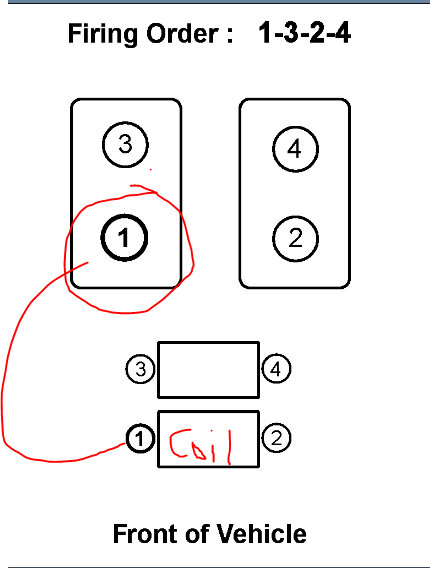

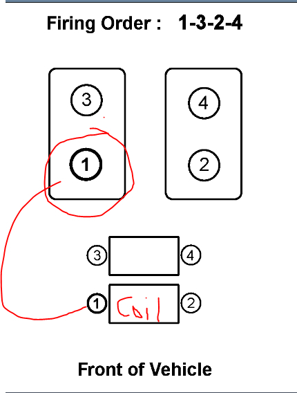

Inspect the spark plug wire and the spark plug in the cylinder. Check the wire to make sure there is nothing damaged or shorting on it. Also, when you remove the spark plug, let me know what it looks like. If possible, take a pic of it and upload it so I can see it.
I attached a pic below, so you know which is cylinder 1.
See pic below.
