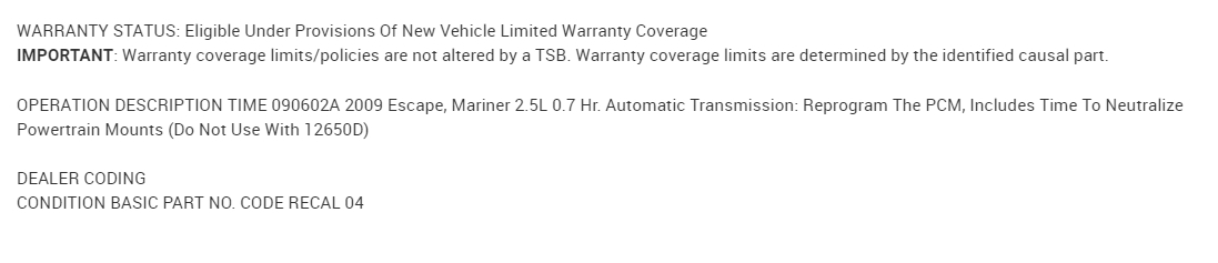

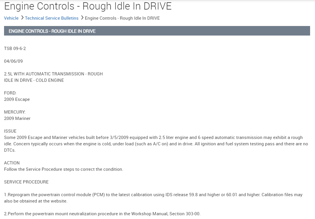

Hello, do you notice this misfire more under certain conditions, engine cold, under a load such as getting on the highway, etc? Have you had the engine computer scanned for misfire or any other diagnostic trouble codes? Do you think this is more rough running in drive than in neutral? And one last question, have you taken a look at the throttle body opening for carbon build up on the throttle plates? Just asking because there is a Technical Service Bulletin (TSB) on an ECM update for throttle body contamination. Another TSB on rough engine idle in Drive which may be worse with the a/c on due to load and cold engine. This is where there are no faults found with the Ignition System or Fuel related issue. I'll post both of those below in a few minutes.
