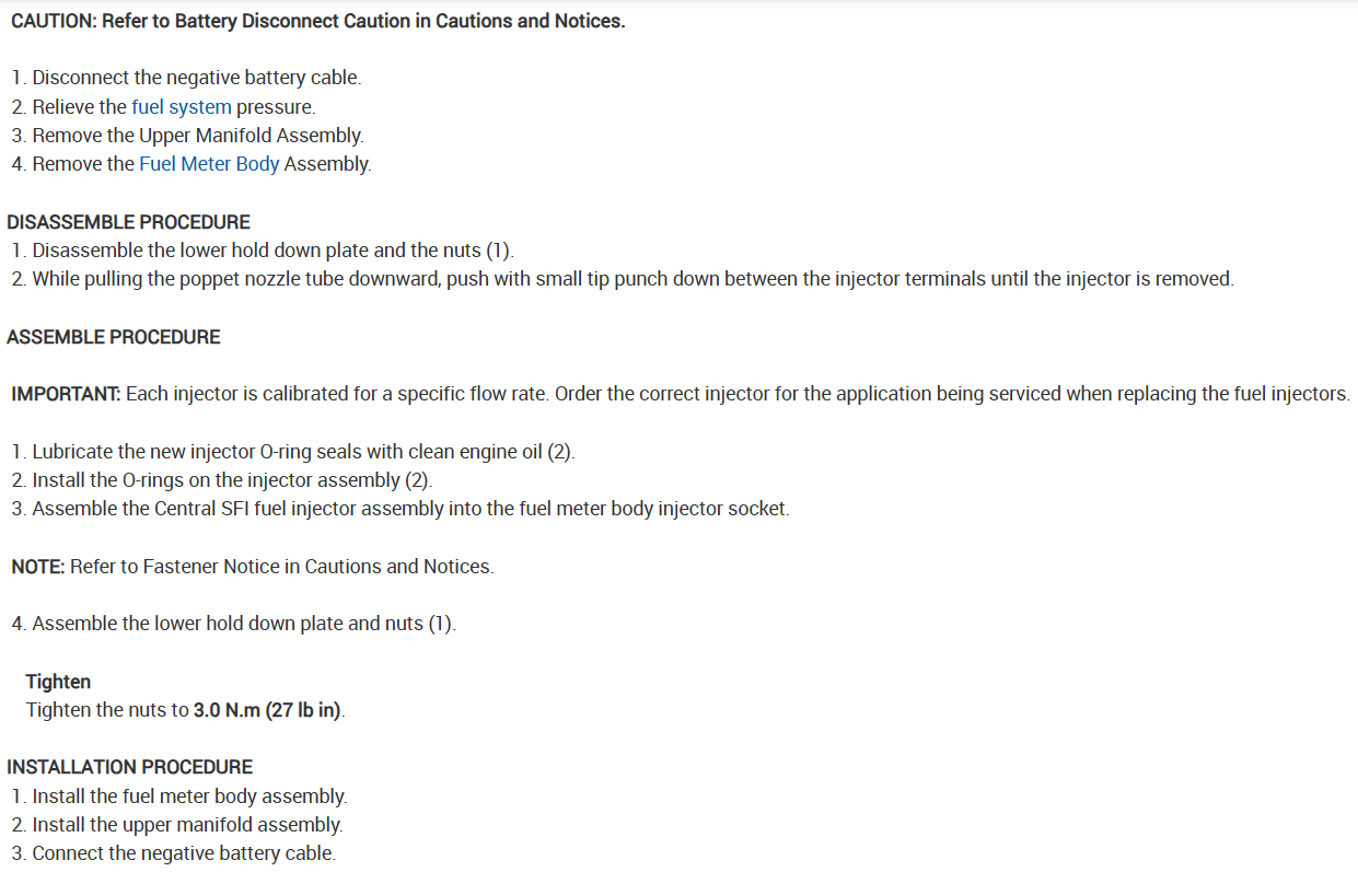

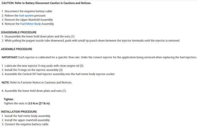

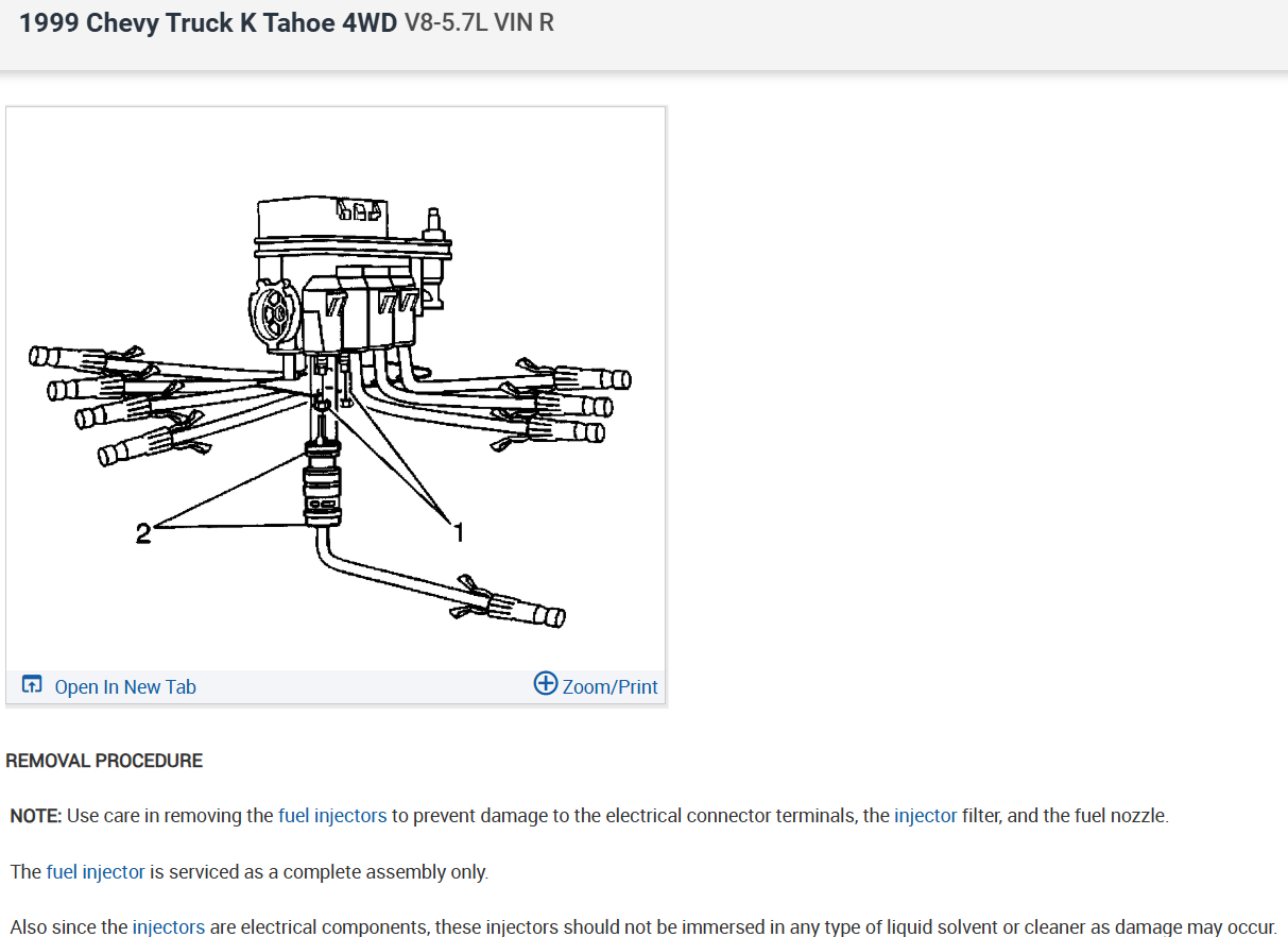

where are the fuel injectors located on this vehicle and how to test them?
Mar 11, 2025 at 4:25 PM
  • 55,710 POSTS
So the fuel injectors are inside the intake manifold. It is called a "spider injector" which they had problems, with, I would do the compression test first to make sure the engine is okay. And if so, replace the injector, does the #5 cylinder make a ticking noise while at idle? If so, you may have a flat camshaft.
Here is a guide on how to test the fuel injectors:
https://www.2carpros.com/articles/how-to-test-a-fuel-injector
Check out the images (below).
