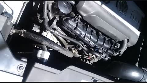

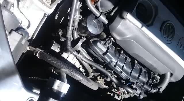

The vehicle listed above has a TSI engine with 119,665 Km. the vehicle had the codes above. The spark plug was change, coil, injectors, PCV valve, intake manifold, oxygen sensors, catalytic converter, carbon clean the problem still persist.
Compression test was done, low compression was found in cylinder 3 and 4
The engine was rebuild and the problem still persist.
Anyone had a similar problem I really need some help here,the technician who work on it work at the dealer and don’t know what next to do, so my options are limited.

Have you confirmed the compression is correct on cylinder 4 after the engine was rebuilt? Also, it is hard to tell in the video but is the smoke dark in color or black?

The mechanic still has the car so I don’t know if the low compression was corrected after the rebuild. Will try to contact him later.There was grey smoke coming from the exhaust.
Jun 11, 2020 at 9:22 PM
Okay, grey/black exhaust is excessive fuel so that would tell us that the codes for too rich points to a mechanical issue and most likely not a wiring issue with the control module or sensor. Let us know about the compression when you find out and we can hopefully figure this out. Thanks
