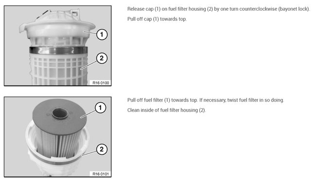

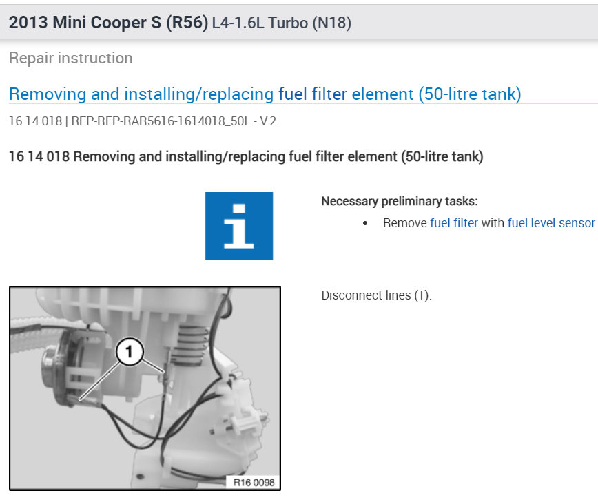

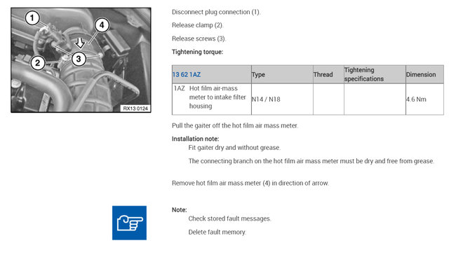

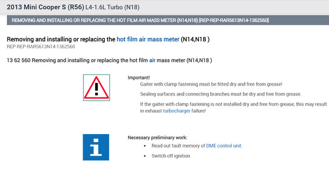

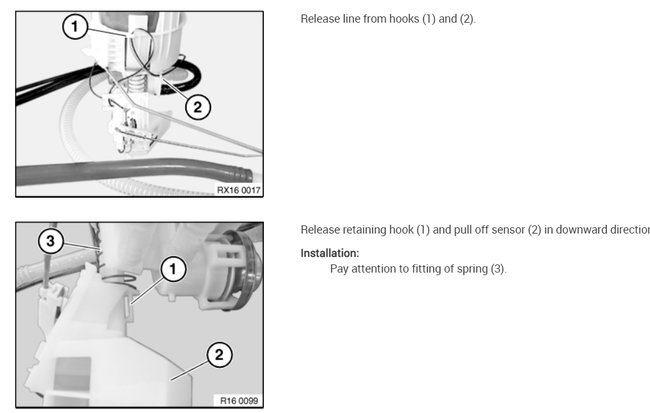

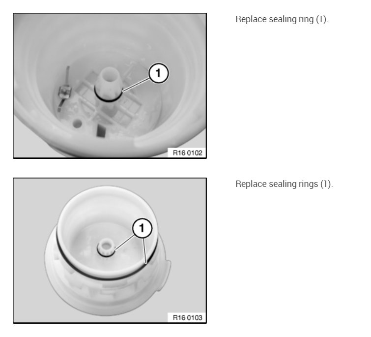

This can either be a dirty or worn out MAF sensor or the fuel filter getting plugged up which is in the tank. You can try to clean the MAF but that sometimes doesn't work here is a guide to help you also I have included the MAF location and how to change the fuel filter out.
https://www.2carpros.com/articles/mass-air-flow-service

You may have gotten a bad tank of gas which can take out the filter. Also, on the MAF sensor cleaning doesn't always work but it is worth a try, let me know.
