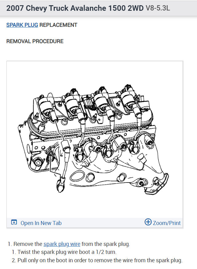

The code says cylinder 1 but it acts like if you took a wire off, shifts hard, and studders.
Dec 4, 2023 at 4:20 AM
  • 55,433 POSTS

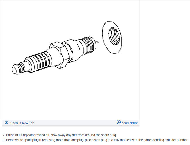

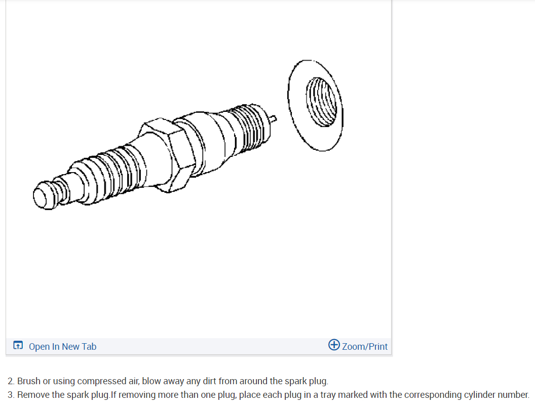

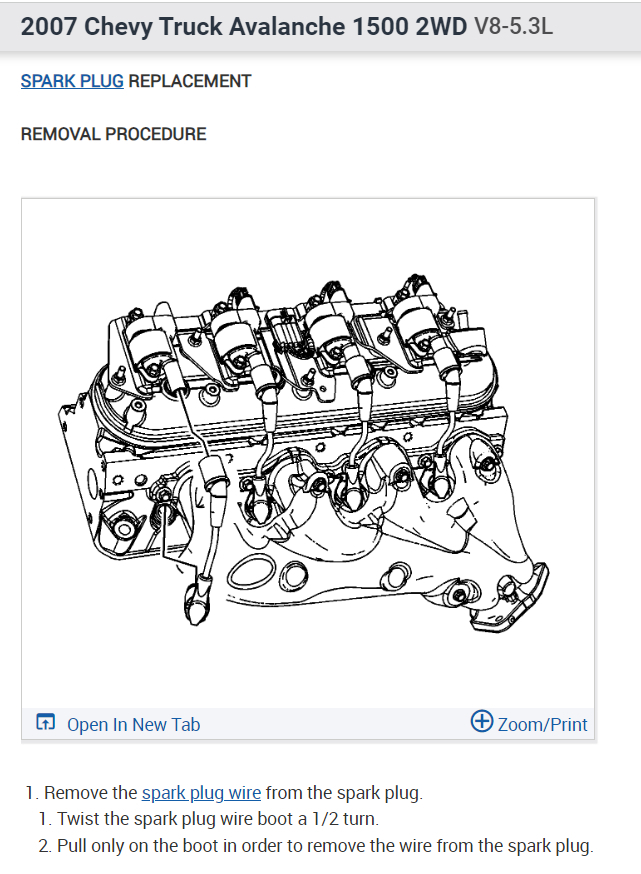

So, a misfire can be the spark plug, ignition coil/wire, a fuel injector or low compression. Let's remove the spark plug first for inspection, this guide can help, and I have included instructions in the images below that will help you on your car:
https://www.2carpros.com/articles/how-to-change-spark-plugs
This guide can help as well:
Please upload an image of the spark plug end so I can see it. Check out the images (below). Please let us know what happens.
