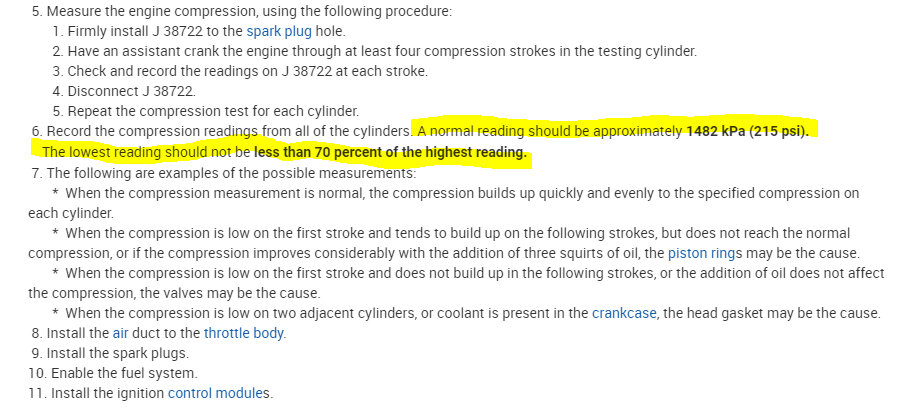

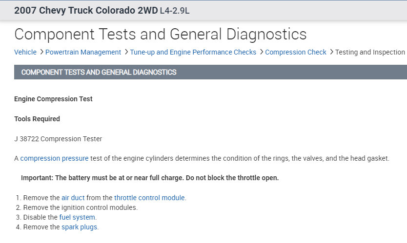

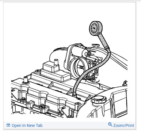

Also, here is what I feel needs to be done at this point: First, ask your mechanic if he has a borescope. If he does, have him check inside the cylinder for damage to the cylinder walls or evidence of any damage to the valves. If there is anything in there from the old spark plug, see if it can be removed with a magnet or even a vacuum supply via a pump and flexible vacuum hose.
If that can't be done, then the compression needs to be tested.
Here is a link that explains how it's done:
Below, I attached the directions specific to this vehicle. The expected compression is provided, and it indicates the lowest cylinder compression should not be less than 70% of the highest. If cylinder 2 is below that, try a wet compression test. Basically, put a small amount (about a tablespoon) of oil in the cylinder and recheck. If the compression increases, chances are the rings or cylinder walls are worn. If there is no change, it is likely a problem with a valve leaking.
