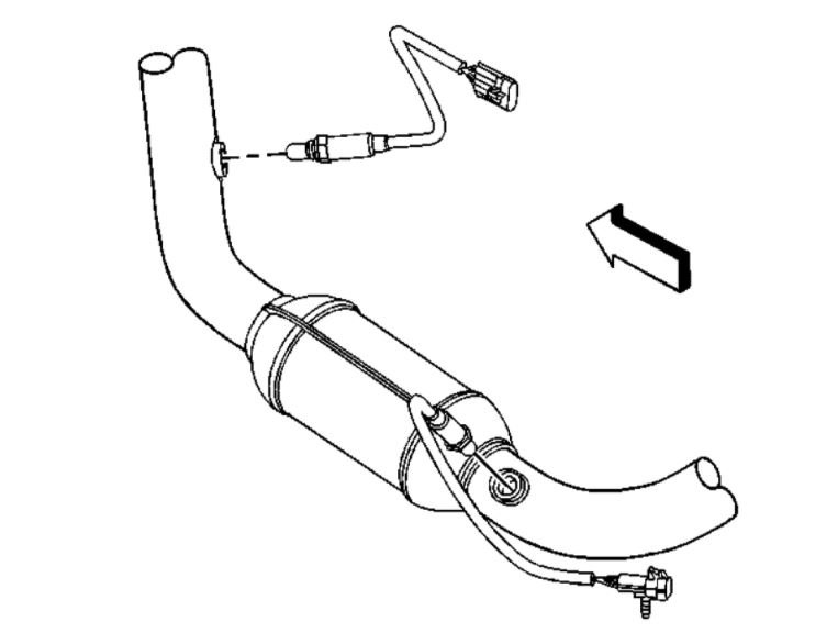

Misfire at idle once warmed up. Throws a code 420 for catalytic convertor. Catalytic convertor is 3 years old. No loss of power or gas mileage, no hesitation. New plugs, wires, computer flashed, o2 sensor are new. Also compression was good on cylinders. Originally had a code 300 but went away after replacing plugs and wires. checked catalytic convertor it was good. any ideas of what it could be?
Mar 11, 2021 at 8:14 AM
Good morning,
420 is bank 1 catalytic converter is no good. It is no longer processing the gases from the engine. It has to be replaced.
https://www.2carpros.com/articles/catalytic-converter-replacement
As far as the misfire, I would check the fuel pressure and make sure the pressure is correct. Low pressure is common for misfire and 300 codes.

Catalytic Converter Replacement
Removal Procedure
1. Raise and suitably support the vehicle.
2. If equipped, unclip the oxygen sensor connection from the floor reinforcement.
3. Disconnect the oxygen sensor electrical connector.
4. Remove the oxygen sensor clips from the frame.
5. Disconnect the connector position assurance (CPA) retainers.
6. Disconnect the oxygen sensor electrical connectors.
7. Unclip the oxygen sensors electrical connectors from the following:
- Hose clip
- Transmission crossmember

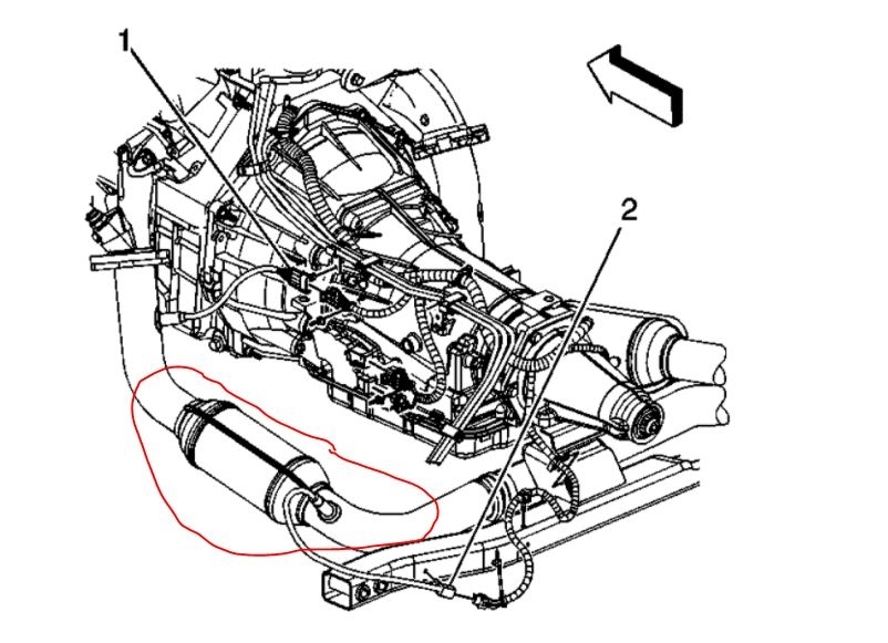

8. Disconnect the CPA retainers.
9. Disconnect the oxygen sensor electrical connectors (1, 2).

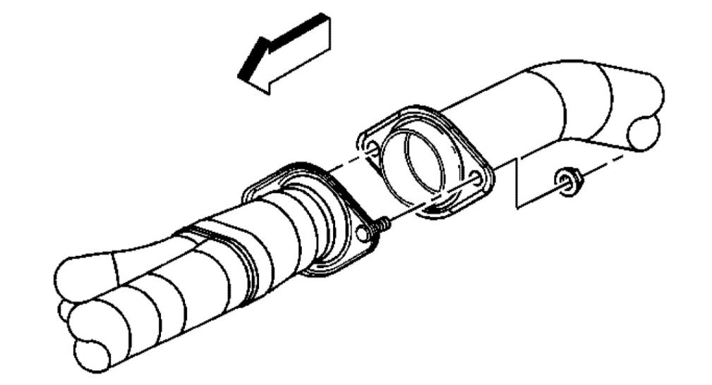

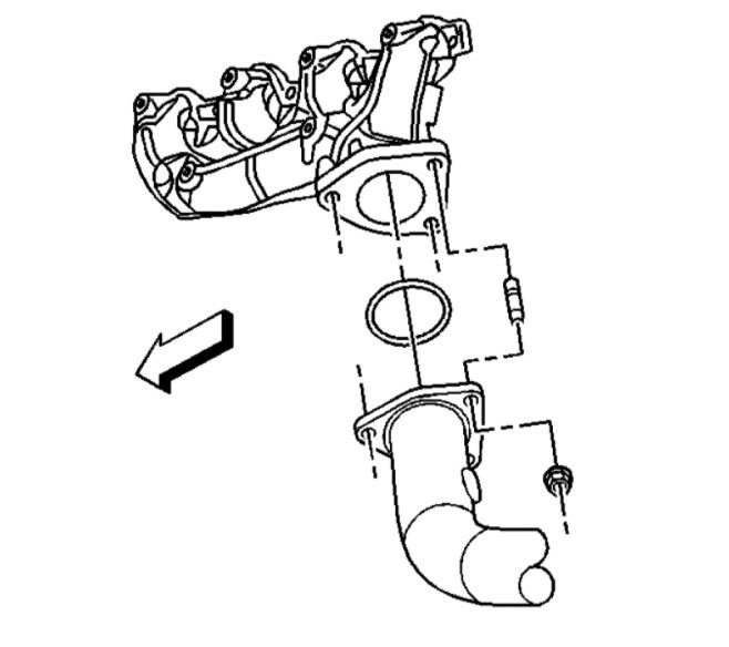

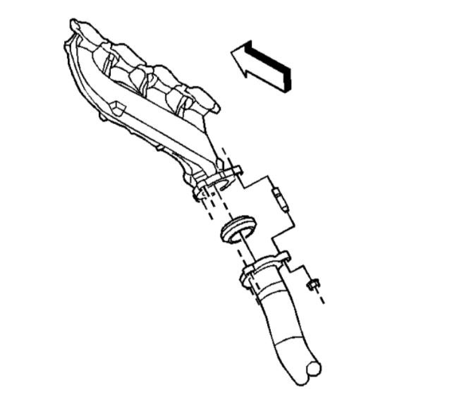

10. Remove the left exhaust manifold pipe nuts.
11. Remove the right exhaust manifold pipe nuts.
12. Remove the exhaust muffler nuts.
13. Remove the catalytic converter.
14. If necessary, remove the oxygen sensors.
