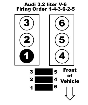

Misfire only cylinder 2 and 6 when you go above 4,000 RPMs and under load.

Are you using a diagnostic tool to check the misfire counters?
Have you tried replacing spark plugs and swapping ignition coils from okay cylinders, say 1+4, and then see if the misfire moves to the other cylinders?
See cylinder layout at bottom.
Also look at below link.
