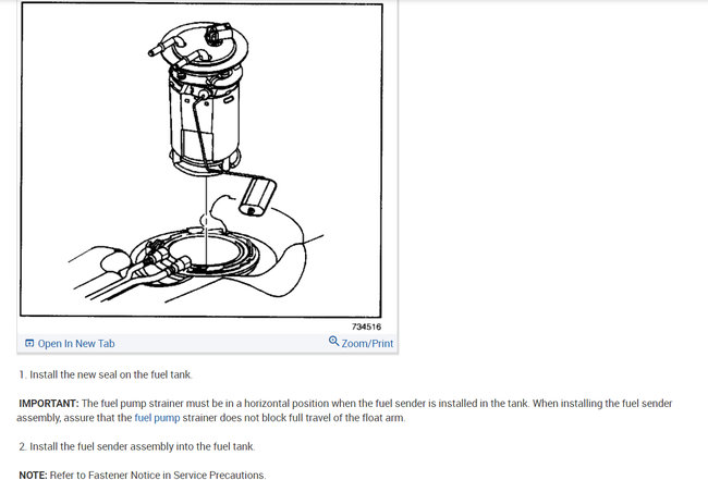

Good evening,
I would check the fuel pressure to be sure it is not low. Low pressure from a weak fuel pump will cause the misfire.
What was the compression? It needs to be 140-160 pounds.
