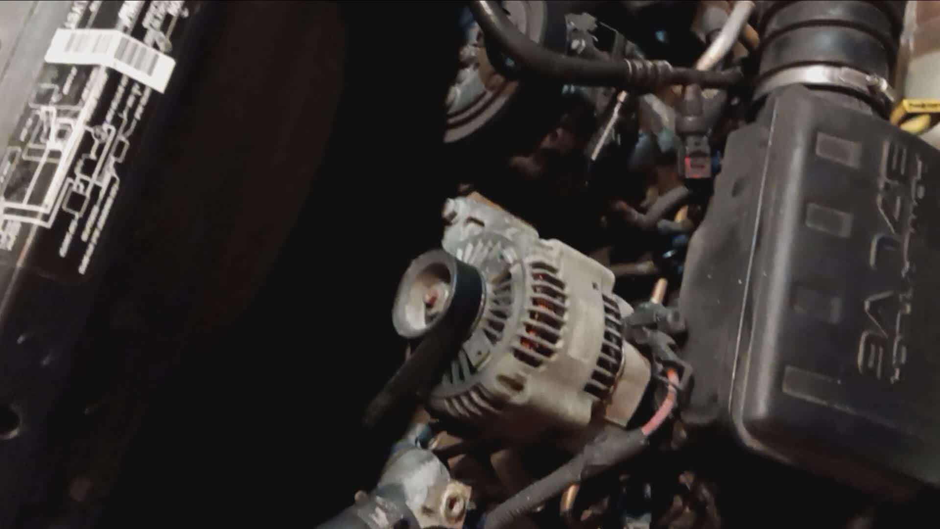

Misfire 6 I replaced all plugs and the #6 coil pack?
2002 JEEP LIBERTY
97,000 MILES • 3.7L • V6 • 2WD • AUTOMATIC
JUGGALO45
  • 88 POSTS
I have a few. 6misfire and i replaced all plugs and the #6 coil pack. Still have misfire 6 code. Also, when i go to start it there's a loud pop right away like possible solenoid from starter but it pops every now n then like something inside knocking around intermittingly. Misfire my main concern right now.

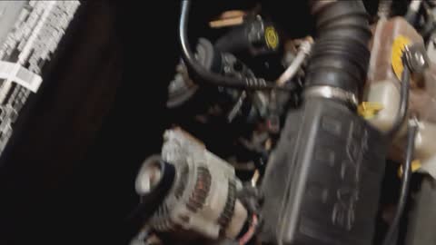

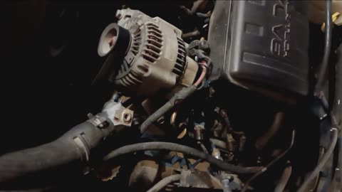

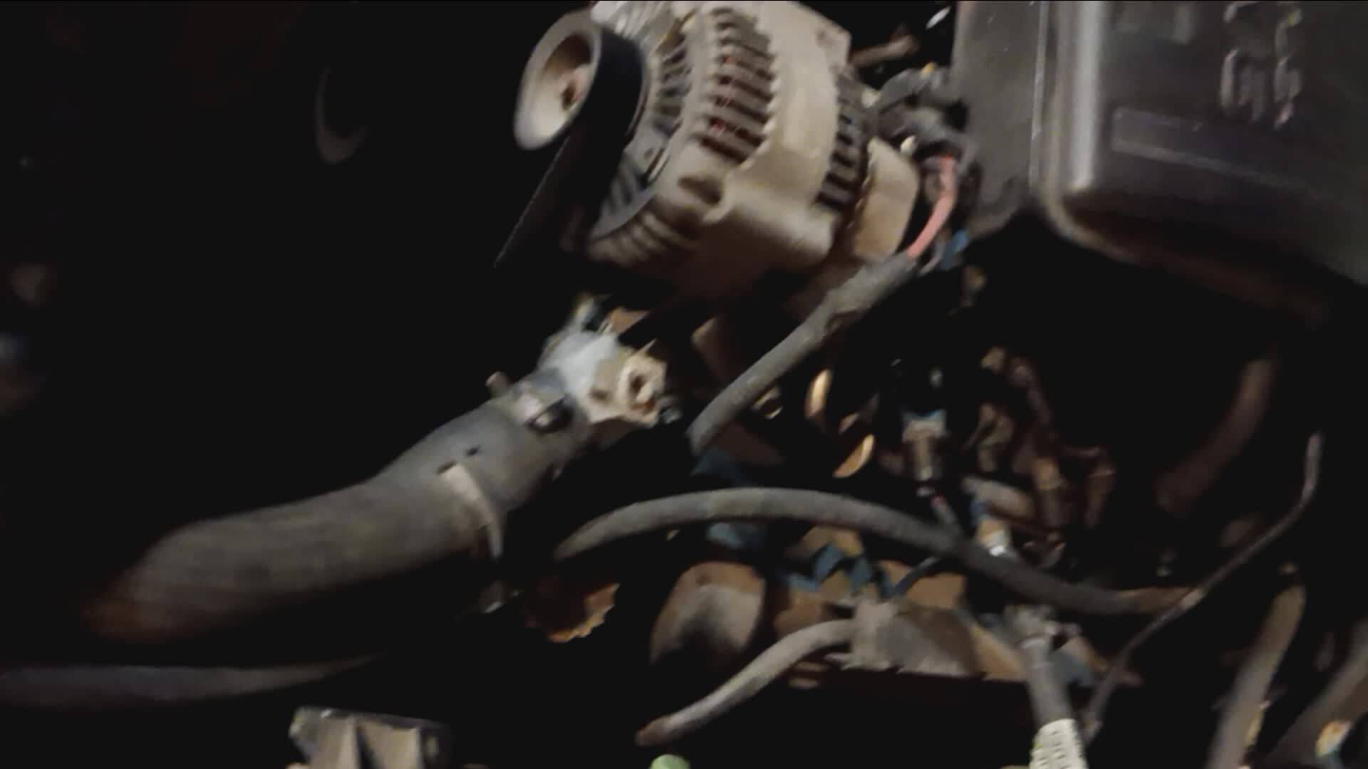

Heres a video of knock, listen close for knock, definitely hear the misfiring.
Feb 1, 2025 at 1:53 AM
JUGGALO45
  • 88 POSTS
And right at starting every time knock.
Feb 1, 2025 at 2:02 AM
  • 55,443 POSTS

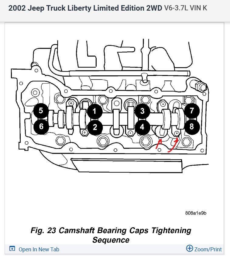

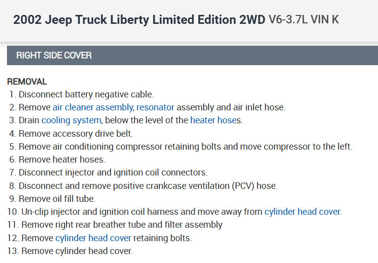

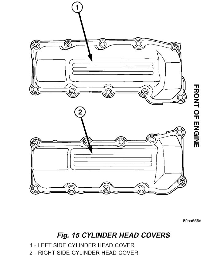

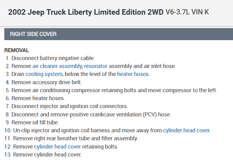

O ya, thanks for the videos they help. This engine had problems with the camshaft followers coming apart and causing the misfire and noise, I would remove the valve cover for inspection and confirmation of the problem. I have included the instructions on how to do so and what to look for. Check out the images (below). Please upload pictures or videos in your response of any problems so we can see what to help you with.
Feb 2, 2025 at 2:03 AM
STEVE W.
  • 15,355 POSTS
That is a very characteristic sound. The 3.7 has a couple of known issues and it sounds like yours is suffering from one of them. The 02 in particular had a habit of breaking valve springs. Then the valve doesn't stay sealed and you get misfires. The other side effect is that if the spring fails and the valve is in the way the piston will hit it and bend it just enough that it cannot seat, then it will start hitting it and give a knock like you have. The easiest way to tell if this is the case is to use a bore scope and look inside the cylinder to see the damage. If the top of the piston isn't severely damaged it's possible to just replace the cylinder head with a remanufactured unit and keep driving it. If the damage is worse then it is usually cheaper to swap the engine out with a remanufactured unit or a used one. But be very careful with a used engine, you need to be sure what year it is. Chrysler made changes to the 3.7 and the control systems during it's production and although the engines share many parts they cannot be interchanged as a complete engine. 2002-2004 will interchange as a direct swap. There are ways around that and for that you should look at this thread at the KJ forum - https://www.jeepkj.com/threads/engine-swap-overview.53270/
