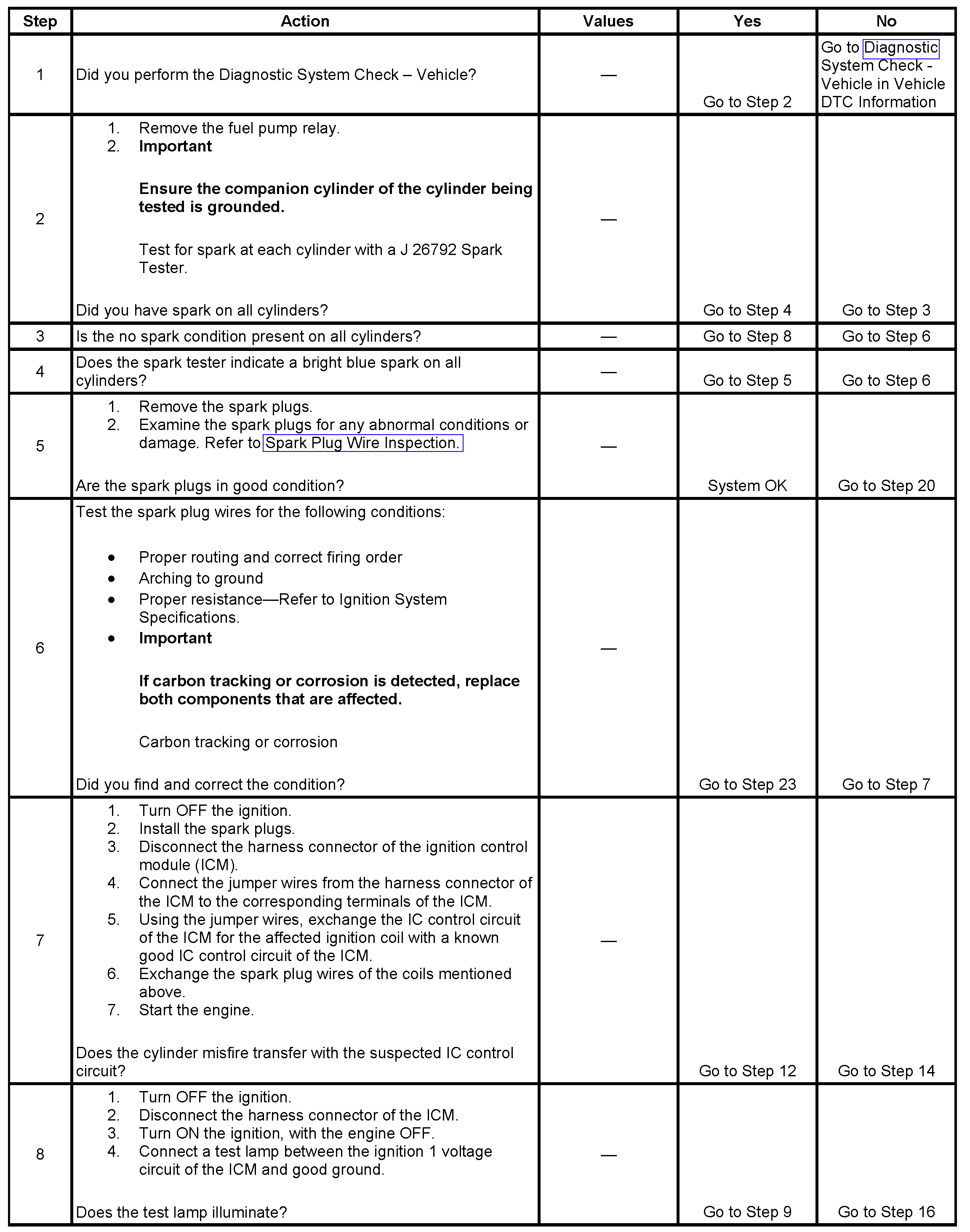

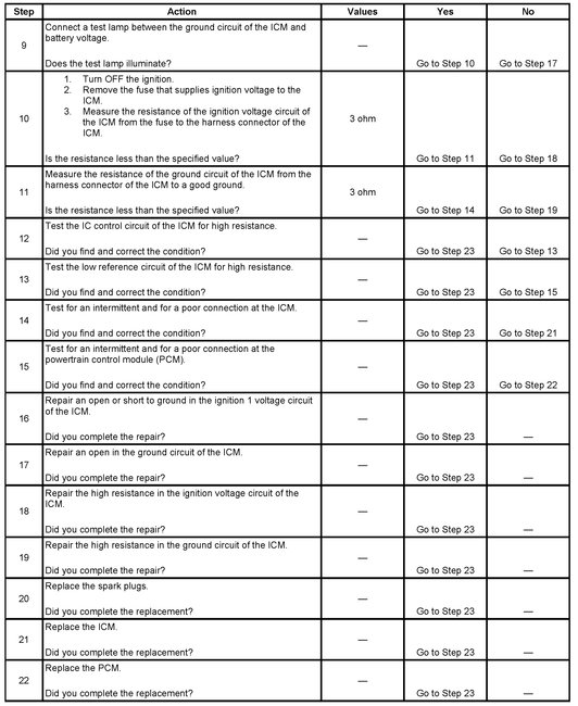

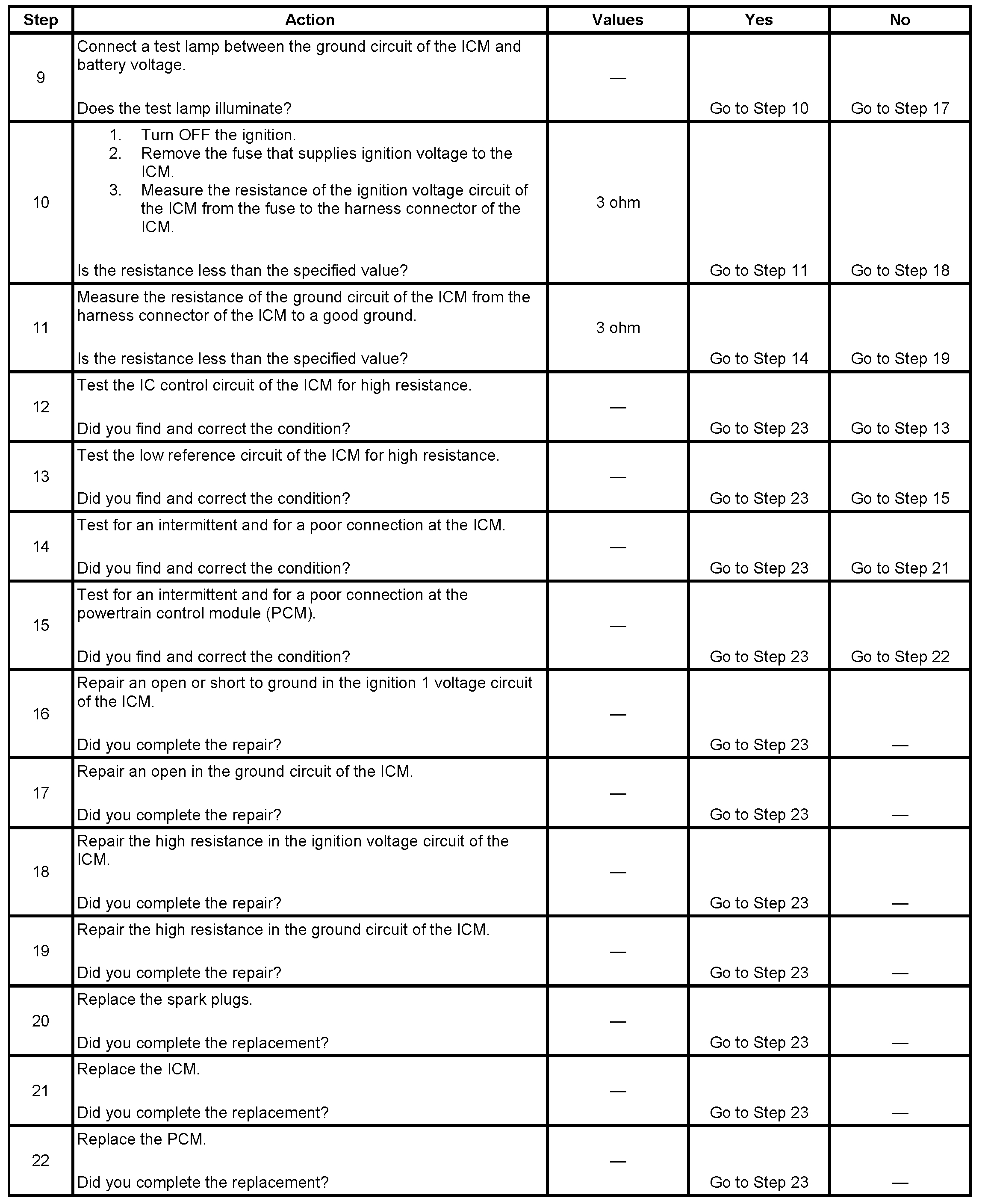

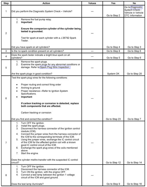

Here are the directions for testing the ignition system. The attached pics correlate with the directions.
_________________________________________
2005 Chevy Truck Equinox AWD V6-3.4L VIN F
Electronic Ignition (EI) System Diagnosis
Vehicle Powertrain Management Ignition System Testing and Inspection Component Tests and General Diagnostics Electronic Ignition (EI) System Diagnosis
ELECTRONIC IGNITION (EI) SYSTEM DIAGNOSIS
CIRCUIT DESCRIPTION
There are 3 dual-tower ignition coils that are part of the ignition control module (ICM). The ICM contains coil driver circuits that command the coils to operate. The ICM has the following circuits:
- An ignition voltage circuit
- A ground
- An IC 1 control circuit for the 1-4 ignition coil
- An IC 2 control circuit for the 2-5 ignition coil
- An IC 3 control circuit for the 3-6 ignition coil
- A low reference circuit
The powertrain control module (PCM) controls each dual-tower ignition coil by transmitting timing pulses on the IC control circuit to the ICM for the proper coil to enable a spark event.
TEST
Steps 1-8
see pic 1
Steps 9-22
see pic 2

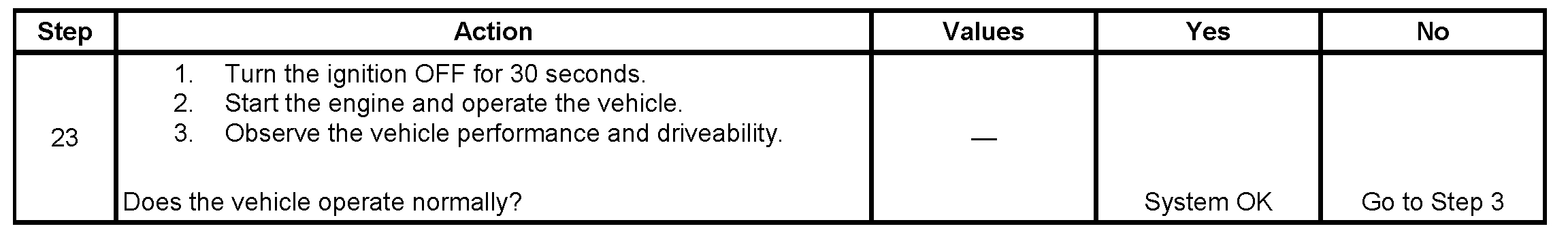

Step 23
see pic 3
