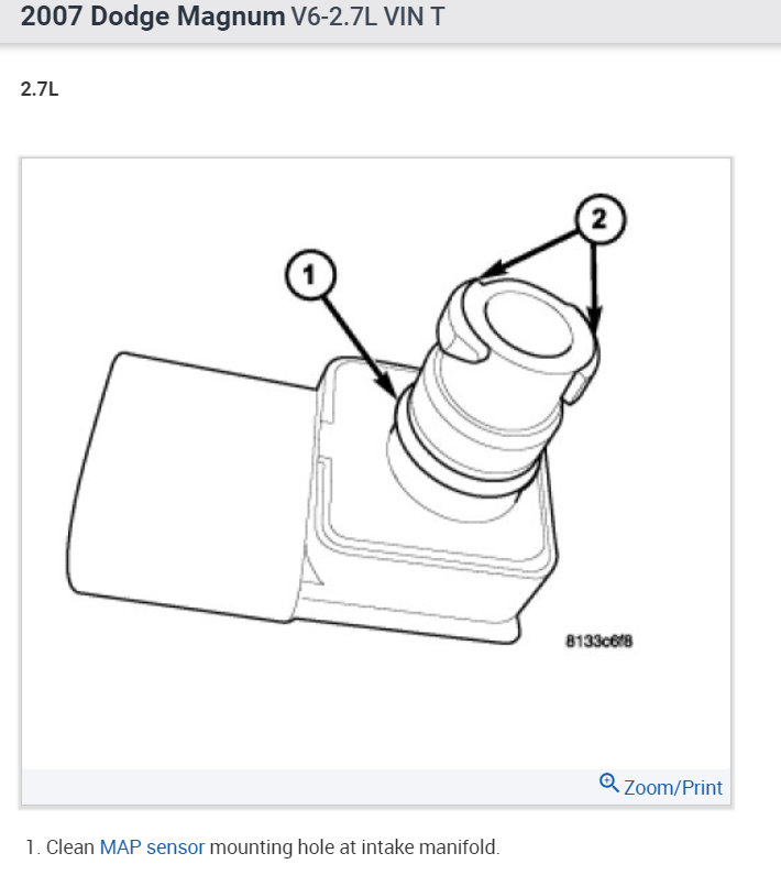

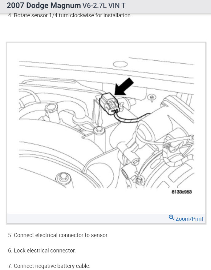

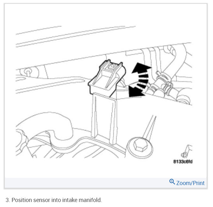

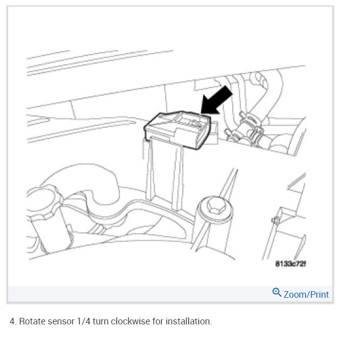

Hey guys, it is Magnum 2007 2.7, back to my check engine light problem. It is still there let's see where did we leave off I believe it was codes p0175 and p0172 well that is where we are at. Took it to my local Pep Boys and wanted to get it diagnostic check there after them having it for twelve hours they said they could not find nothing the matter with it. I honestly believe they did not even look at it.
Jul 23, 2018 at 12:32 PM
  • 55,781 POSTS
These fuel trim issue can be caused by a MAP sensor that needs to be replaced. The problem is when this sensor gets off a little it will affect the engine management without triggering a check engine light. here are diagrams to help you replace the sensor.
This guide can help as well.
https://www.2carpros.com/articles/repair-lean-mixture-codes-p0171-or-p0174-on-some-manufacturers
