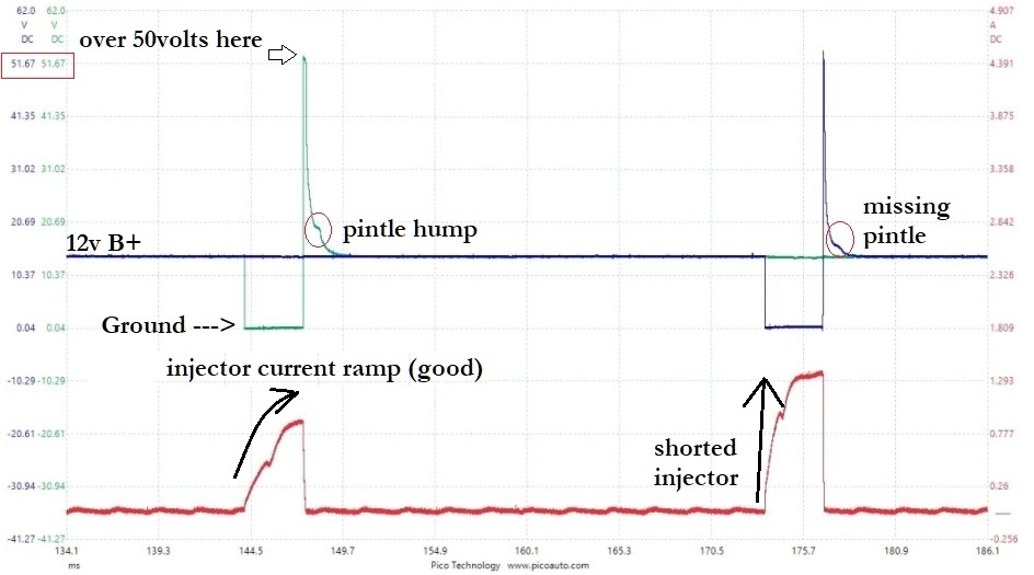

can i use a handhelded Oscilloscope to check the injectors pulse?
Jun 23, 2026 at 6:50 PM
AL514
  • 5,662 POSTS
Yes, but you will need an attenuator to bring the voltage level down, unless you have an automotive scope that is designed for higher voltage levels. The injectors will have an inductive voltage kick of usually 70-80volts, this you will see on the control wire. So using a 20:1 attenuator will protect the scope from these higher voltage levels when testing. I use an automotive Pico scope, which can handle up to 200volts +/-, so I dont need to use an attenuators unless checking ignition coils or I am not 100% sure what I am going to see on a circuit.
If you have a low current clamp, such as a 20Amp clamp, you can also look at the current waveform with a current clamp. This can show you a shorted injector, as well as the changes to the injectors pattern when cold or hot. It can also show you the pintle hump of the injector actually opening. Although I have seen a good pintle hump on bad injectors too, never know what you may see or find in this field. But the current waveform will tell you a lot.Very helpful testing. I will post some shorted injector waveforms for you so you know what youre looking for.
Jun 24, 2026 at 2:03 PM

here is an example of an injectors voltage and current waveforms. The Red trace shows a nice current ramp on the first injector firing, and a shorted injector coil on the second. That, along with the pintle hump are what you want to compare to some other cylinders, to get a known good waveform on that vehicle if possible. Just be aware of your scopes limits, they are too valuable to burn out. What brand scope are you using? I have a 2 chan handheld as well, good for quick checks.
Jun 24, 2026 at 2:26 PM

What did your scope test show? I cant recommend replacing parts if we dont know they are really the issue, you can try anything, but Id rather test and know thats the fault. You have a scope, so youre already ahead. Using a current clamp along with the voltage waveform together can reveal the entire fault that you can see. I would do a couple things first, move the #3 to the #2, if that cylinder is still setting a misfire code and if youre still seeing the intentional shutdown, then you really need to see what that current ramp looks like. You have swapped a few things around, #1 inj in the #3 place. etc. with no apparent change, moving the #3 one more time from a cylinder thats not coding right now.
Have you checked the control wire with the ECM and injector unplugged? No shorts to ground, shorts to power, high resistance between the ECM and injector plug
