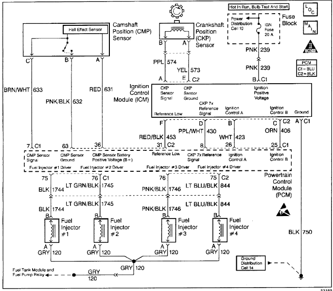

New battery, ECM, plugs, wires, coils, fuel injectors.
all idiot lights on, no working tachometer, or temperature. fuel gauge works and speedometer. and of course, check engine light is on.

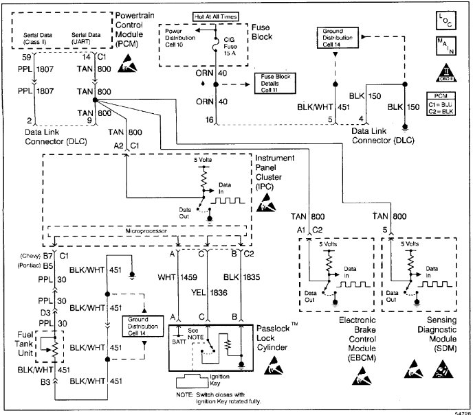

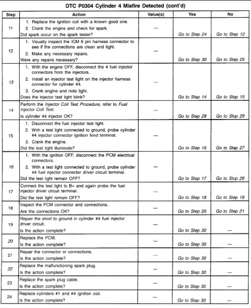

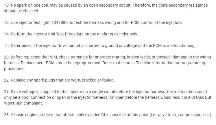

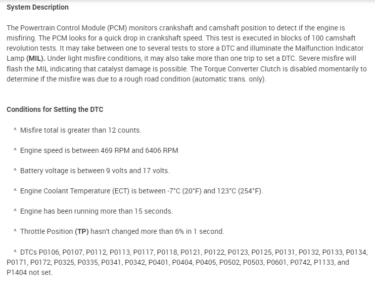

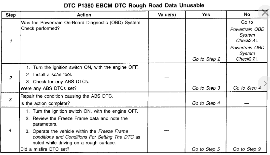

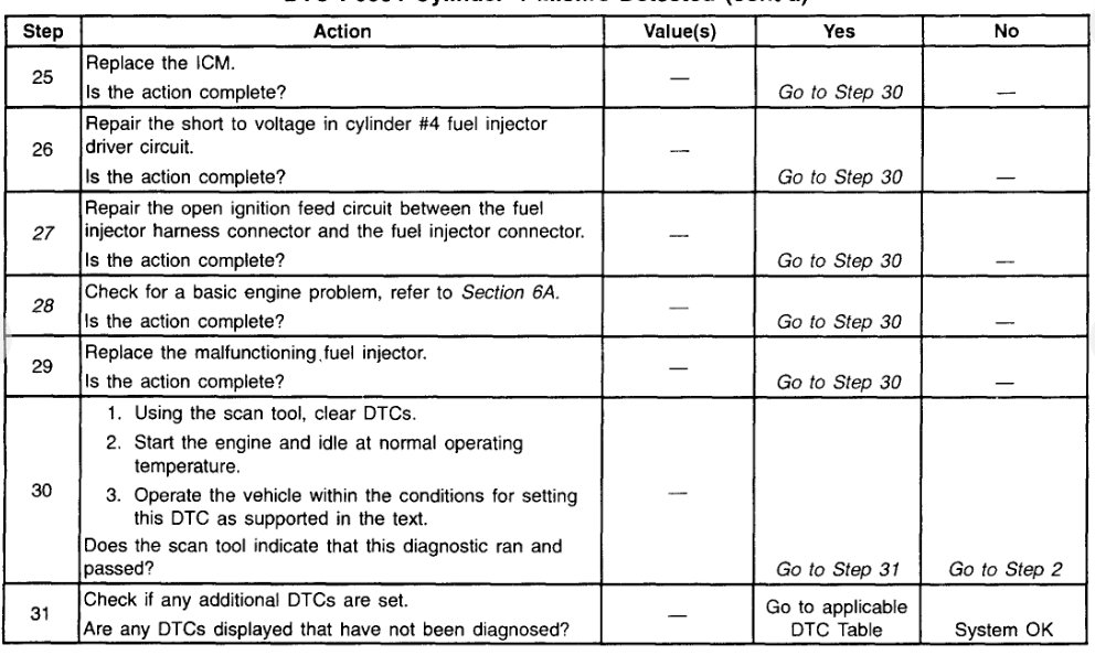

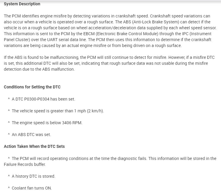

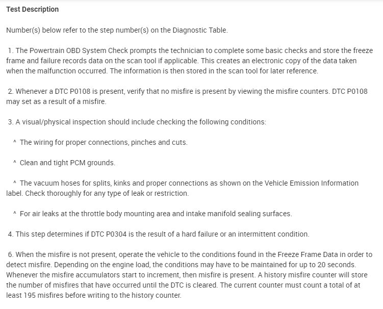

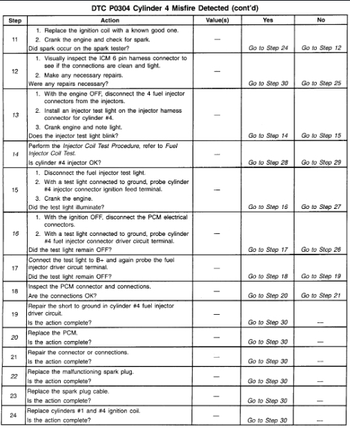

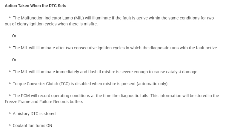

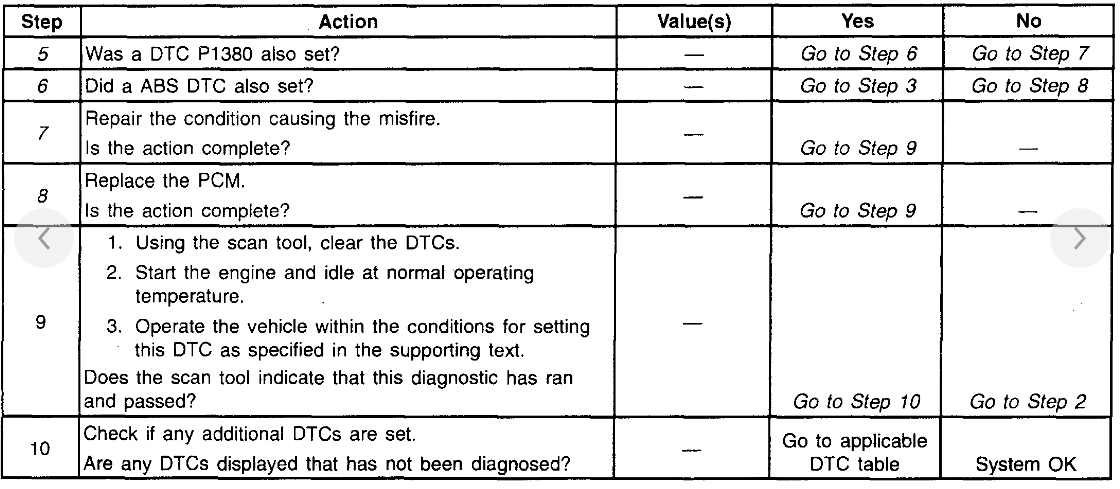

thanks for such a quick response. P1380 and P0304 are the codes i am getting.
Sep 21, 2019 at 1:57 AM
TRUCKINSEIBERT
need to add, my scan tool shows 4 faults, in this order, p1380, p0304, p1380, p0304.
Sep 21, 2019 at 2:00 AM
DANNY L
  • 5,648 POSTS
Hello again.

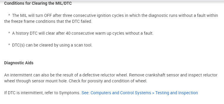

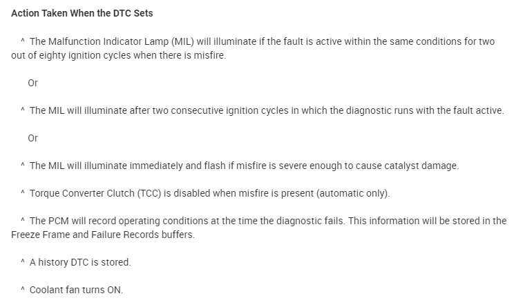

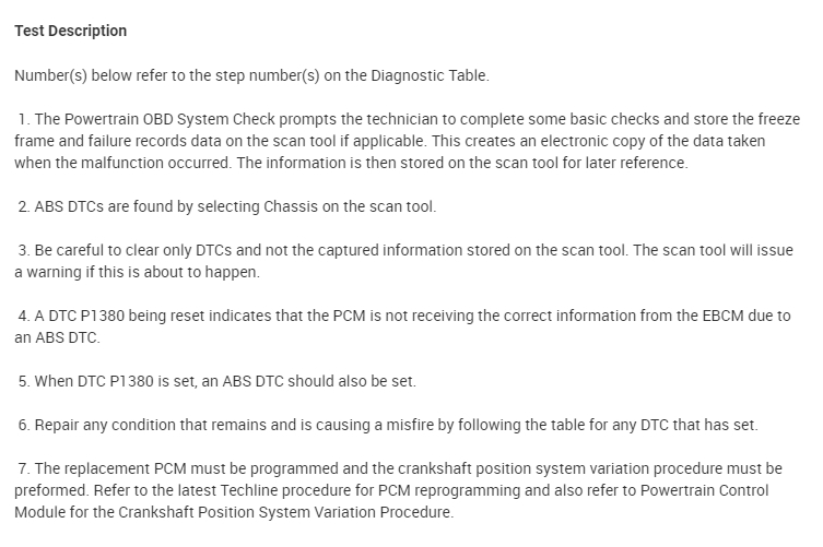

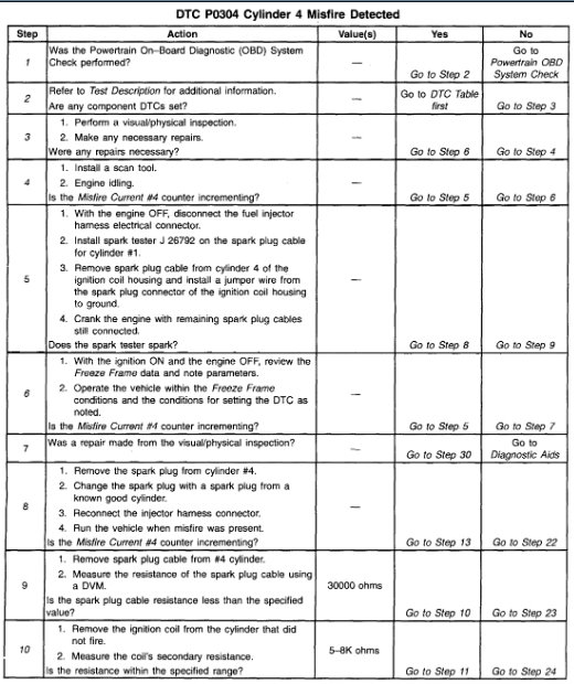

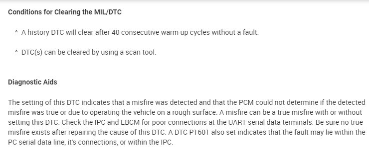

I've attached step-by-step diagnostic instructions below for both of your power-train codes.Hope this helps and thanks again for using 2CarPros..
