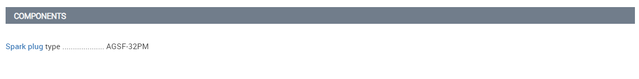

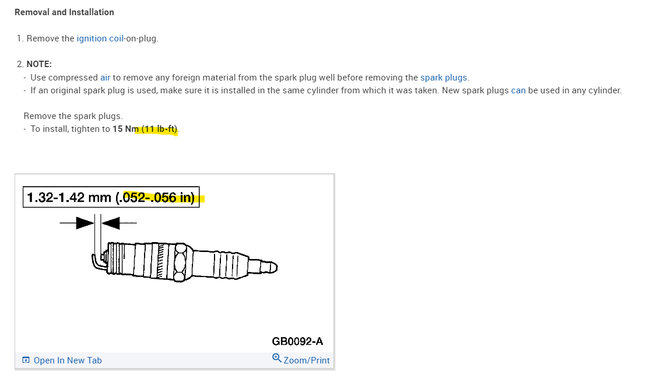

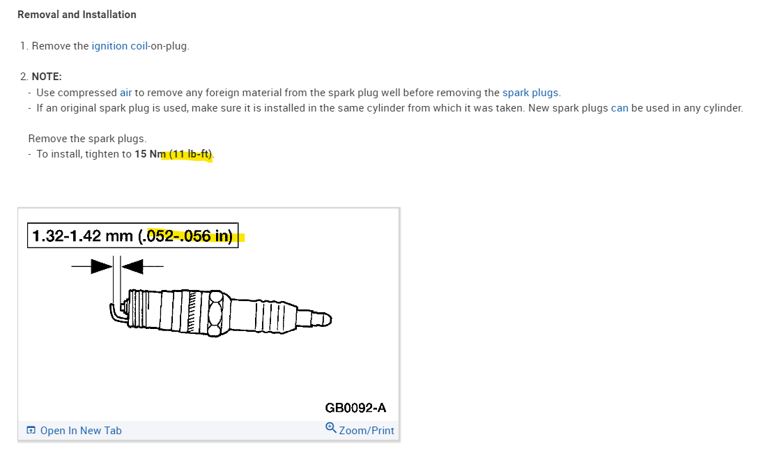

Also, what brand spark plugs did you recently install?
This is the OEM Ford Motorcraft spark plugs that should be installed. I highly recommend using the OEM on any Ford. especially with the amount of cheap aftermarket parts that are out, going bad constantly. Sometimes right out of the box.
