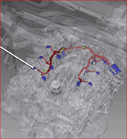

The codes you supplied are showing as cylinder number one misfire (P0301 and P0300). You should look into having the cylinder number one ignition coil (mounted on top of cylinder number one spark plug) and ignition coil electrical connector tested to see what the cause of the misfire. As far as the other two codes(P0172 and P0132) shows as that cylinder bank and oxygen sensor is running rich due to the unburned fuel caused by the misfire. I would get fixed as soon as you can because unburned fuel from a misfire going through the exhaust system can ruin the oxygen sensors and catalytic converters. I have attached a tutorial for you to view about misfires.
I have also attached a picture of the cylinder number one location. Hope this helps and thanks for using 2CarPros.

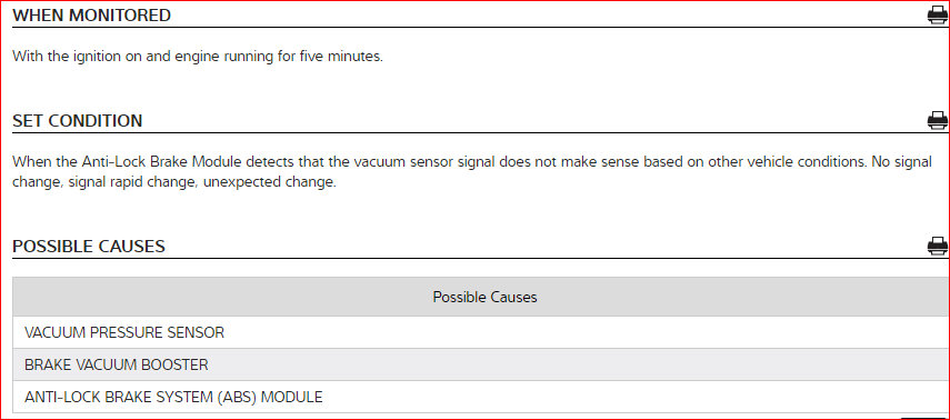

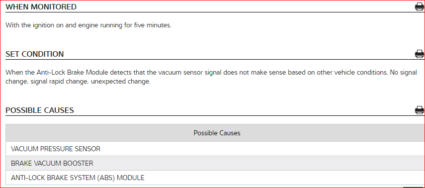

Hello again.
Yes, that is why code P0300 random/multiple misfire shows up. That is why it can be random.Have you checked the parameters?Your new code C1082-02 has to deal with a vacuum pressure sensor signal loss. Hope this helps and thanks for using 2CarPros.

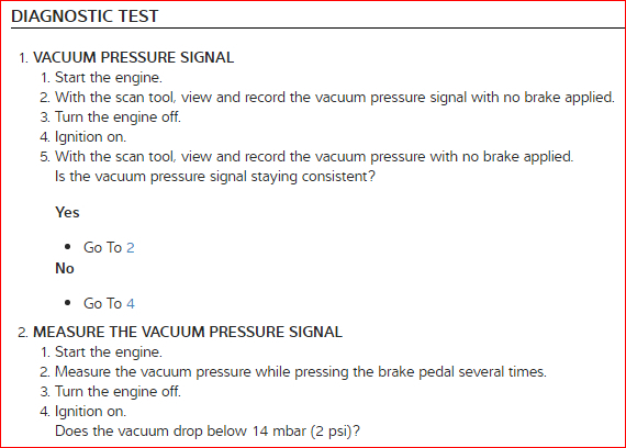

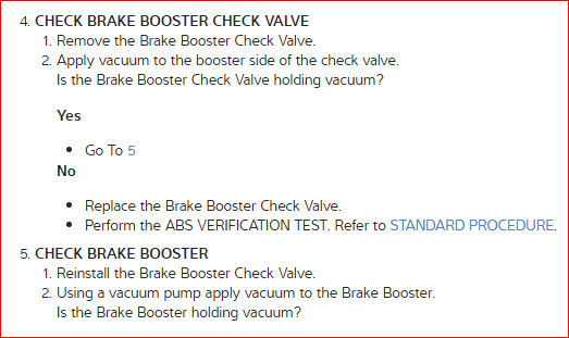

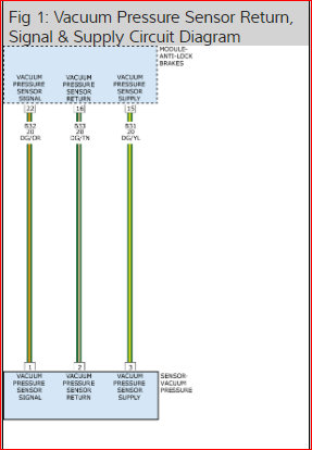

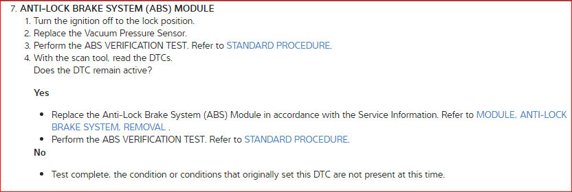

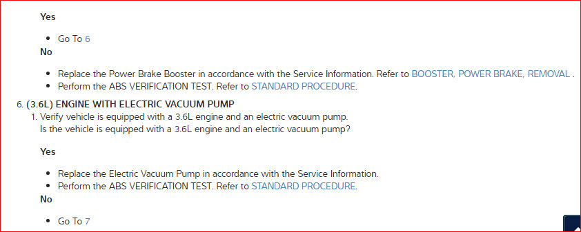

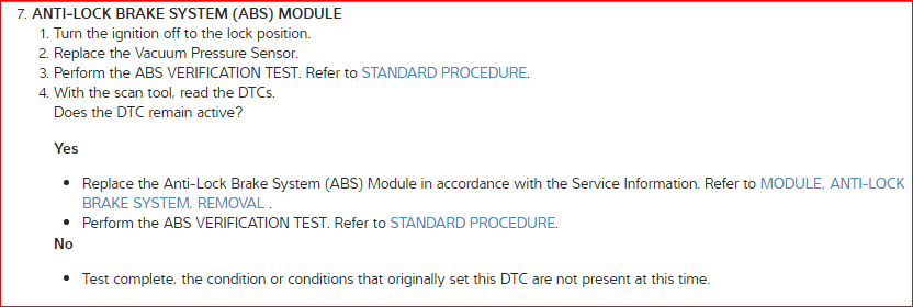

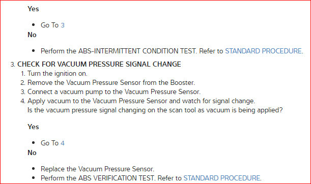

I've attached a few pictures for step-by-step testing procedures for your C1082 code "Vacuum Pressure Sensor" Here is a link for a tutorial showing how to test wiring:
Hope this helps and thanks again for using 2CarPros.
