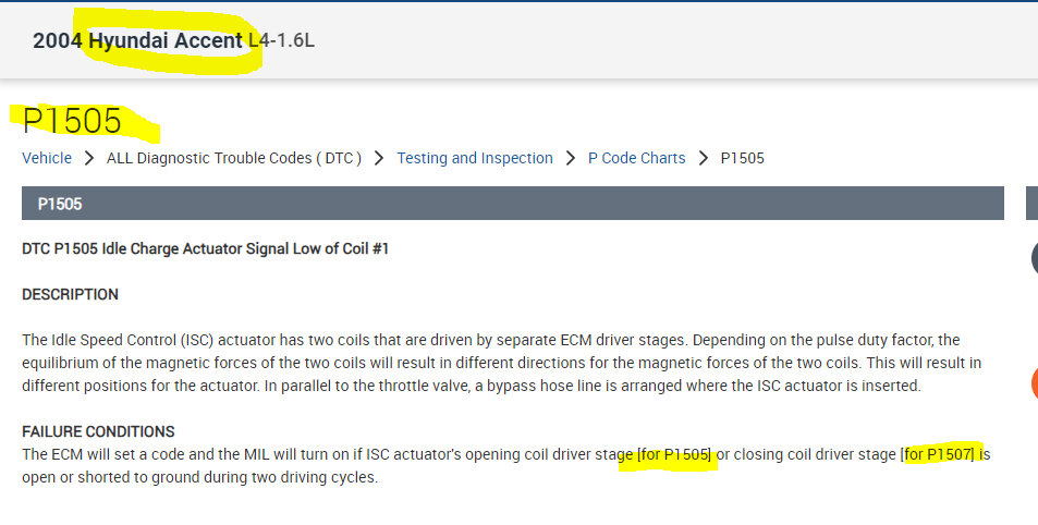

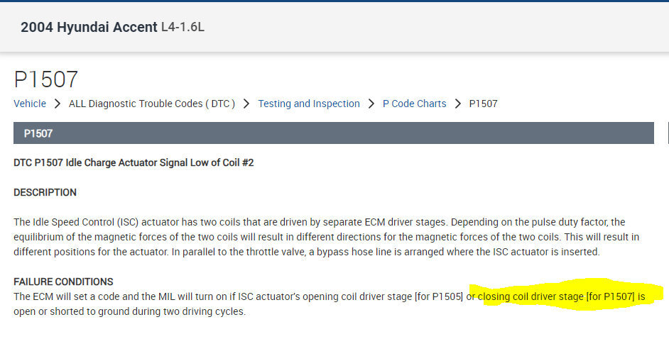

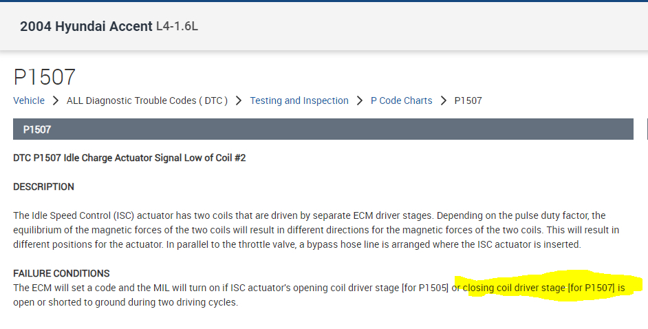

This model Hyundai isn't offered in the US, but I suspect the codes are the same with other 2004 Hyundai vehicles. So, I attached diagnostics for both codes below. The diagnostics came from a 2004 Hyundai Accent, which is offered in the US.
The codes are related to the idle air control circuit. I don't know if that is where you are seeing problems. Take a look at the diagnostics and let me know if they help.
I hope this helps. Let me know.

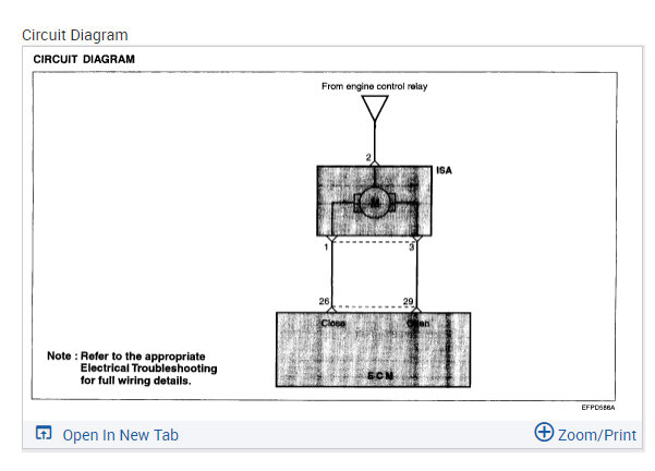

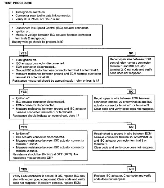

That indicates the coil driver has a short to either power or ground. The same diagnostics apply with this code as I attached above.
This appears to be an electrical issue, so make sure the wiring is in good condition and the connector is as well.
See pic below.
