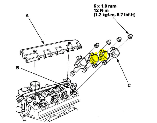

Back again. I have replaced the fuel injectors, spark plugs twice, and the ignition coils. Was starting fine for like 2 days after starting rough. It just magically started starting fine. I left work today and noticed it was back to starting rough. I drove it home and had no problems. When I parked it and let it idle, the whole engine was shaking. I have no check engine light but my obd2 says a cylinder two misfire. What could be causing that?

That is where I would start checking. First, remove the spark plug in cylinder two and see if it damages, is wet, or if there is anything odd about it. If it appears good, we need to check the coil for cylinder two.

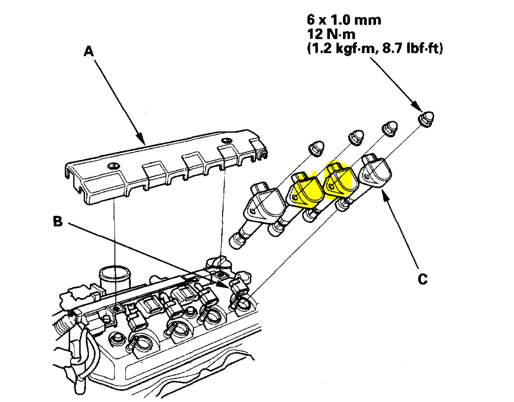

In this case, switch the number two coil pack with number three. See if the misfire moves to cylinder three. If it does, the coil pack is bad.
I attached a pic below showing the coils. Switch them to see if the miss changes cylinders.
Let me know what you find.
See pic below.

Spark plug looked good and I switched coil pack and code went away but it’s still starting really rough.

If the code went away, see if it returns on cylinder three.
As far as starting rough, do you mean it requires an extended crank time or does it simply run poorly when it first starts?
Interestingly, if it still starts rough (running poorly) and the misfire returns on cylinder two, suspect an issue with the fuel injector. If it does move to cylinder three, replace the coil pack.
Let me know. Also, let me know the specifics about the rough start.
