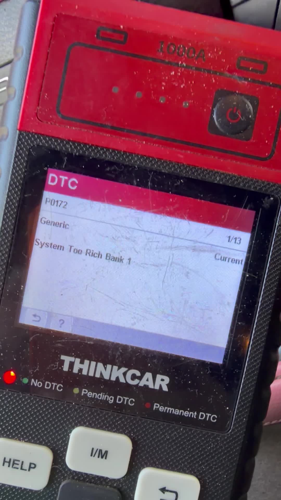

The car has had new ignition coils , spark plugs , injectors , but the problem still consist of cylinder #2 misfiring I can unplug the coil while car is running nothing changes I swapped with known good coil and runs perfectly for about 3 minutes and immediately starts misfiring again so I moved another good coil runs perfectly for about 3 min same thing and when you first start it in mornings it runs a perfect till it gets close to temp but it cuts power to coil all together I’m lost only thing I can think is pcm has a internal failure. I’ve pulled it off and put the pcm in freezer for about 5 hours put it on car and ran perfectly for about an hour and back to the same misfire

Here are a few ideas Did you try a brand new spark plug and is it tight in that cylinder ? Could also be the ground
/ signal wires for that coil
Check at the coil and the ecu too just to make sure good luck hope this helps

If you che the few things i mentioned and you dont see anything there then check the fuel injector for the cylinder ..it could be failing ..since youre getting a code that saying its to rich could be dumping fuel or starving it of fuel after a few mins it start to fail just cant stay in sync somtimes ..only priblem is the codes aren't specified and I cant make out the video...so maybe erase the codes amd see wich ones return that way youl get a better idea . good luck
