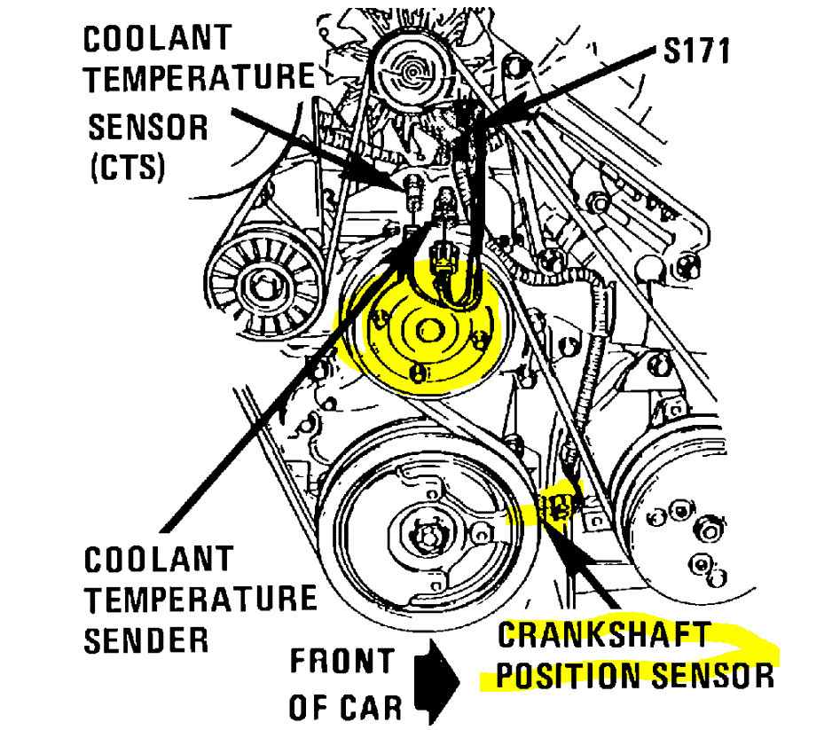

The mechanic checked all the vacuum hoses. Last year I smelled antifreeze when driving it and had to top off the antifreeze through the overflow jug. So, now cold weather is setting in and most mornings it's below freezing around 26 degrees right now. I drove it last week to several doctor appts and shopping over the weekend. Hubby poured 1/2 gallon of 50-50 mixed antifreeze into the overflow jug and it sucked it down. Hubby replaced the heater core last summer thinking that might be the problem. It doesn't leak any antifreeze when it's sitting, or leave a puddle under the car after I've driven it and park it. It wont leak down on the ground while it's sitting in the driveway running. however, I believe this antifreeze dripping onto electrical components is adding to my problem. Today I had a dentist appt and drove with heat on to my early morning appt, when I pulled into the driveway at home coming downhill, the car shut off and didn't start back up as usual. I put it in neutral and without the power steering working working, I muscled it into my my parking space and it cranked back up, but before I pulled it in my parking space, it wouldn't crank back up like it always has. Hubby says the antifreeze leak could be coming from the freeze plug, or any other place except heater core. The car will get up to 90 or raster on interstate and run without hesitation. It has power. A rebuilt transmission that's only 3 years old, and I really like my old car and being payment free, and not having to pay collision insurance. Hubby done all the mechanics manual for the Oldsmobile has told him to do, he laid on his back in my gravel driveway working on my car that needs professional help on a lift do to an injury.

Based on what you described, if there is a leak from the water pump, it could leak down onto the crankshaft position sensor. The sensor is behind the crankshaft pulley, right below the water pump. See pic 1
Do me a favor. Check that area for evidence of a leak. Also, take a look through this link and let me know if the symptoms seem to mirror what you experience.
Also, here is a link you may find helpful when looking for the leak:
https://www.2carpros.com/articles/car-is-leaking-coolant
See pic below.
